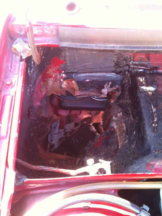

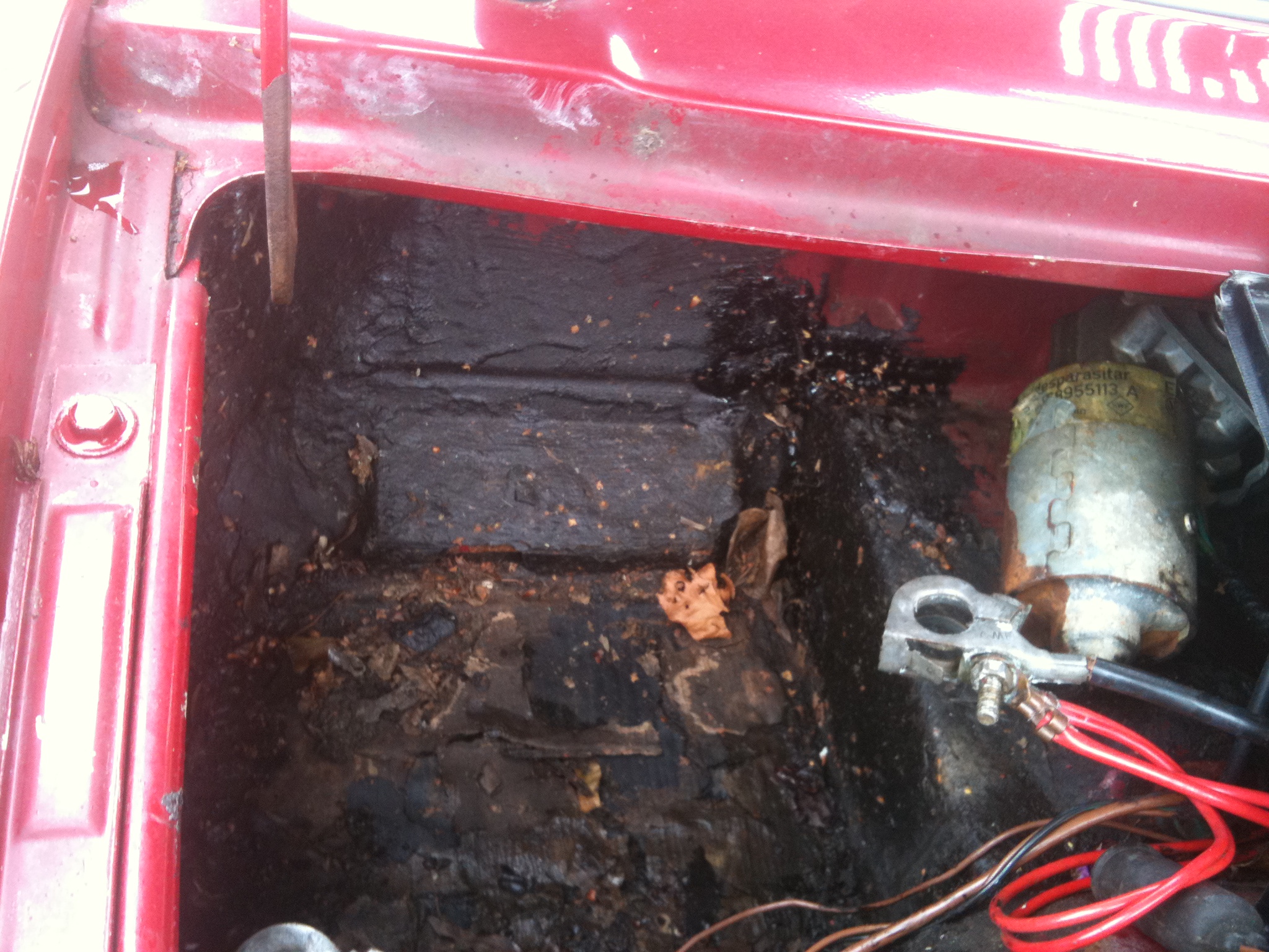

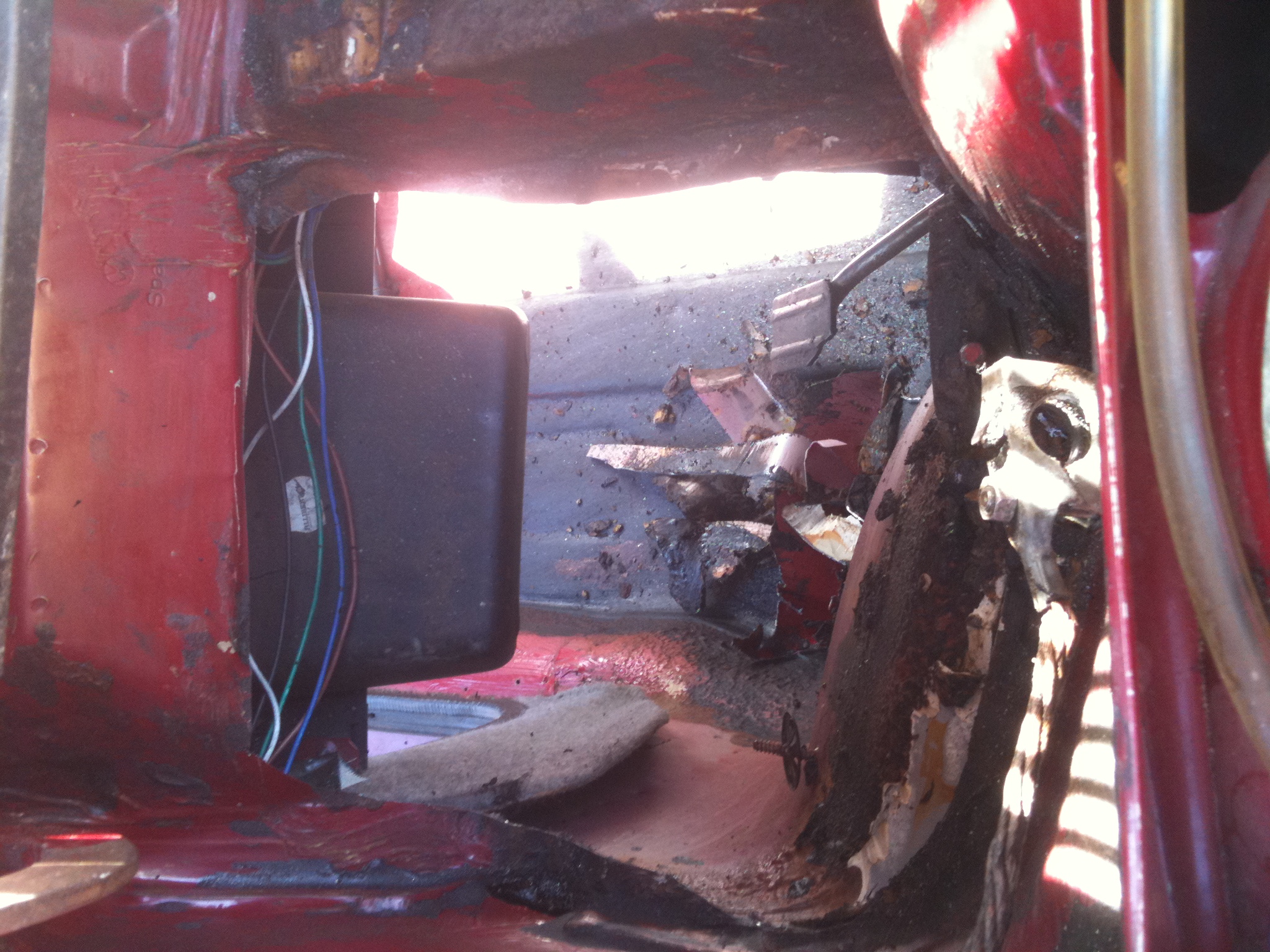

Works finally started, i was fed up of my polo having a hole in it, so it was time to fix the battery tray.
This is how it looked this morning, the pikey that had it before me bodged a repair with some almost bitchamen like paint which was a real bitch to get off
so i started to paint on some Interstrip AF which worked a treat, but it just took too long and my patience was wearing thin, so decided a hammer would do the job quicker
i then grabbed the air saw and within minutes, the battery tray was cut out and ready for welding tomorrow, i just need to wait for materials first.

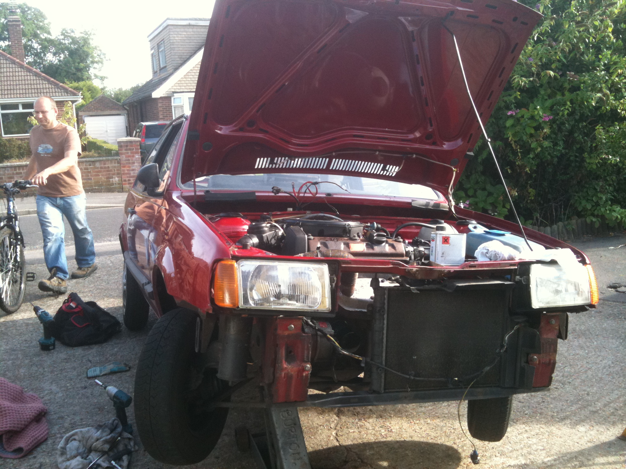

now that that was all done, there was still daylight and i still have a fair bit left to do before i can put in on the road so i decided not to waste anymore time and start stripping it ready for a lick of paint in the coming weeks.
i'm hoping to get the battery tray welded up and get the car completely stripped tomorrow. but now i've actually started i finally feel like i'm getting somewhere and one day... it will actually look like a decent car as opposed to a shed :D

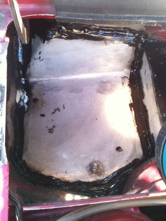

finally got my battery tray hole repaired today
started of making a card template, marked out the shape on to a bit of 2.2mm zinc coated steel ( this will never rust again, fingers crossed) cut it out and bent it roughly to shape.
then i welded it in but admittedly my welding skills are pretty poor so i only spot welded it and covered it in sealent in both the engine bay and the inside of the car. I also welded a bolt into the bottom to hold the battery in place, didn't really fancy doing all that work for it to fail MOT on a nonsecured battery.
gave it a coat of acid etch primer and a coat of stone chip and it's ready for paint.
it's finally starting to come together now, just looking forward to getting it sprayed and on the road.

What yuou have done with the battery tray is very impressive - are you super-confident, kamikaze or already have welding experience?
Also if you don't mind me asking why did you strip the front of the car? It looked in perfect condition in the first picture you sent...
anyways, nice work dude...
Alan
Thanks buddy, good to know my work doesn't look like a complete bodge then, I was worried about the streams of abuse I'd get for my poor worksmanship but that hasn't happened as yet so I'm happy with that.
I've done a level 2 apprenticeship in engineering so got a rough idea of what I'm doing but it was a bit of "close my eyes and hope for the best"
I've pm'd you about the front end, it's pretty simple.
Well as long as you've welded it up enough to not end up with a battery dropping onto your toes your alright :lol:
It's definitly strong enough to hold the battery, infact I think I could probably stand in it if the bonnet was off, and now water's ever gonna come through with the ammount of black gunge I used lol

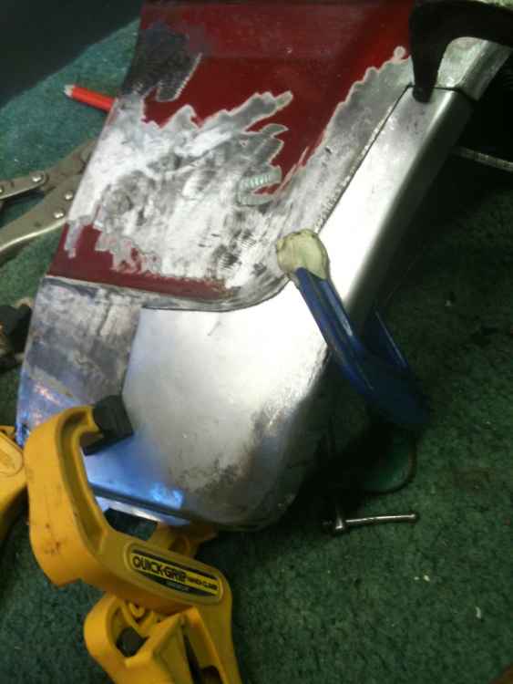

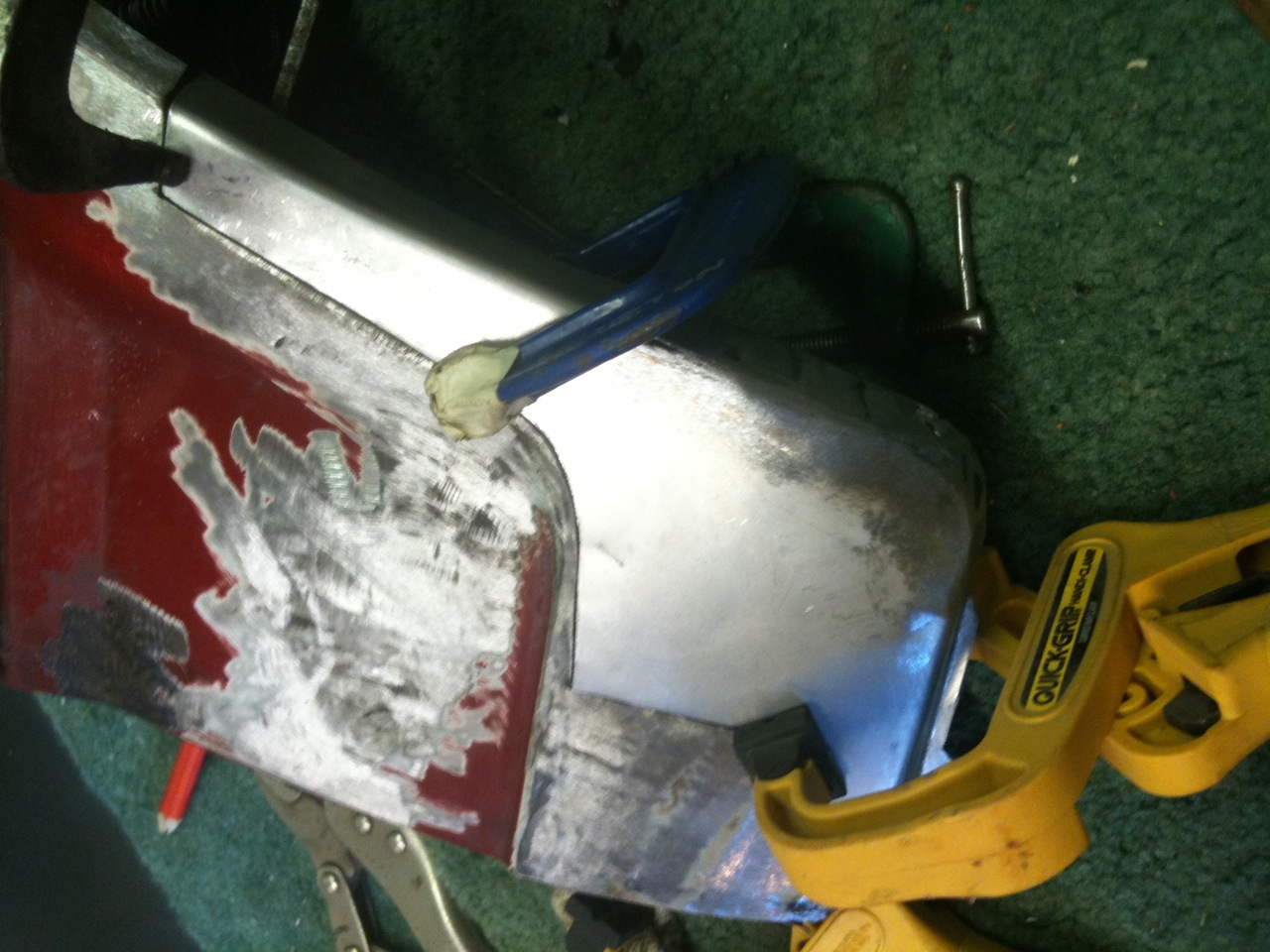

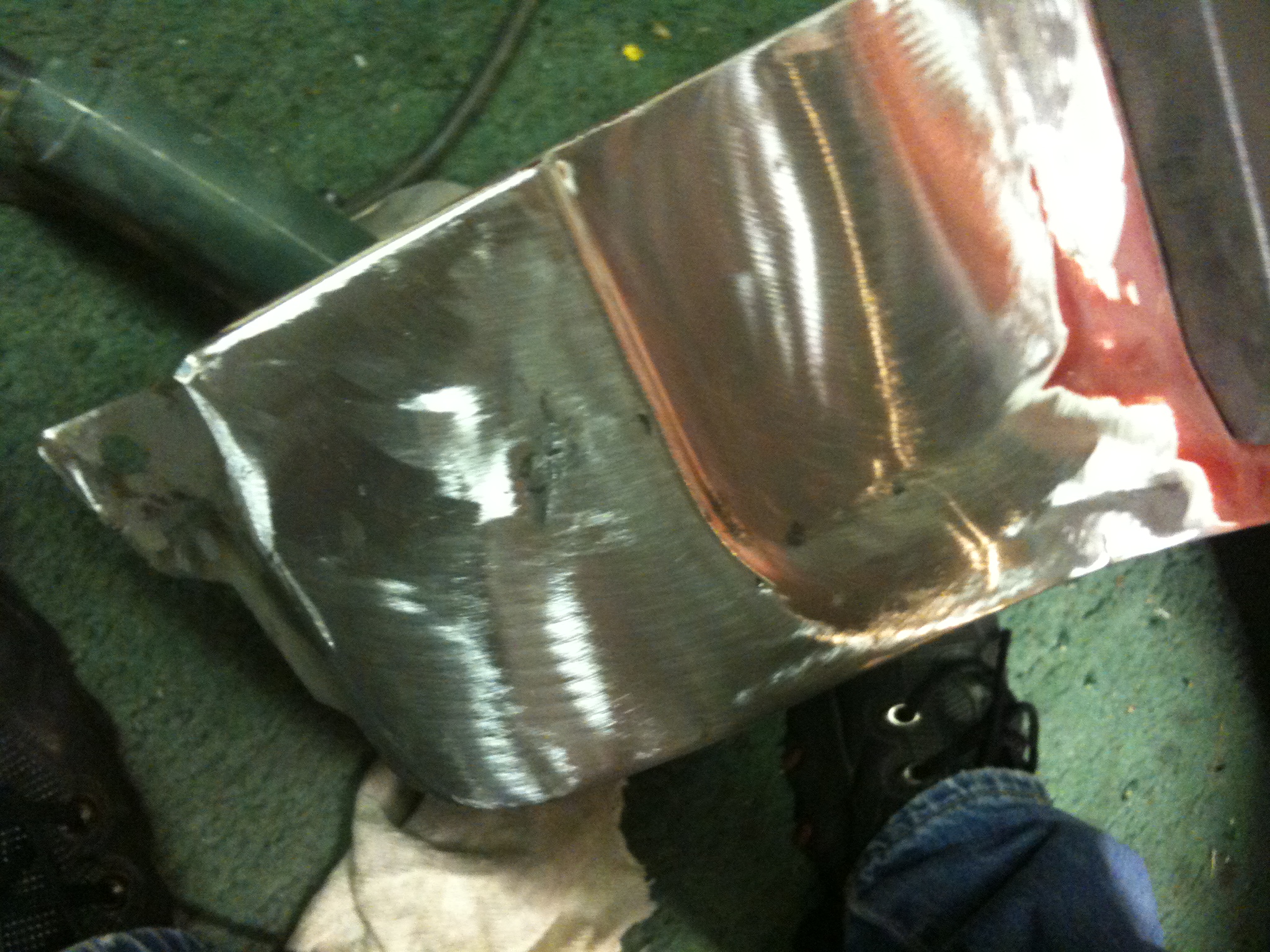

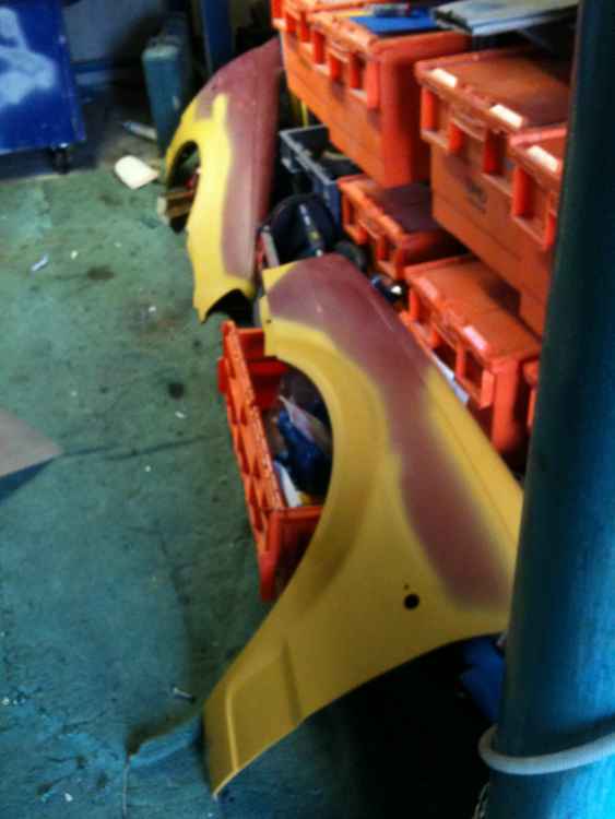

my wings were rather rusty and there was a real lack of solid metal in places so i had a look around to buy a set of new ones but the cheapest i could find a set was a secondhand pair for £40 plus p&p which i would rather went elsewhere on the car.
so whilst i was at college last week my dad got to work on fabricating a few new parts to weld onto the wing and cleaning down any surface rust, heres how it turned out.
any comments or feedback would be greatly appreciated, hoping to have it sprayed and on the road by the start of next month!!! :-D

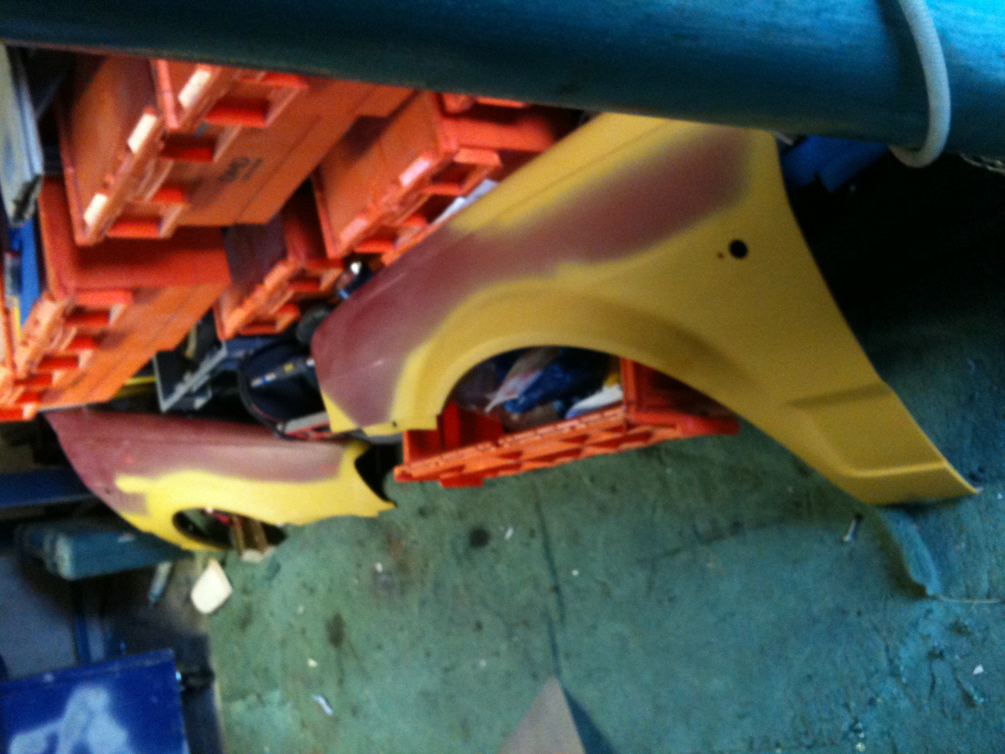

My provisional license finally came through today so I decided it's time to get my arse I gear and get the car finished, so I went and finished off my wings by welding over the ariel whole and tidying up the welded areas with a bit of filler primer. I then started to "key" the paint up so there was a better surface for the primer and paint to stick to when it gets a spray over

finally on a computer and have some free time so thought i'd chuck up a quick update to keep the thread alive.
like i said I've smoothed the near side wing so theres no ariel hole now and keyed up the paint work completely. Only problem is, at the moment I'm lacking both the time and facilities to get the paint done and finished so it's still sat on my drive in a rather sorry state :(, some one give me some re assurance that it will ever get done as it's really not looking that way right now :(
fair play on the fabricating
she'll get there eventually! Stick with it :thumbsup:
