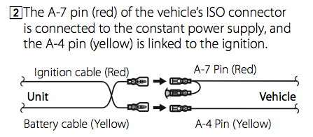

Oh and I just found this on one of the online user manuals, I take it this is what you mean.. (pictured)
Right, so i switched the red and yellow cables round, luckily the already had bullet connectors so i literally pulled them apart, swapped them and plugged them in.. But still no luck, I plugged my ipod into the left and right audio out (to my sub) and using the yellow 12v cable off the adapter to the remote for the sub, and the sub and everything works fine! So unless I'm still doing something wrong, I don't think it's the cable..

I dunno if this makes a difference but it's what I did yesterday and had no problems. the Yellow and red when I switched them over I switched them at the connector end rather than half way along the wire so the yellow wire is all yellow and red is all red. It's easy to do, u just need a really thin screwdriver to press in the sticky out bit of the pin that holds it in place on the connector, unplug them and swap them and remember to switch your yellow/red wires back in the middle if you are gonna try this. Hope it helps.
