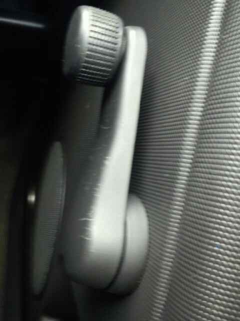

What the cards come over the winder? This is what they look like - post-38280-1285523617.jpg

Get your fingers behind the winder near where in joins and pull outward and up, may need some force.
Just went out to my car and did this for you.
Hope this helps.
Pete
That is a big help thanks. So you just rip it off. I'll have a do tomorrow. Was just scared of breaking something. Did you use a screwdriver or bare hands?
Yeah, just give it a pull, its pretty flexible so hard to break.
You may need a screwdriver if your not hardcore enough :lol:
Let us know how you get on.
Pete.

Yes got them off . Thanks for everyones help. I'm a mong I know
