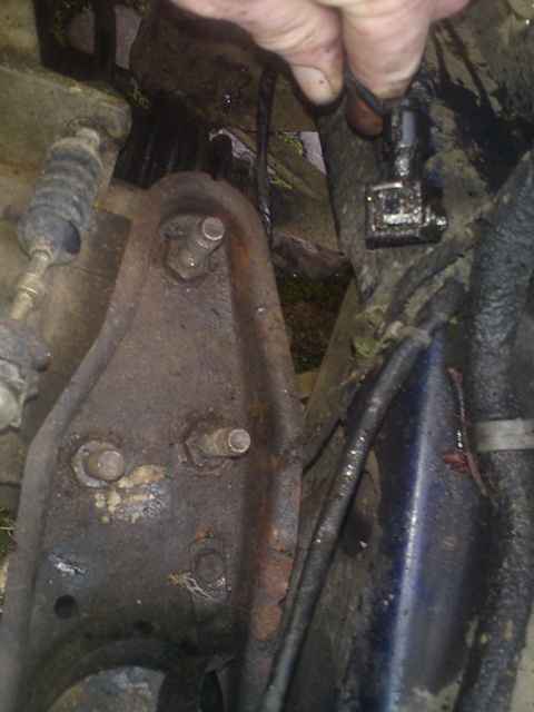

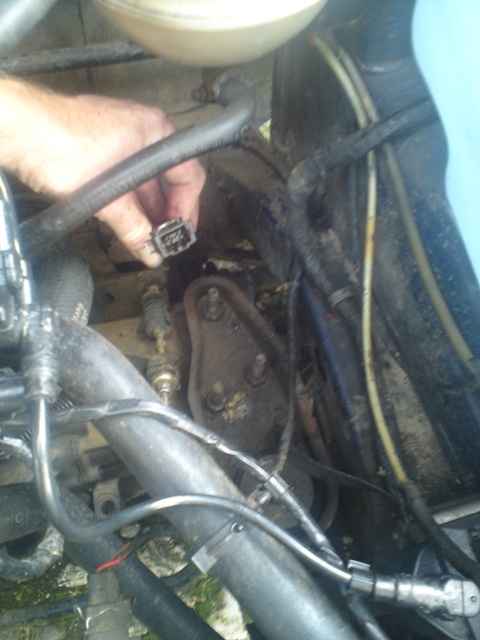

Who likes a challenge?! Can you identify this connector....
Can you identify this connector floating around under my bonnet?!
Picture quality isn't the best but hopefully you can make out enough to see what's going on. I've got my theories but I'll let you guys have a guess before I let on!! ;)
It's a challenge!!
Kevin.

gearbox reverse light switch
haha beaten to it!! seconded...gearbox reverse light switch- on front of gearbox lower down... 8-)
also what I thought when I looked at the picture (that it's the reverse light switch connector).
OK, that makes sense. Will check to see if reverse light comes on.

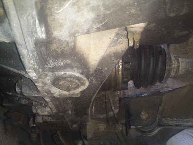

I found this connector on the bottom of the gear box, but that plug wouldn't fit it I don't think? Should it have another fitting on it to take the loose plug?!
Yes, take socket from first pic and place it on said plug. check if reverse light works. Simples
Not sure that plug will fit on those pics though??!! The plug looks like it take pins that are turned through 90 degrees in comparison to the ones that are on the gear box. Looks like it need some sort of adaptor?!
Looks like the gearbox has been changed for an earlier one at some point,as that's an earlier switch.
I'm sure you can swap the switch for a later one,but you'll have to be bloody quick with a tray under it or empty the gear oil out first..
you've got the switch from a mk2 and the connector from a mk3. Has the car had a gearbox swap at some point?

Good thinking!! I guess it must have had a gear box change then. Car is new to me. Gears seem fine and the clutch pedal is v low so maybe someone did both at same time for some reason?!
Thanks for the help guys, and well done!! :)
