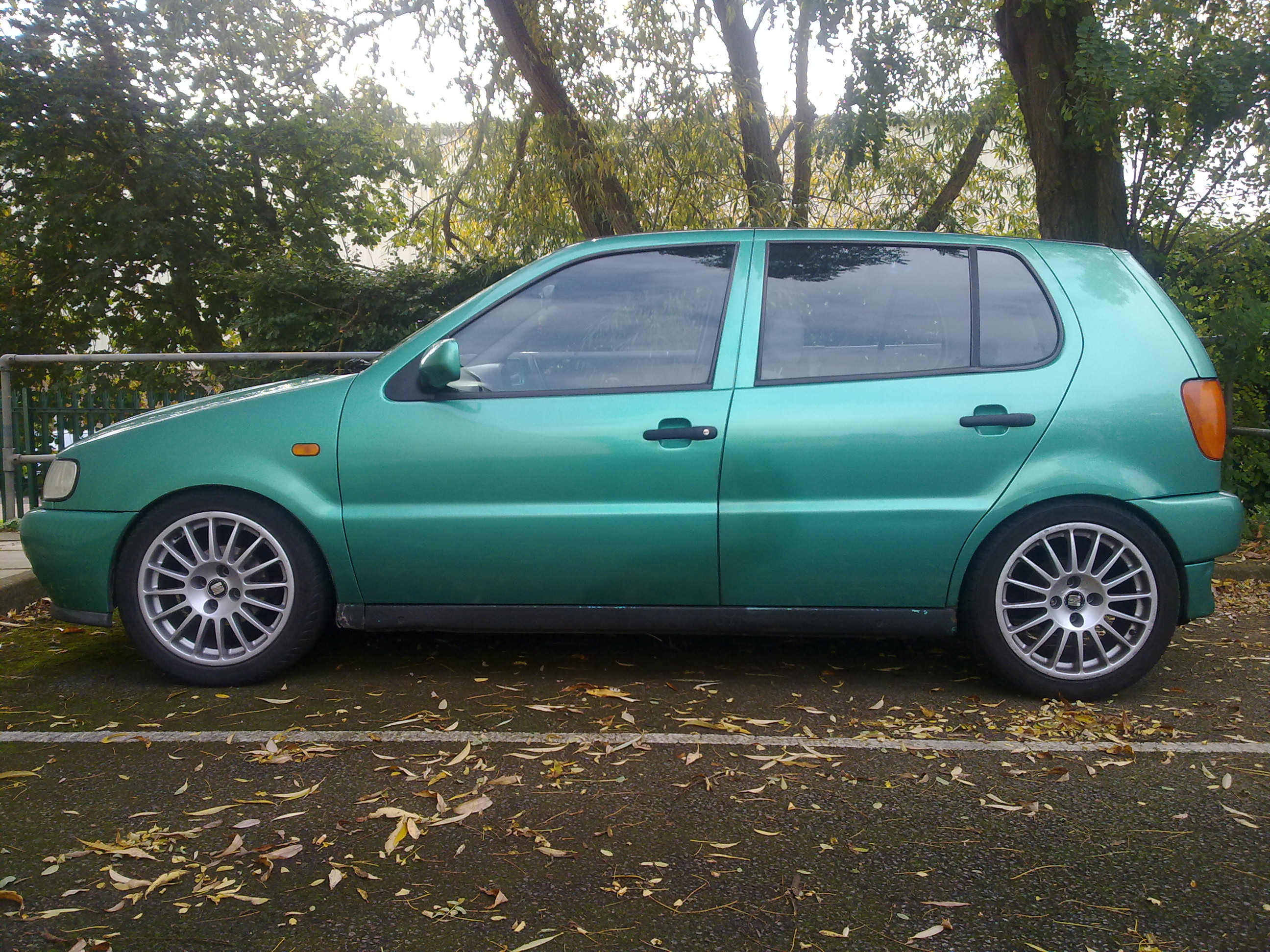

Just got some 16's as they were going for cheap and all my old tyres were buggered so thought 'hey why not?', i now know why not :(
16's + Polo = PoHI
So i had to raise my car by about 30mm!! I haven't got any money to get another set of wheels at the moment so i think arch rolling is my only way to go until I've saved some more pennies!

Yeah just a bit big really! They do look good but definately missin the drop! I'm sure with a bit of bodgery ill get it a bit lower again! Offset and width fit perfectly as well! bout 5mm from tyre wall to collies and tyres *just* inside arch!!

They certainly fill the arches:
