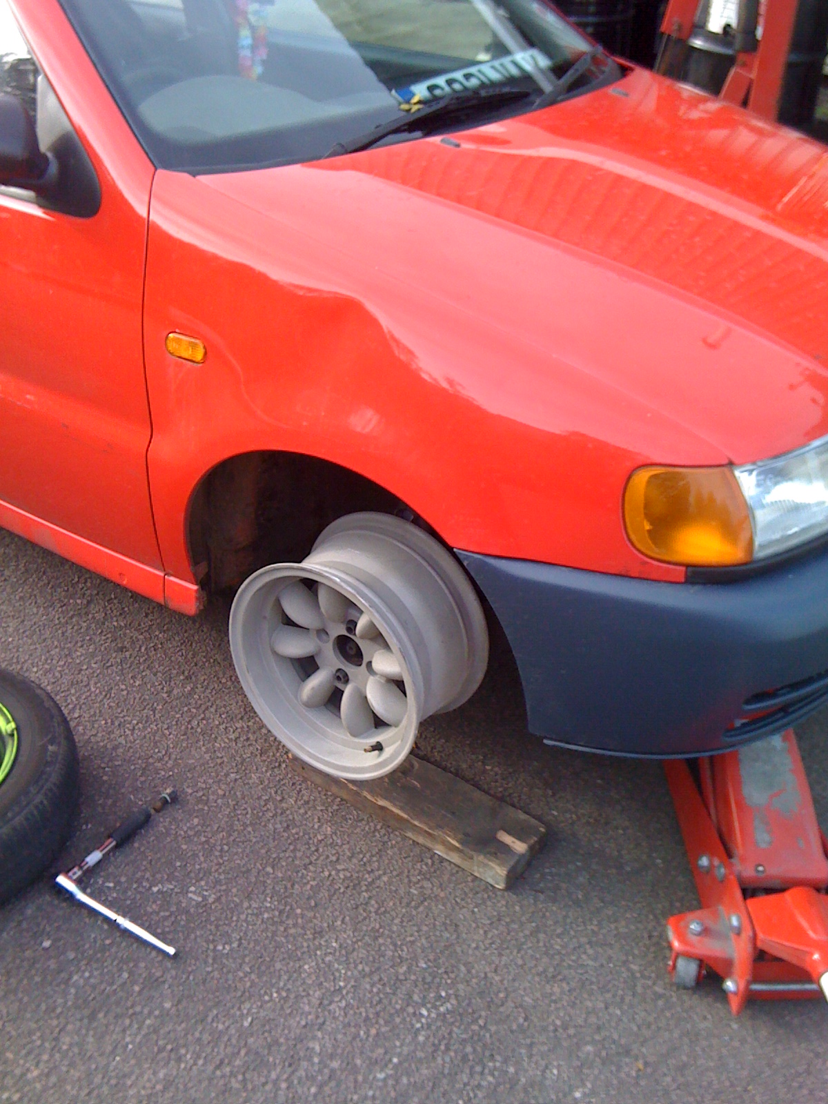

hi I've jst bought some 13x8 minilites what will i need to get them on my car. also whats thebest tyre to go for cause there seriously wide and will need tyre strech

dude if your after stretch go fos somthing like a 195 50 13 they should look sick
might be hard to find tho
they will be fine once the car is back on its wheels

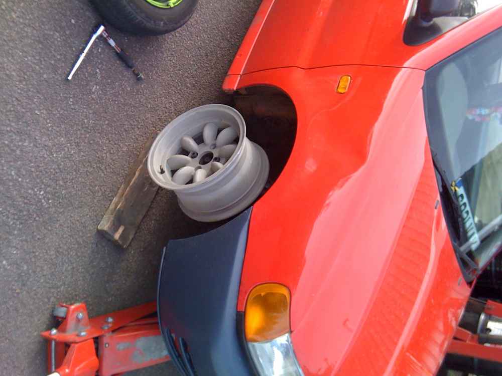

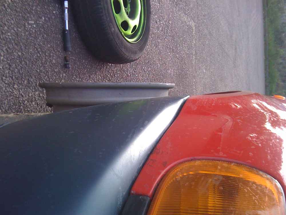

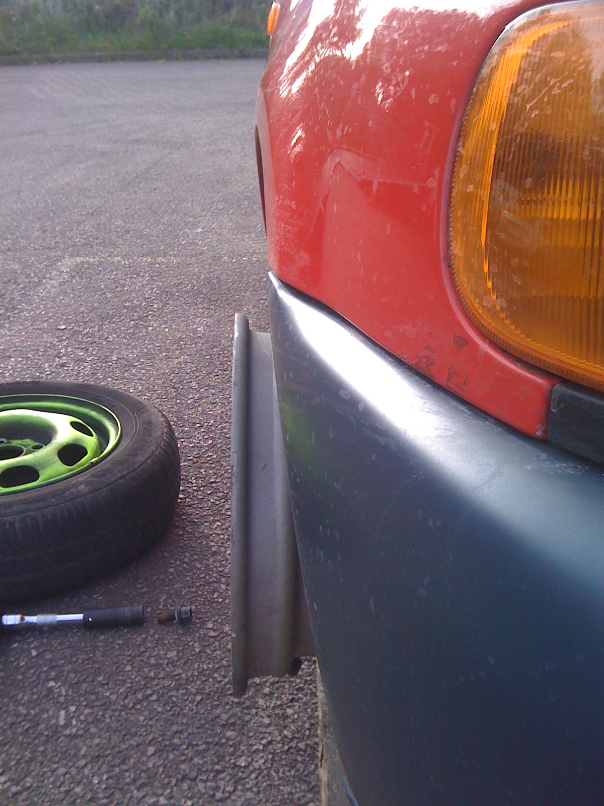

no they wont, they have a seriously low offset like - 3 or something, you will need some pretty hefty stretch and the feds wont like them too much depending what they are like in your area :L
they look proper ruuuude.
But as said, that offet is mega low and 8j wide is madness.
you'll need to flare your arches beacuse wheels need to be within the arches to be legal!
yyeaa my rear aches are gettinng rolled atm then need get some new wings then get them flared just think tyres will be hard to find and trying to strech them :doubt:
Get some different wheels? So far the offset is massively wrong, they are to wide and they are to small for the size of the car.

Am I right in thinking that minilites are a 4x108 pcd??
I have read shed loads of different threads to find out if these will fit a 6n as its a 4x100pcd??
Will wobble bolts do the trick??? If so where can I get some??
or is it a def no go??
ha ha jst been doing some more reading, no chance!!

Minilites are 4x101... being mini PCD.... but to be honest minilites are sold in loads of different formats. Wobble bolts will certainly not do 4x108 to fit on a 4x100...wobble bolts are used for 2mm difference. so 4x98 up to 4x102 for VW PCD.
As for the width of the tyre.. and legal issues.. only the tyre flat has to be under the arch.. the side wall and rim can stick out. I run 13x8 on my polo coupe and ther around 0ET... I'm running 175 50 up front and cant remember my rears of the top of my head... but can find out if you want.
