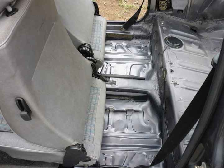

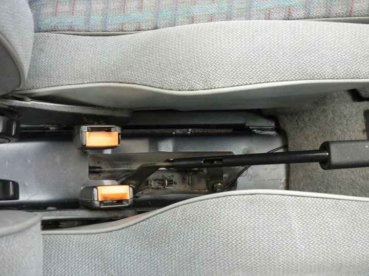

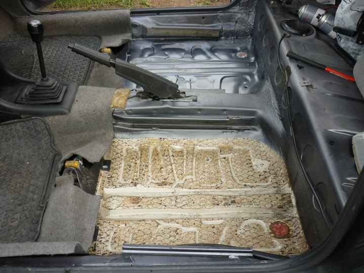

today i went out to grease the seat rails as they wernt sliding well ,so i took the seats out and it dint turn out like that :lol:
so i took the carpets out that sit under the seats to find the sound proffing stuck all cracked and loads of bits everywhere so 1 hairdryer and a flat head screw driver and i was away scraping it all out
one sides finished and ill get the rest done tommorow
suprisingly weighs quite abit for what it is
SAFEE!
Edited by 01mlacey
UPDATE!
today finished the other side of stripping the sound proofing from under both front seats
stripped
cleaned
sprayed
BOOOOM done!

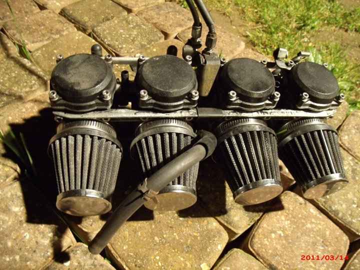

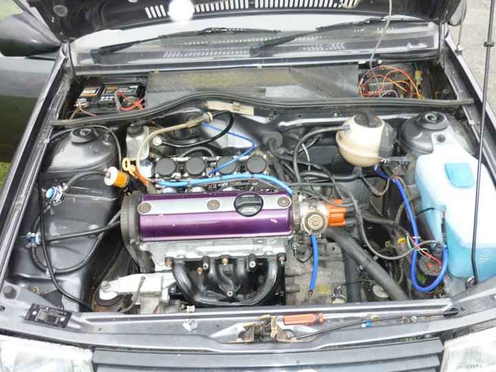

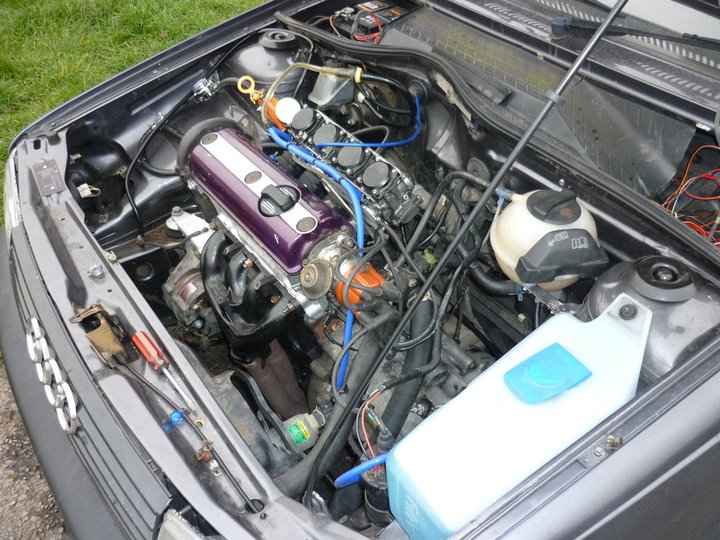

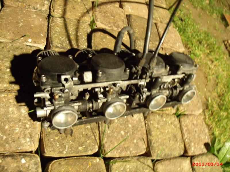

NEW CARBS!!!!
gsf 600 from susuki bandit i think ;)
not arrived yet but ill post a pic of 2 up anyway :)
cheers

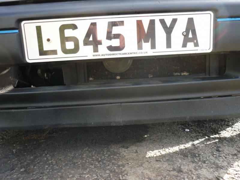

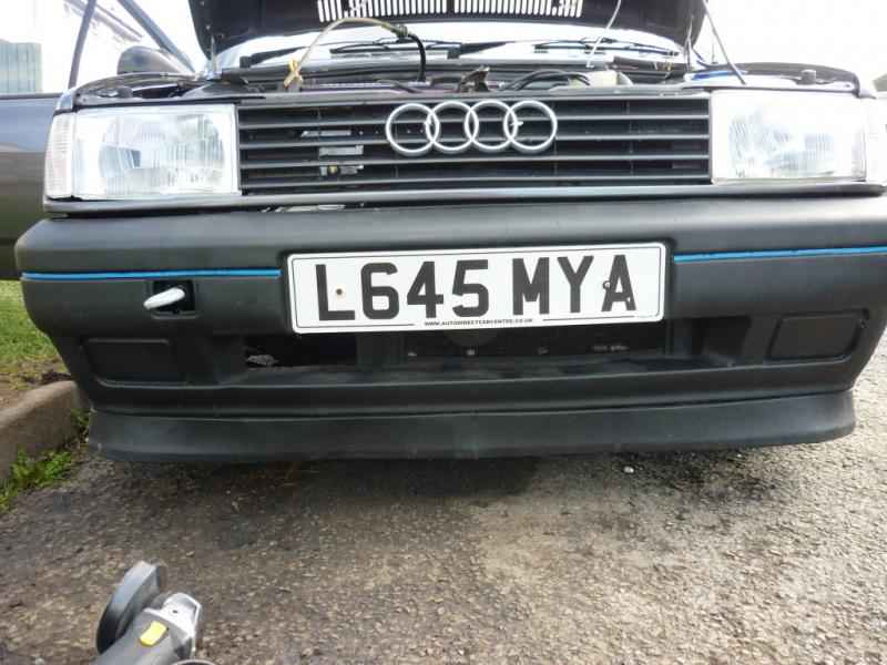

Little UPDATE:

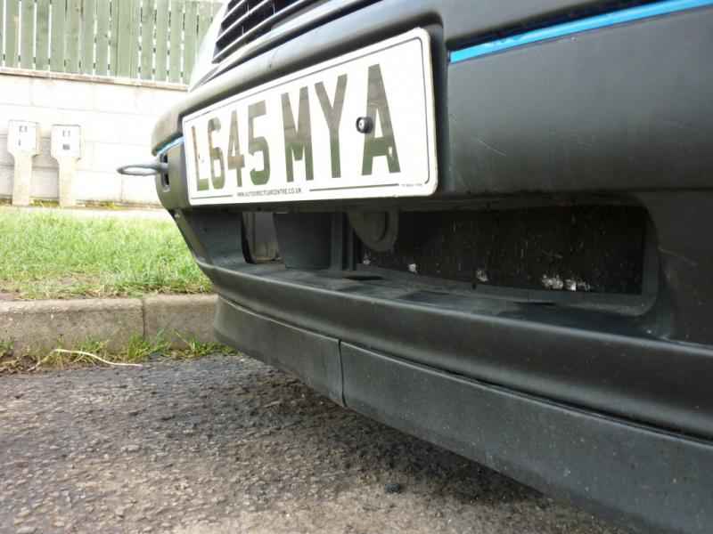

cut the little slots out of the front bumper today think looks a little better i think
might get some mesh to fill the gap ,but might look but chavvy so not sure yet!
few pics....
cheers :)
Edited by 01mlacey

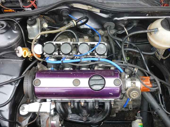

ITS ALIVE ! again :lol:
now have clutch problems ,its not disengaging
so ill take some pics and a video 2moz then ill take gearbox off

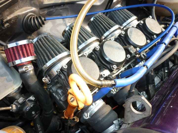

Lil UPDATE:

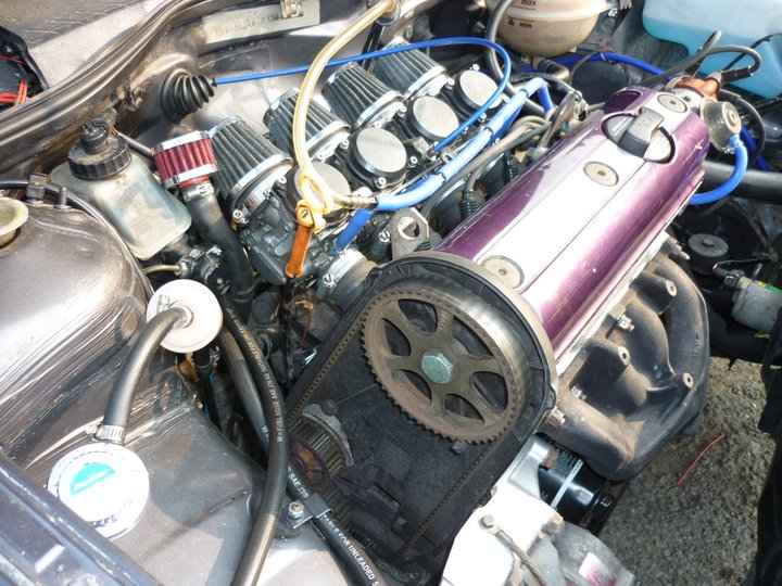

added some cone filters on to the carbs and to be honest i think it runs better as its bin said they can be restrictive
will get some pics up soon
cheers :)

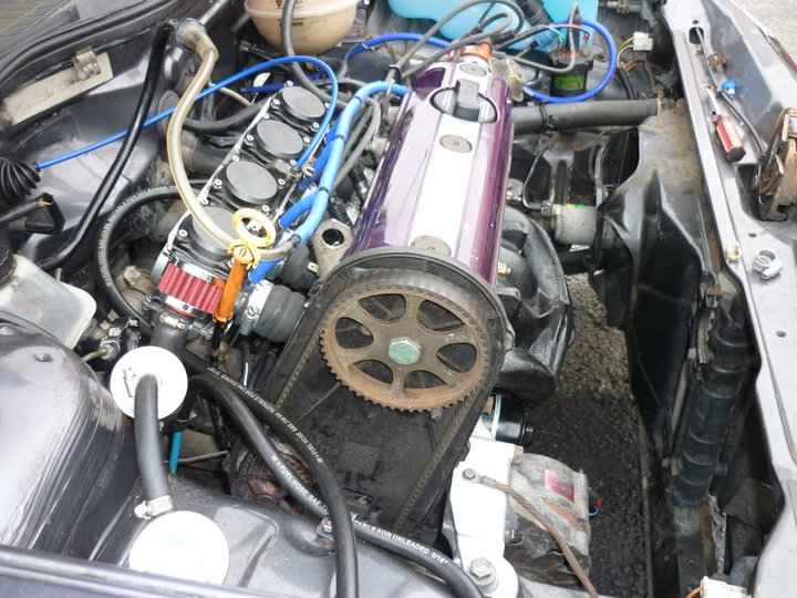

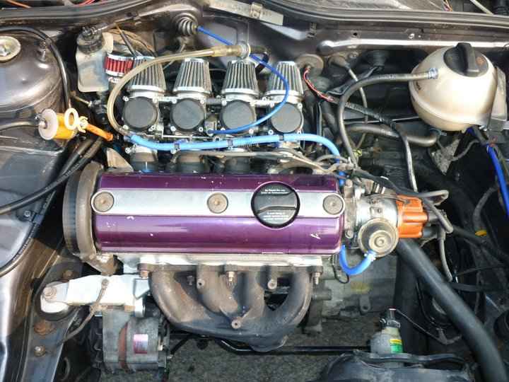

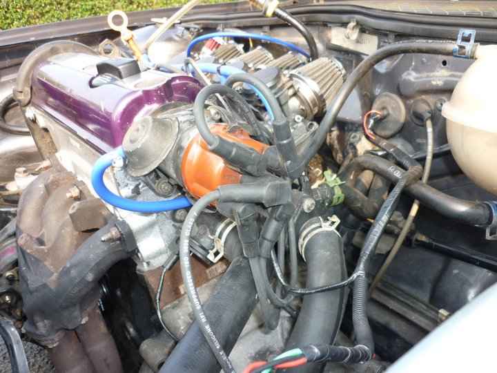

Took some new pictures today of the engine bay
filters yeahhhhhhhhh boi!
