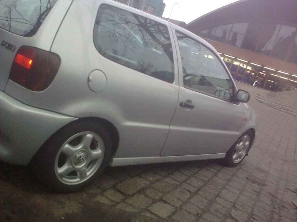

Hi.. I'm new to forums but i thought id just give it a try because it looks like theres lots of useful info here!! I've just bought a 1998 Rreg vw polo 1.4 16v , i saw it parked up abandoned and fell in love so i bought it.. I've just had welding and everything done for the mot but its running on three cylinders and i dont know why! i pulled each ht lead off one by one and tested for a spark and there all sparking fine.. just put new spark plugs it aswel!! and I'm not a mechanic so i was just wondering if anyone could give me some good advice or where to look next??? I'm gona buy a haynes manual tommorow!! so any advise would be apprieciated very much !!! thank liam
