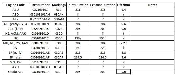

Updated with a bit more info I've collated. Note that this isn't data from measuring cams first-hand, so use it at your own risk!
Any additions/corrections, let me know.

Was litterally just going to ask if anyone knows the specs of the AAU and AAV cams,
Thanks andy!
Anyone managed to find the specs for the 030AH can from the ABD?
Same spec as AAV/AAU i believe.
AAV and AAU are different to one another. I think the Dutch info I posted is saying that the AAV has different overlap to the AAU, although the durations are the same. If they were truely identical, then they'd have the same part number.
It'd take common sense to work that one out though Andy!
Ah ok, didnt realise the text said that. The difference will surely be minimal between the overlap anyway?
It'll be significant enough for VW to bother developing a different profile and carrying an additional part. We'll never know whether it was performance, emissions or durability related though.
Could always stick some cams in a spare cylinderhead and measure them up. It's a ballache to do manually, but possible.

On ‎21‎.‎9‎.‎2011 at 21:49, Andy said:
Can you see this?
Did i understand right? i can fit anyone of those in to my 1.6 8v ABU engine?

I've just picked one up that I bought on eBay for peanuts. It was advertised as a GT camshaft but looking through this post, it is not from a GT, it's a 030E
I think (?) I have a NZ block ('87 ranger, 1.3 55hp), looking at the specs here it looks like I might get a small improvement even if not the GT gains I'd hoped for.
Reason for commenting, I just wanted to know if I've got my facts straight, and also if people think it's worth chucking it on and see if it makes a difference? or maybe I should get my money back and look out for an actual GT camshaft or something similar.
Edited by meganscott
ah hold on a minute, mine is... an MH block! so actually this camshaft is... exactly the same as the one I have! great.
