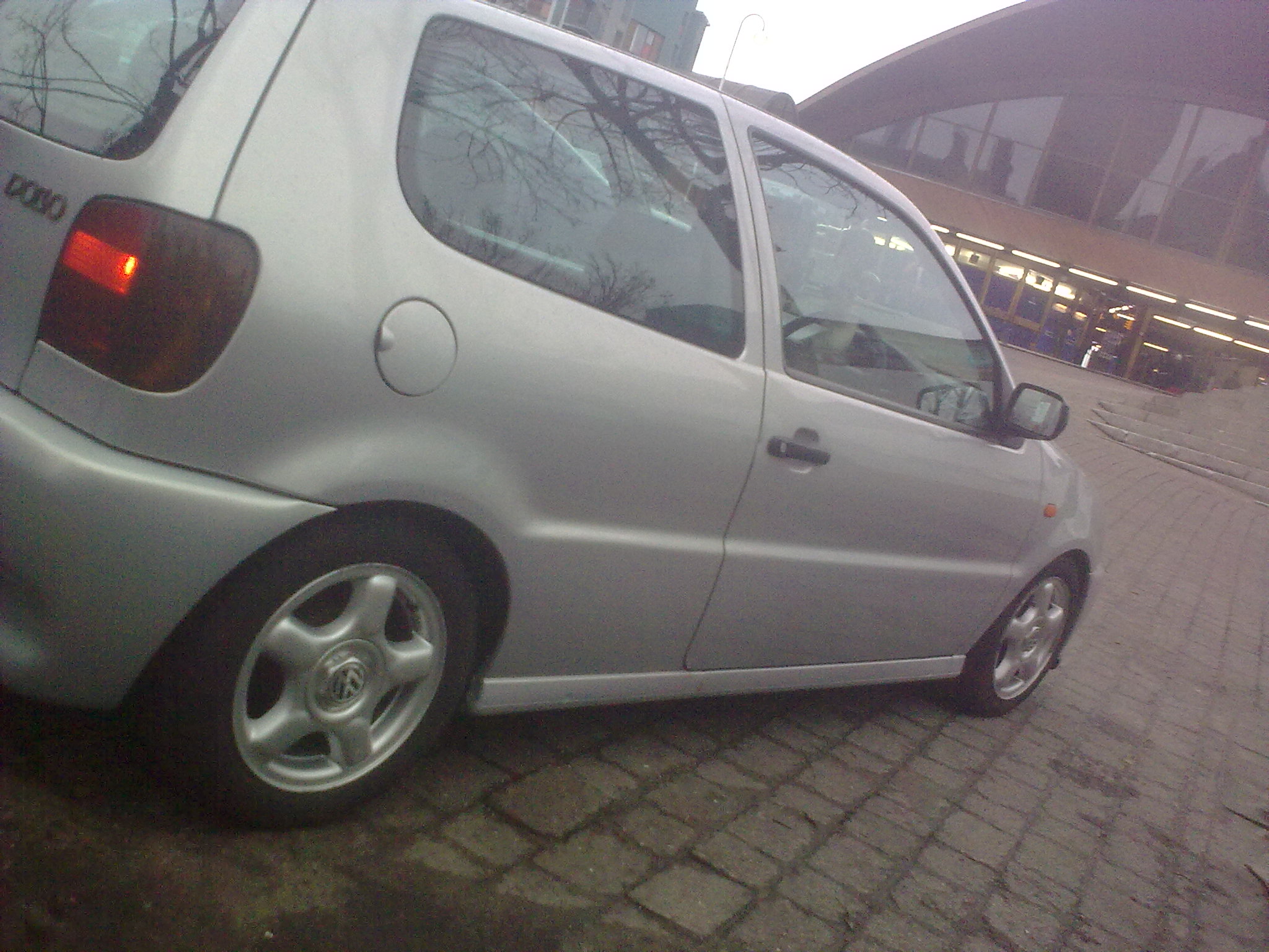

I'm thinking about buying these for my polo, what size tyre should i buy to get the best stretch!! 165/55 ?? i think they will luk smart!![/size] SPML5E.jpg

There et7's!
Would anyone know if they would fit over my calipers, or would i need spacers??

13's wont fit over the valver brakes mate, 14" minimum iirc

you will most likly needs spacers i had to get 5mm one to fit my 14" wheels
13" wheels don't fit over the 16v brakes, you need minimum 14" wheels mate.
Ohh i see, just been looking at other forums and realised that :( Think I'm gona save up for sum banded steels 14" 7j or 8j
Thanks for the advise mate
You can get 13" wheels over valver brakes but you may very well need spacers.
But to be on the safe side 14" minimum.
Plus if you intend on going LOW in a valver on 13" wheels you will find yourself with a world of problems.
