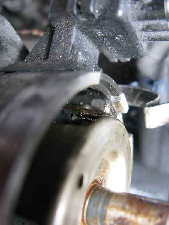

We took the dizzy cap off to have a look and it seems to be quite loose and there was moisture inside!? So going to replace that as well as the rotor arm. In fact the distributor rotor arm contacts look a bit oily and grimey (pic attached), which is a bit weird no? Anyone got any advice on how best to clean it up?

Gave the distributor and cap a good clean out. Bit concerned that there is water getting in there so going to keep an eye on it and prob replace the cap at some point.
