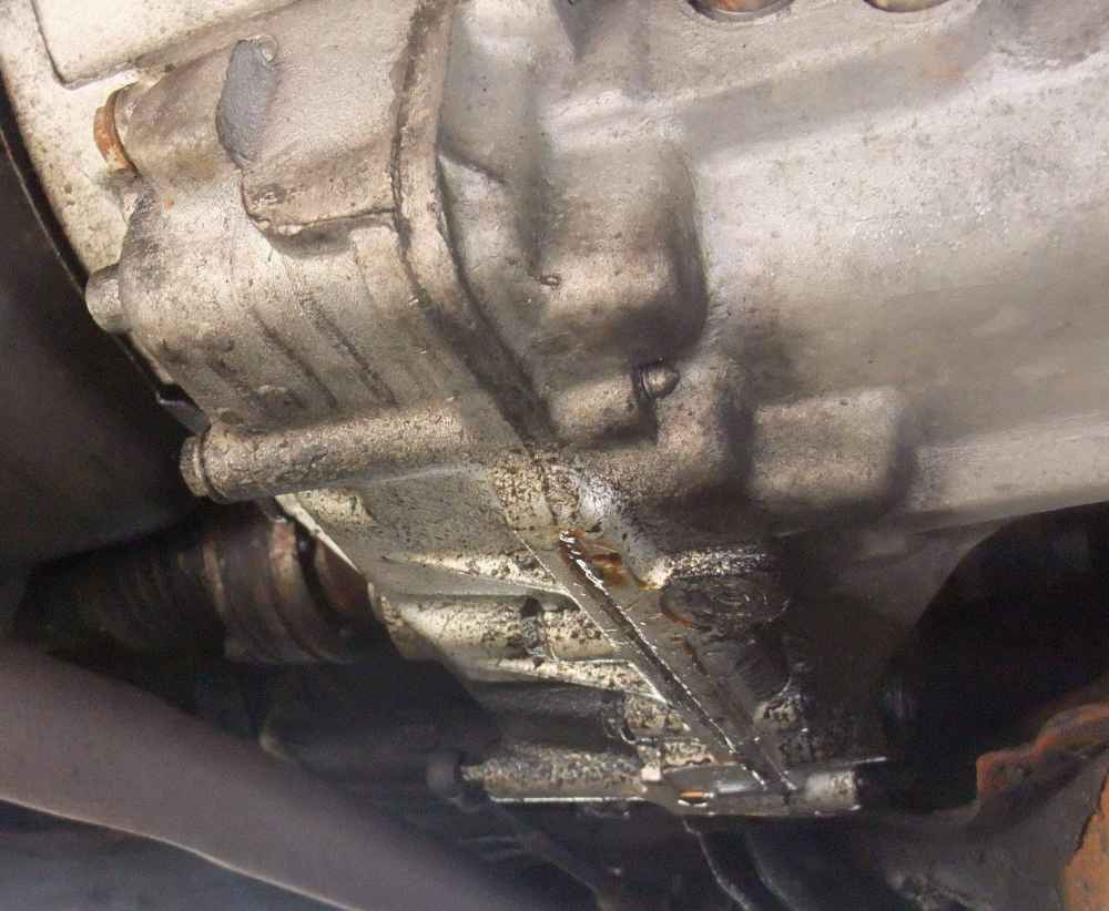

Pics anyway, that should give a better understanding
Here's a picture showing the leaking area, hopefully u can see it clear enough on the picture.
With an oil leak like this, the oil tends to run along horizontal surfaces (like the bottom of the gearbox) before it actually drips onto the floor.
Your picture shows the all all right, but not where it is coming from. The selector seal is further back than the picture shows, maybe a picture from behind the front road wheel would show it up better.
Another option could be to wipe away the oil from under the gearbox, take the car for a run and on your return, try to see where any further leak is coming from.

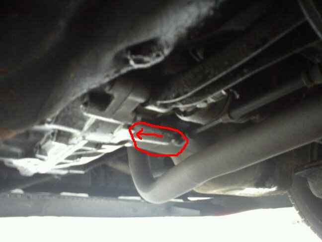

I think I may have found where the leak is coming from.
There is a cylinder shaped bit, as u can see I have drawn a circle round it, I think the leak is coming from where the cylinder joins in to the gear box, I have cleaned a whole load of dirt off it and will check again in a few hours, as I could only detect tiny traces of oil around the join. Anyone got any thoughts on this? Where abouts is the selector seal?
Thanks Loads!
Yea that will be the selector shaft seal. My 6N has the exact same problem. I keep it topped up for now til I have a free weekend. It's been leaking for about 6 months now in little drips, but has worsened a bit recently.
Quite an easy job really just a pain to get to without a pit!
