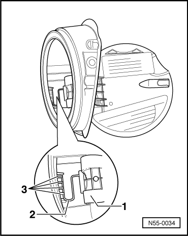

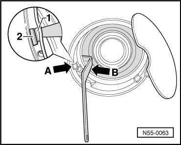

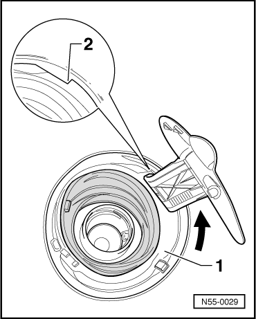

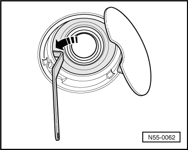

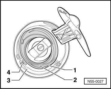

Removing
Note:
→ The tank flap positioning element -4- (locking rod is illustrated) must be removed on vehicles with central locking =>Page 57-25.
‒ → Remove filler cap.
‒ Pull ring -1- (behind the sealing lip) out of rubber cup -2-.
‒ Press rubber cup -2- off the tank flap unit -3- towards centre of vehicle.
Then when the unit is removed
Tank flap unit
Dismantling and assembling tank flap unit
Dismantling
‒ → Push pin -1- out of tank flap unit -2- with a punch
‒ Remove tank flap from tank flap unit.
Assembling
‒ → Pre-fit pin -1- in the tank flap sleeve -2-.
‒ → Hook spring -1- in tank flap.
‒ → Insert tank flap -1- into tank flap sleeve with the spring -2- behind the locating lugs -3-.
‒ Close tank flap and push pin in.
‒ Check function of tank flap.
‒ Installing tank flap unit => Page 55-27.
‒ Install positioning element.

Sorry to bump an old thread but does anyone have the attachments that were originally posted on this thread. I can't remove the c/l pin.
I had to delete them from my attachment folder as I was running out of space
I think they are in the correct order for the write up above
Thanks, which way does it twist?
The big arrows are a clue :lol:
:lol: good old nige
Ooops! That'll teach me not to look properly! Thanks
