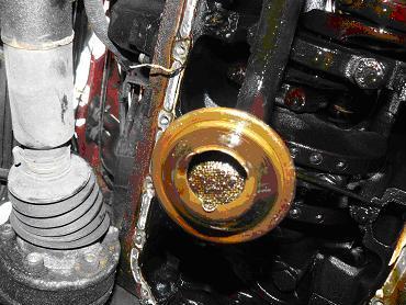

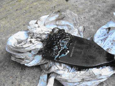

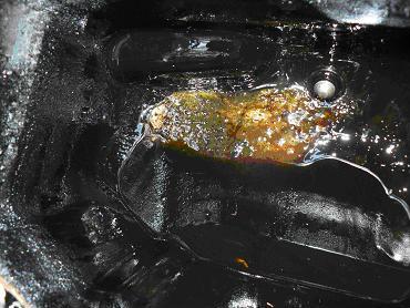

Once the sump had been removed the amount of sludge in the bottom of the sump could be seen and it was reasonably obvious that this could be the cause of the problem. The car has done 79K with a full service record which shows the oil and filter have been changed as per the service schedule.

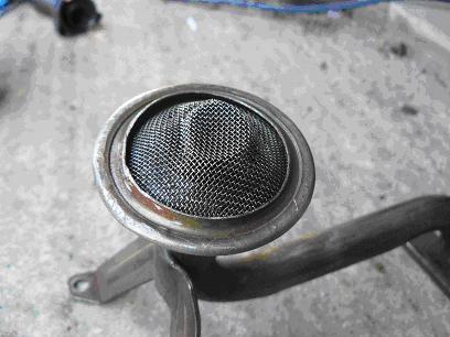

The oil pickup pipe wire mesh sieve was also partially blocked with sludge and due to the design of the pickup pipe and wire mesh sieve with the metal shroud any sludge just gets compacted around the sides of the wire mesh sieve and cannot drop out of the shroud end. This results in a reduction of the available surface area of the wire mesh sieve and the increased chance of blockage with any sludge deposits in the sump (of which there were many)
I have many years of experience in building Race Engines and am a qualified Automotive Engineer so the following describes a modification that was made after the application of years of experience and knowledge of how lubrication systems work.
The modification was made to the end of the oil pickup pipe by removing the metal shroud. This has the effect of preventing sludge from building up and blocking the sides of the wire mesh sieve.
The shroud was cut using a hacksaw, with great care, and cutting through the metal shroud as far down as possible.
The resulting oil pickup pipe end would be less likely to clog up with sludge and would present a greater surface area of wire mesh sieve to allow oil to get to the pump
The distance between the end of the oil pickup pipe and the base of the sump is very little and the modification will allow a better flow of oil around the pickup pipe.

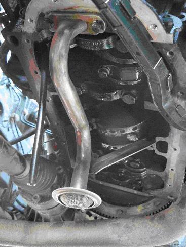

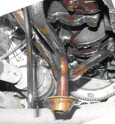

The before and after photos are shown below and illustrate the improvement.
Before
After
Comparing the modified oil pickup pipe with the original you can see the removal of the metal shroud and the reduced chance of clogging.

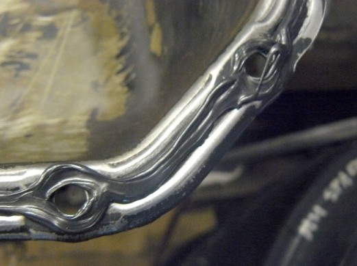

With the modified oil pickup pipe refitted, not forgetting the gasket, the sump can be refitted after cleaning and the application of silicone sealant (Loctite 5910 or similar).
Make sure the boltholes have silicone sealant all round.
