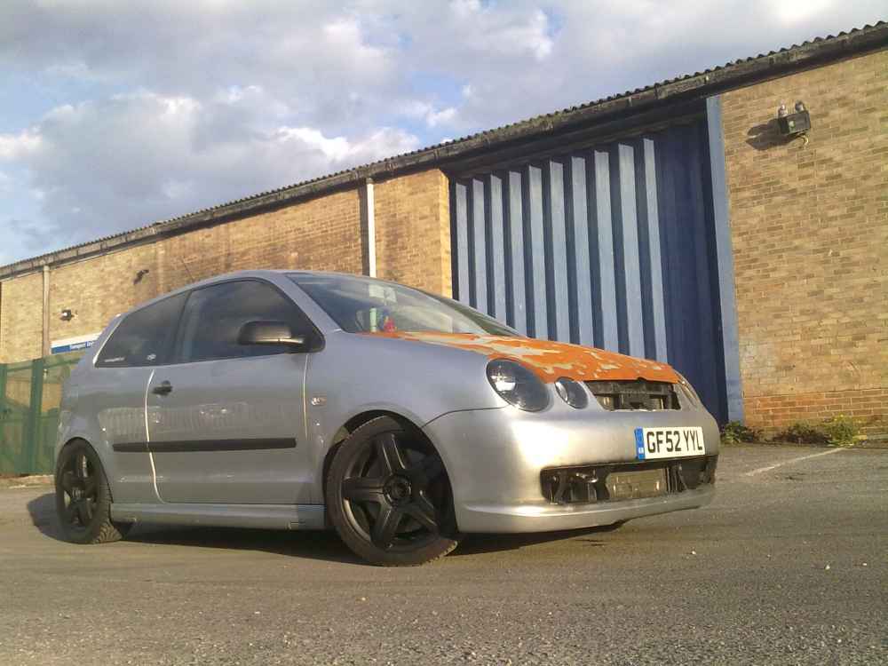

Well, I bought her 4 and a half years ago, as a 1.2S, 41K miles on it. Over the next 3 years, she proved her utter unreliability of the 1.2 engine and management system, by eventually burning out at 100K miles, with the following "Faults": 2 Badly burned out exhaust valves, Bottom end knocking on the 3rd cylinder, 3rd Gear no longer existed, Huge oil consumption, Very loud knocking coming from gearbox :s
Other than that she wasn't too bad! So I thought, time to replace the engine.
So many people told me to go 1.8T, but nooo I wanted that 6 pot Burbling Roar of the VR engine!
So I set myself to it! Stripped down the 1.2 engine, got on with making the VR fit in that engine bay :)
Have a looky at the pics, and there are more to follow, along with a few vids :D

Sleeper much? Bay pics?
:lol: yup!
I'll try get some Bay piccies soon :)
yup pics a videos asap got to see this :)
Pics! of the bay :)

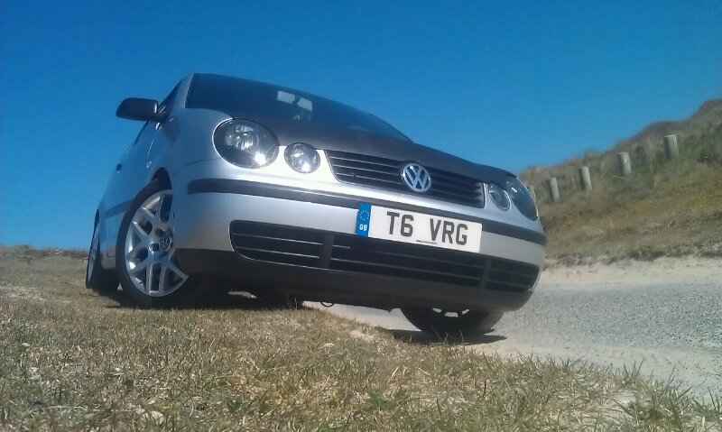

Sorry for the late reply, just realised I never posted up the piccies!!!
Well, here are a couple, unfortunately she's having a little rest at the mo so cant get any more piccies, but... Ahem.... You'll know about it when she's back from her little "rest" winky wink ;)
Keep yer eyes peeled my people!!!! :badgrin:
:unibrow:
grabbin a bit of air haha :)
