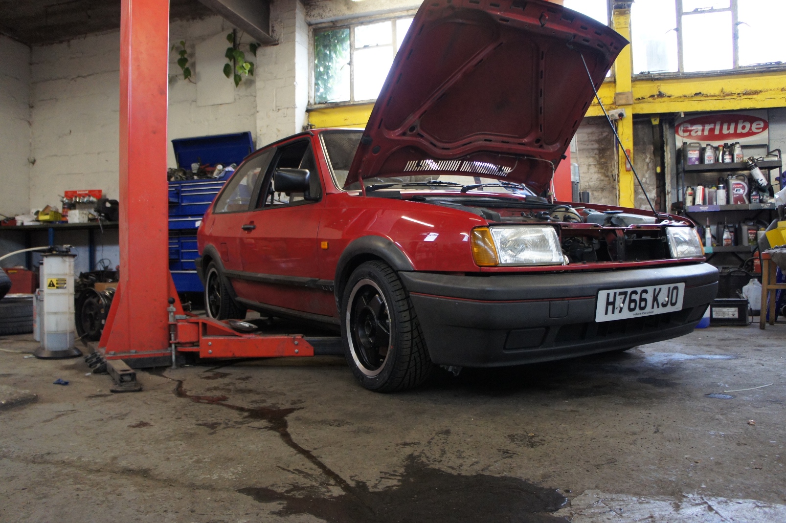

Quick update on progress
Rear suspension - out
Exhaust & manifold - off
Got to garage, something on the lift so had to use poxy axle stands...went a bit in reverse - took the rear suspension off then realised I needed the car decked to loosen the 30mm 'hub nut thingie' - well that was entertaining to say the least on stands...let's just put it this way, it all got a bit pikey...including a visit to McD's at 23:00 to get a coke and leave things to 'soak in some no name lube/release agent' found lying around the garage
Need some exhaust rubber hangers and some bolts for the rear suspension
So I've learnt I can take things off a car...hmmm...I'll found later how good I am at putting shit back on (correctly)
Loadsa fun though
Rear suspension on
Manifold on (lambda boss sorted, shit looking weld by Hi-Q but it's done)
Fan on
Oil filter changed
Sump gasket not going to be changed - too much like a pain in the ass, tweaked all nuts, will steam clean and re-assess in due course
N/S front suspension assembled ready for refit tomorrow
Brake fluid drained ready for calliper and lines change tomorrow
Drive shaft nuts are a bastard, literally welded, ARB not easy to get hold of at short notice, managed to get N/S off, O/S plenty lubed with penetrating fluid so fingers crossed for an easier day tomorrow - new nuts were delivered by TPS...for £1.20! Love trade :)
Dad ground off the heat/stone shields to make getting the drive shaft nuts off easier - also cut out the old rear silencer hanger and will weld in the repair kit panel...says he'd rather do it right or he won't bother helping at all - keeps him busy ;)
Finished up at 17:00 today, really only started on car at 11:00 due to pissing about in the morning getting lambda boss sorted...and getting some strut bolts n nuts cos the ones I removed from the rear were fucked
Went to see 'Senna' - great film, thoroughly recommended if you're a racing fan
Lowered using AP shocks and springs kit supplied by PhilJ
Rears are on the middle notch currently - I'll see how it settles before I think about going any lower - would like to end up with an even stance in the end
Right then update from today, got down the garage later than I had hope cos I'm at my parents for the weekend using dads garage, dad doesn't drive and I didn't realise mum has a lie in on a Sunday, so had to be patient and wait for the lift - was a f&!k walking in this rain! Took laptop and camera with me, laptop for reference to the right Haynes manual I have on PDF :)
I am really chuffed with myself, changed the water pump and cambelt!! Turned it through manually 4 times to make completely sure I (and it) was happy...So things completed today
  • Waterpump
  • Cambelt
  • HT Leads
  • Spark plugs
  • Distribution Cap
  • Rotor arm
  • Coolant (as part of doing the water pump)
When I started the car after doing the cambelt, I had left the airbox and pipe work disconnected - this is definitely required to start the car - absolutely shit myself thinking I'd bolloxed up the belt, would not fire. Then it started (just) and died...again shit myself...was it fucked?! Took off the cover and ran it through manually - not fucked.
Couple of minutes checking and double check all connections, realised I'd only placed the positive and negative leads of the battery back on...this was fine earlier but not this time, tightened them - WOOHOO. Oh the relief!!
Can't stress how chuffed I am about changing the water pump and belt - great achievement in my book. Bloody tedious, not exactly difficult I'd say, just frustrating working in such confinement (engine in). Any one doing this will be grateful of a good set of Snap-On sockets - they seem to be the perfect length to get around the covers and shrouds - and ratchets are just slimmer too, enough to fit in tight spaces - however, still a tedious job
Pictures from today found here
And I'm done
The exhaust blows a little due to the connections, but I'll end get this solved with Cycloflex or get down to a PowerFlow type place and have them put in a solid connection from manifold to mid section
HEL brake lines are going back and I'll get some Goodridge at a later date
The ARB bushes will be ordered from gladerseite later in the week to replace the SuperFlex ones which cause fouling on the manifold
Really pleased with myself with the amount I've been able to do personally - especially in such a short space of times :)
Photos
