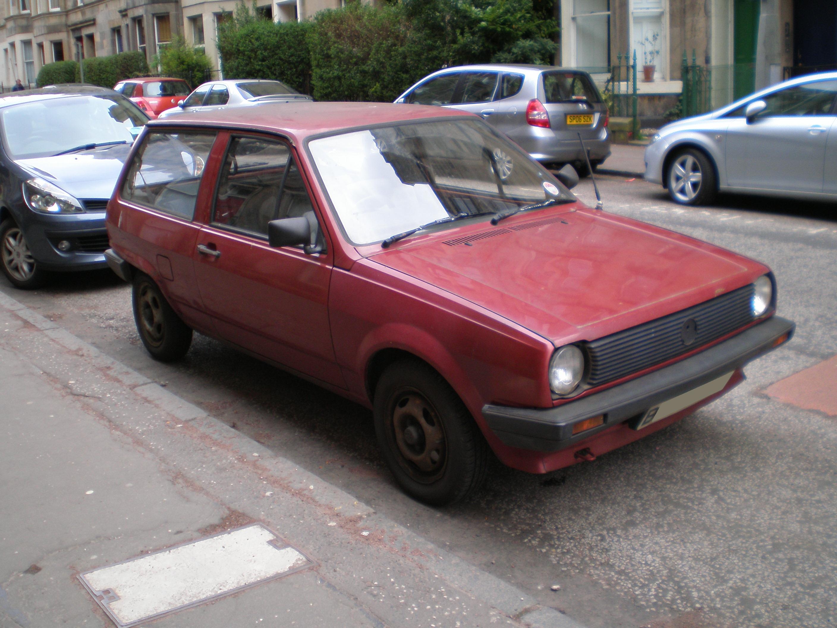

This is my Mk2 Breadvan project.
Model: Mk2 Polo Braedvan, B reg
Engine: 1.05 (most of the horses have escaped thou)
Suspension: Standard/Spungy
Brakes: Standard/squeeky
Wheels and Tyres: Standard steels (rusty) + Balloons
Exterior Styling: Standard/faded + dented + rusty
Interior Styling: Standard/dated and a bit tatty
ICE and Security: Standard/scippy CD player + the bootlid is a total pain to open.
Comments: This is the first and only car i've ever owned, I got it in my late teens from my folks, they told me that I could have it till it died, then i would have to buy a "proper" car for myself.
So a very long story short, that was about 12 or 13 years ago and shes still running (sort of). It was getting and sounding more and more tired so i decided about Xmas time to start getting parts together for a major overhaul during the summer. The MOT was due to run out at the start of June so it was a perfect time to start.
(wow check the massive bird poop! didn't notice that before)

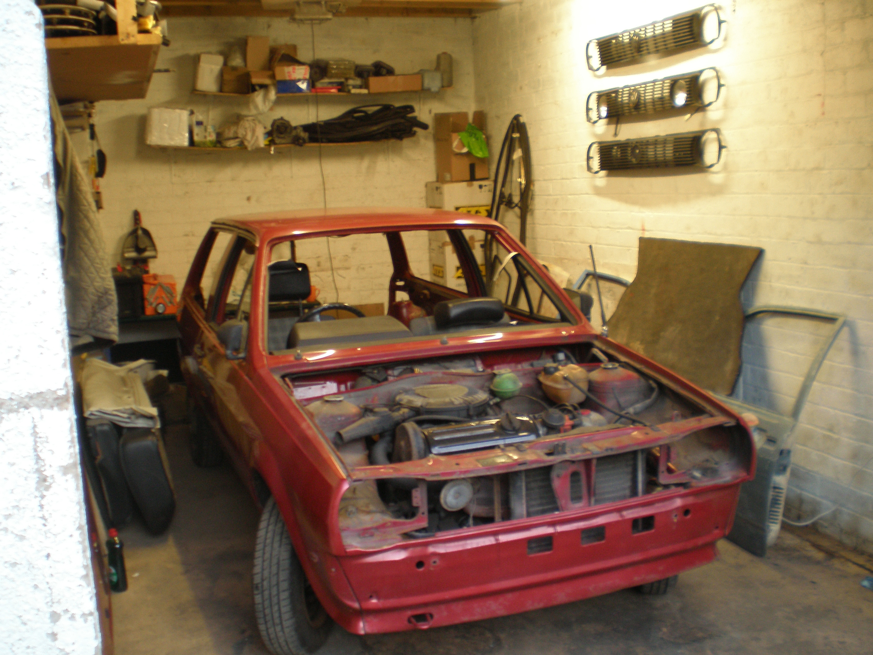

I live in a third floor flat so that ment I had to get a garage space to work in.
I found one on the tree of Gums, Its cheap and even got a pit. It was totally full of water and mouldy leaflets. It took a good days work to clean it out and then seal it against more leaks.
I've now filled the garage it with tools and all the parts that I've been collecting this spring.
so once moved in I gave the old girl a good clean
then started to take her to pieces, its amazing how fast these wee cars fall to bits!

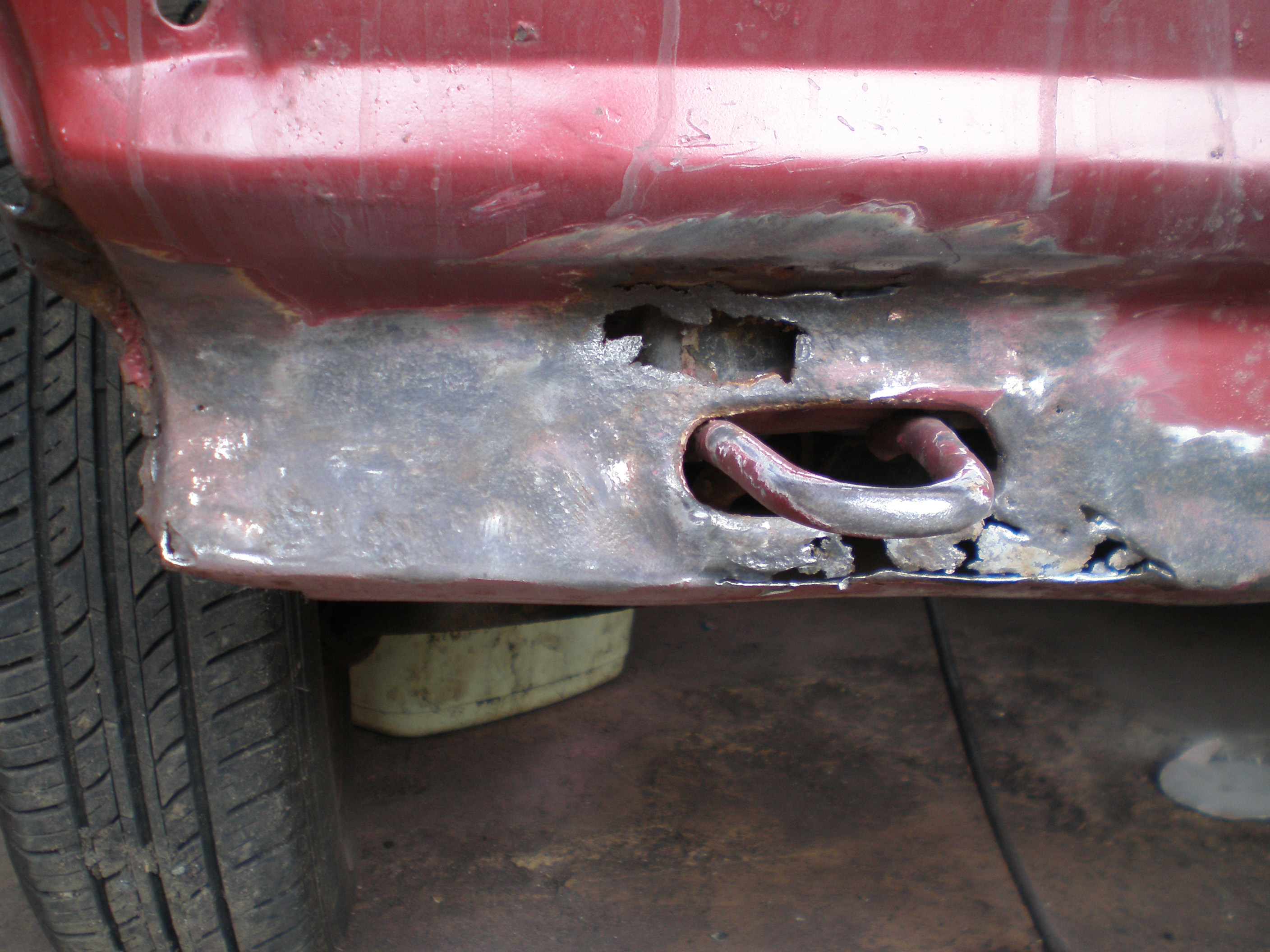

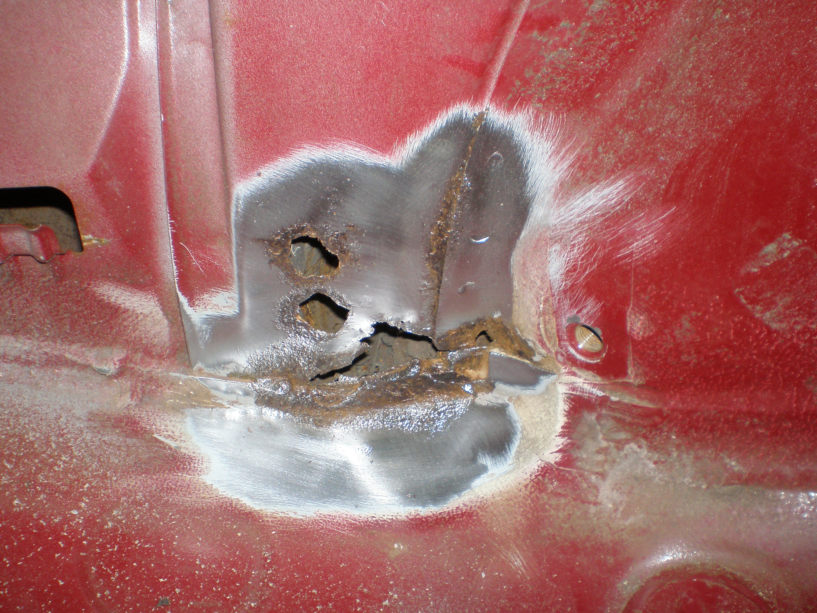

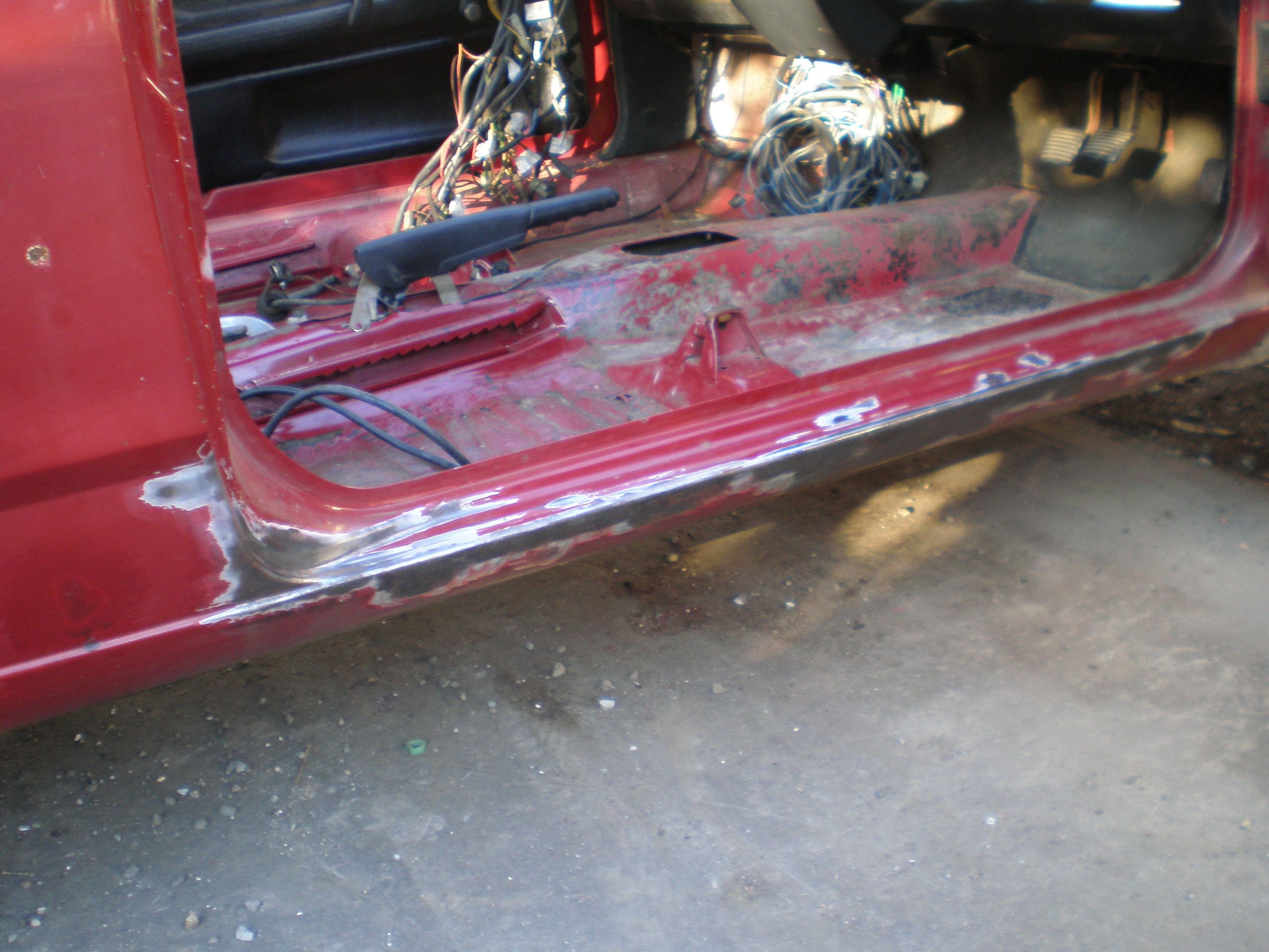

during the tear-down I started to come across what i knew i would, but had crossed my fingers against
which cleaned up to look like this:
Its fairly rotten in the arch as well where the tank breather tube meets the inner arch, nothing that's terminal thou, thankfully

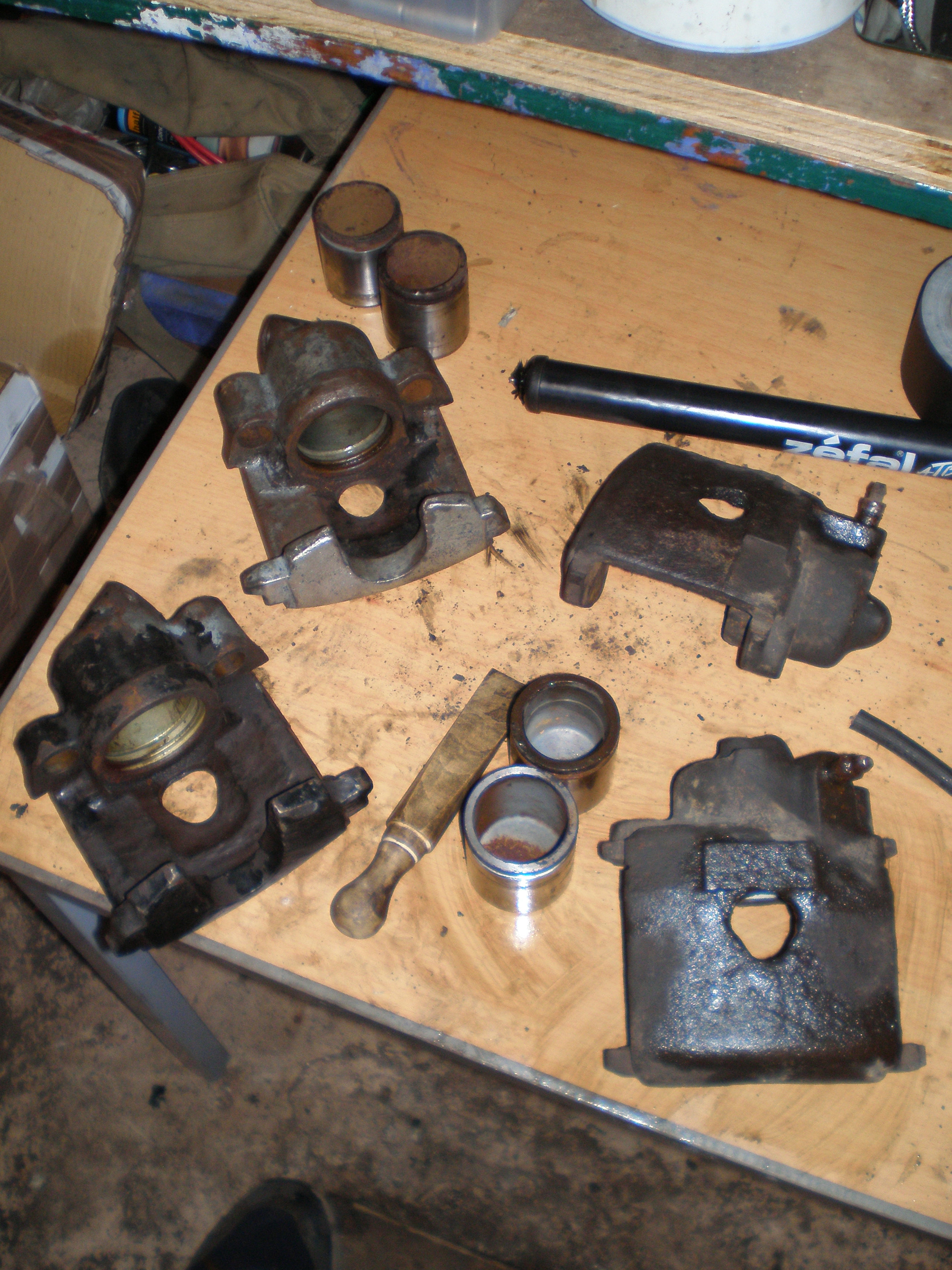

I started cleaning/fiddling with some "new" breaks

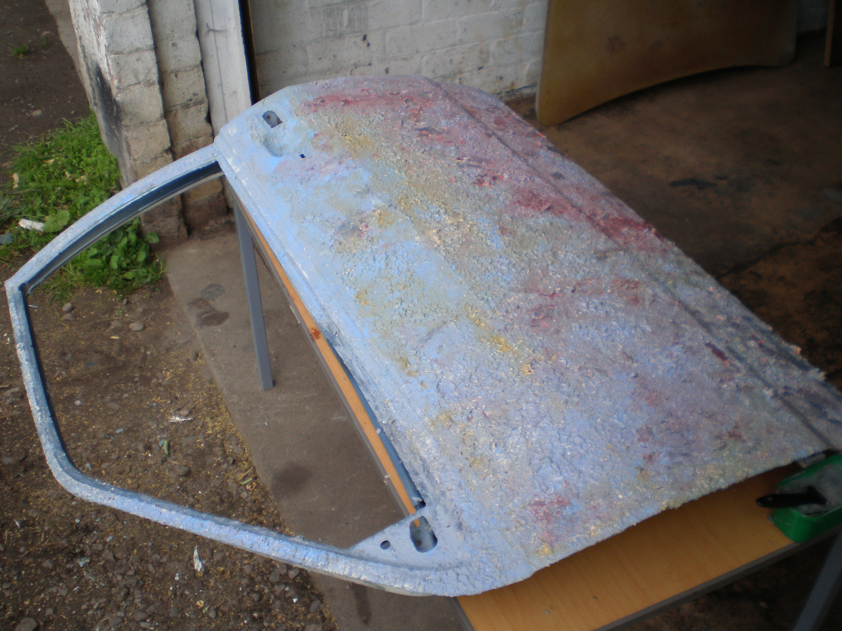

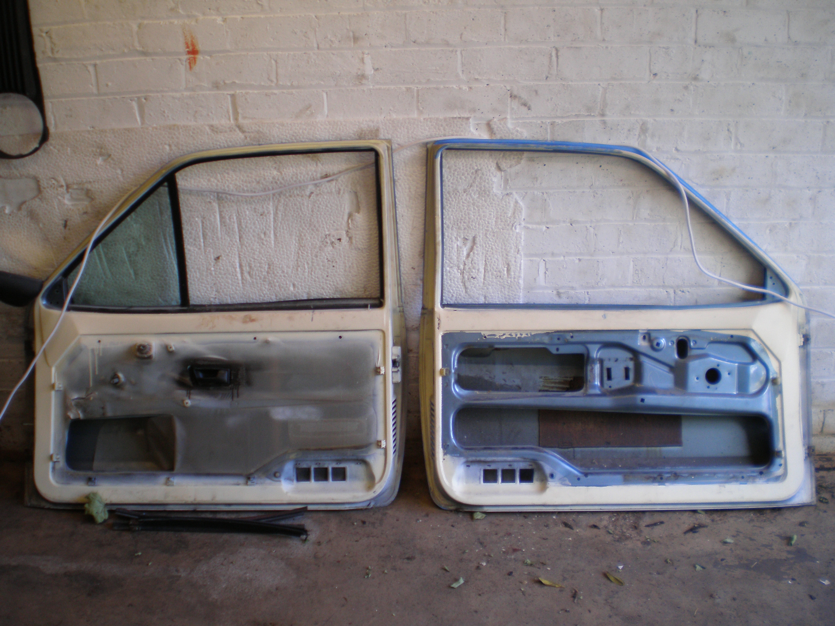

and stripping down the set of ding free doors that I picked up (Big Thanks to TonyDubDean!)

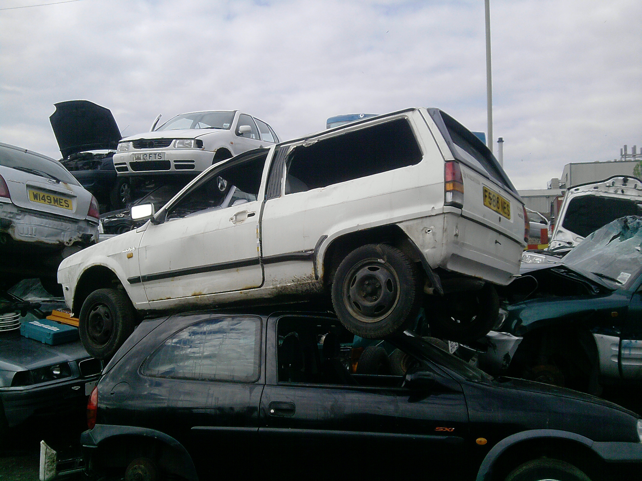

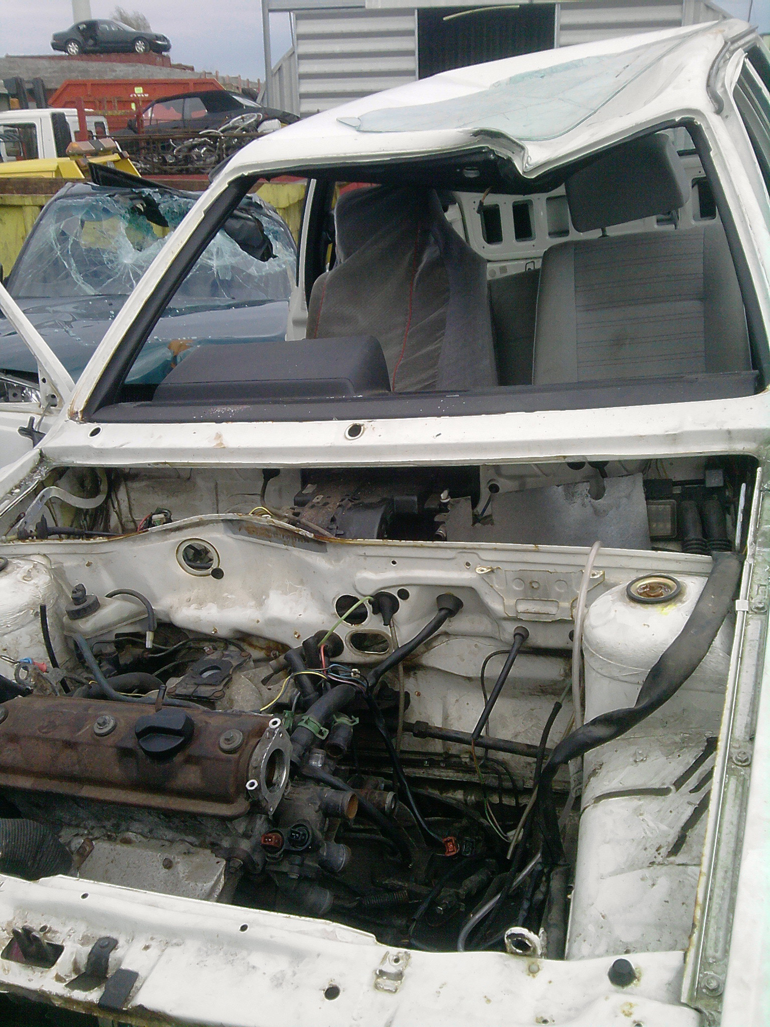

A couple of months ago i was going to collect my replacement engine from a scrappers up in Dundee when i saw a wee little Mk2 Match that was waiting for the squasher.
I enquired about stripping it down but they said they were selling it as a full car for 300 bucks. Having just spent all my cash on the power plant, I had no cash to buy a perfect donor car :(
So come next pay day I rang them, they said to come and get it, but
I arrived to find it in a rather sad state and position

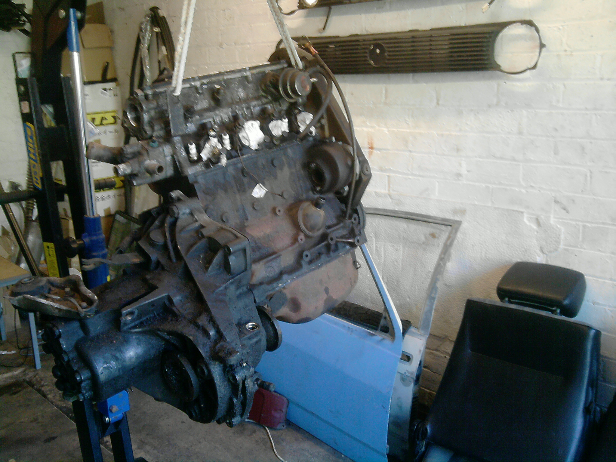

So a precarious few hours later I had as much off it as i could:
(these are when i had finished)
I even left behind me a slightly damaged black headliner because i ran out of time :(................

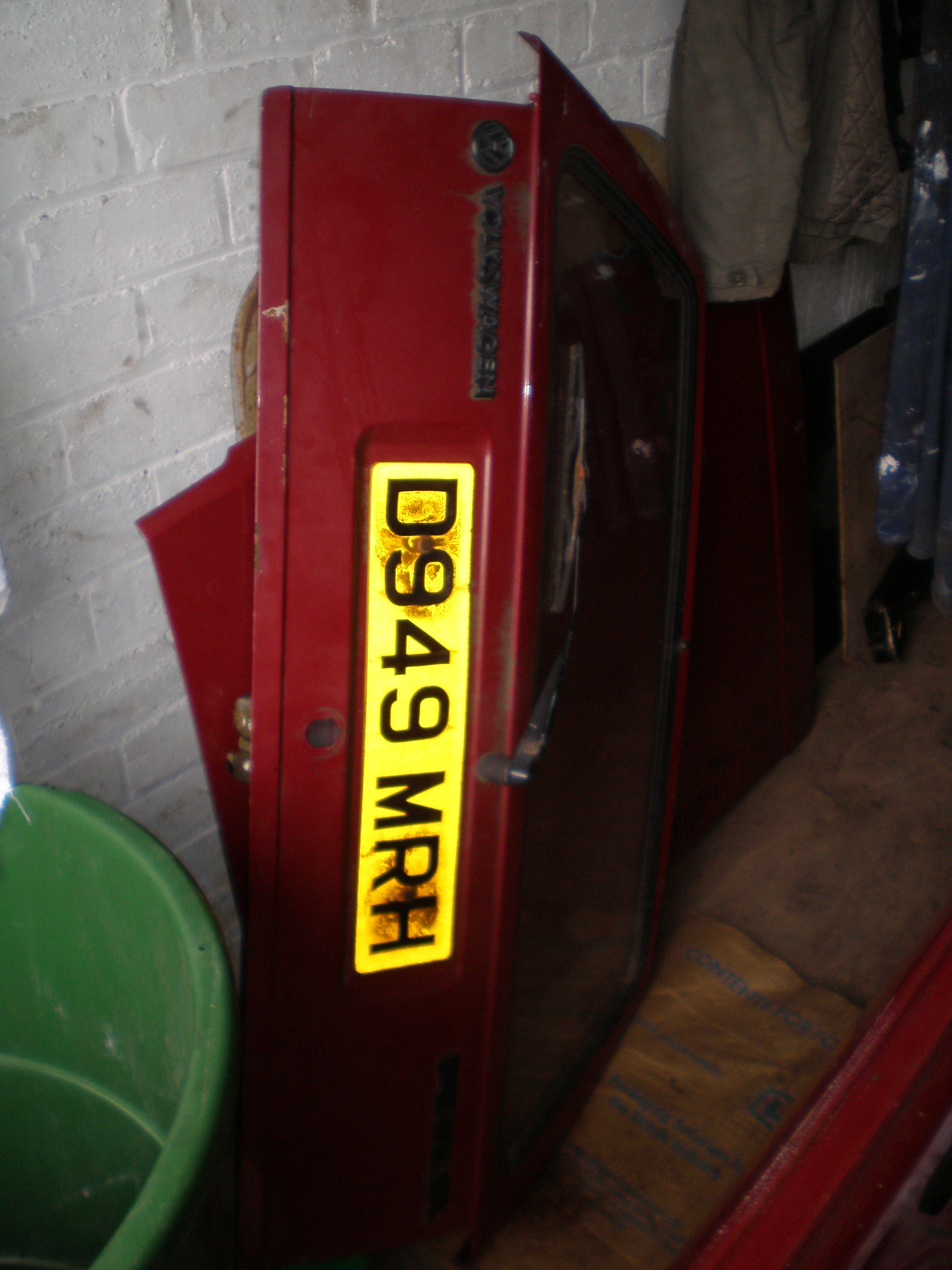

As well as dented doors, I've since found that my bootlid is full of rot, so i got a replacement:
(its even the right colour! what are the chances?)

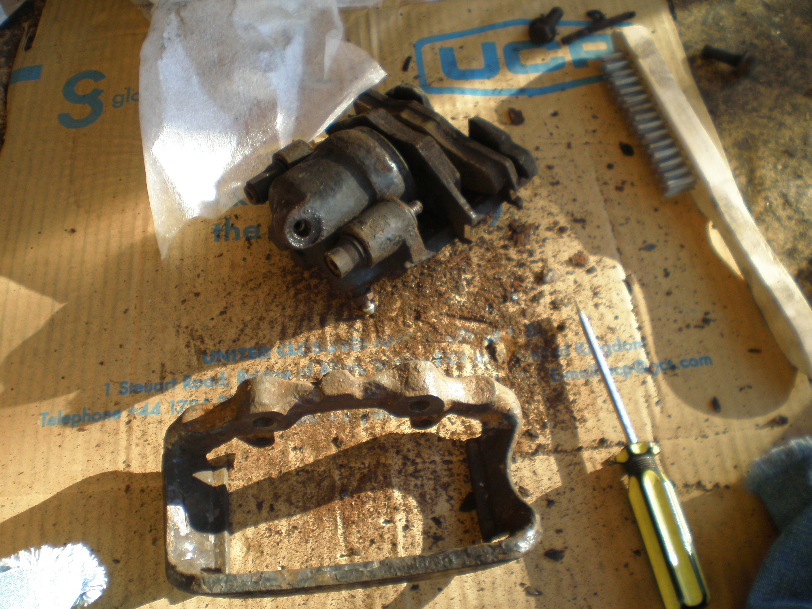

I've been doing more work on the breaks: (many thanks to Carver for the Faq)
I have a set of VWII's and a set of Bremos, not sure which I'll be using yet so I'm cleaning them both up till I make up my mind.

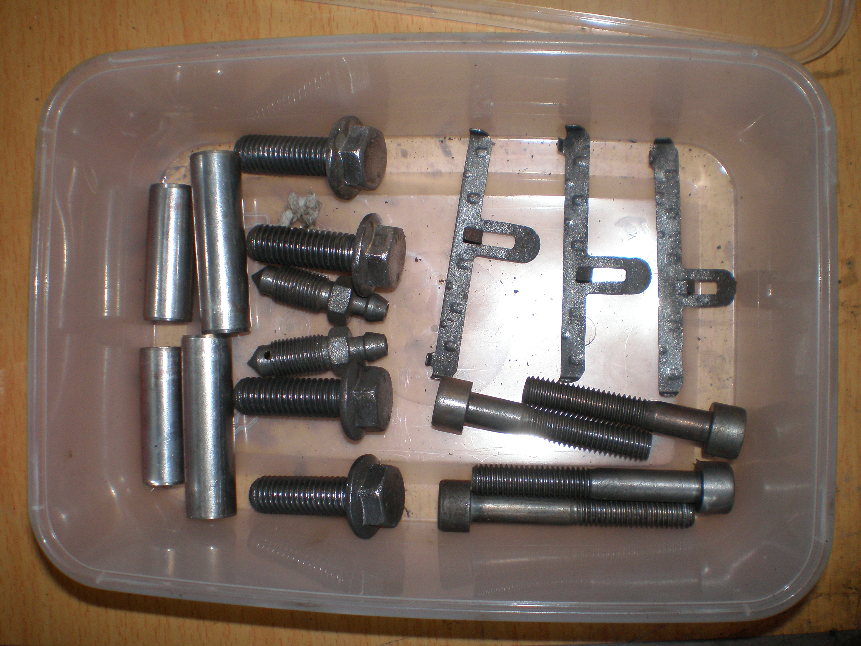

all the bolts/carriers/calipers Etc are getting the Cider Vinegar treatment and are coming out lovely

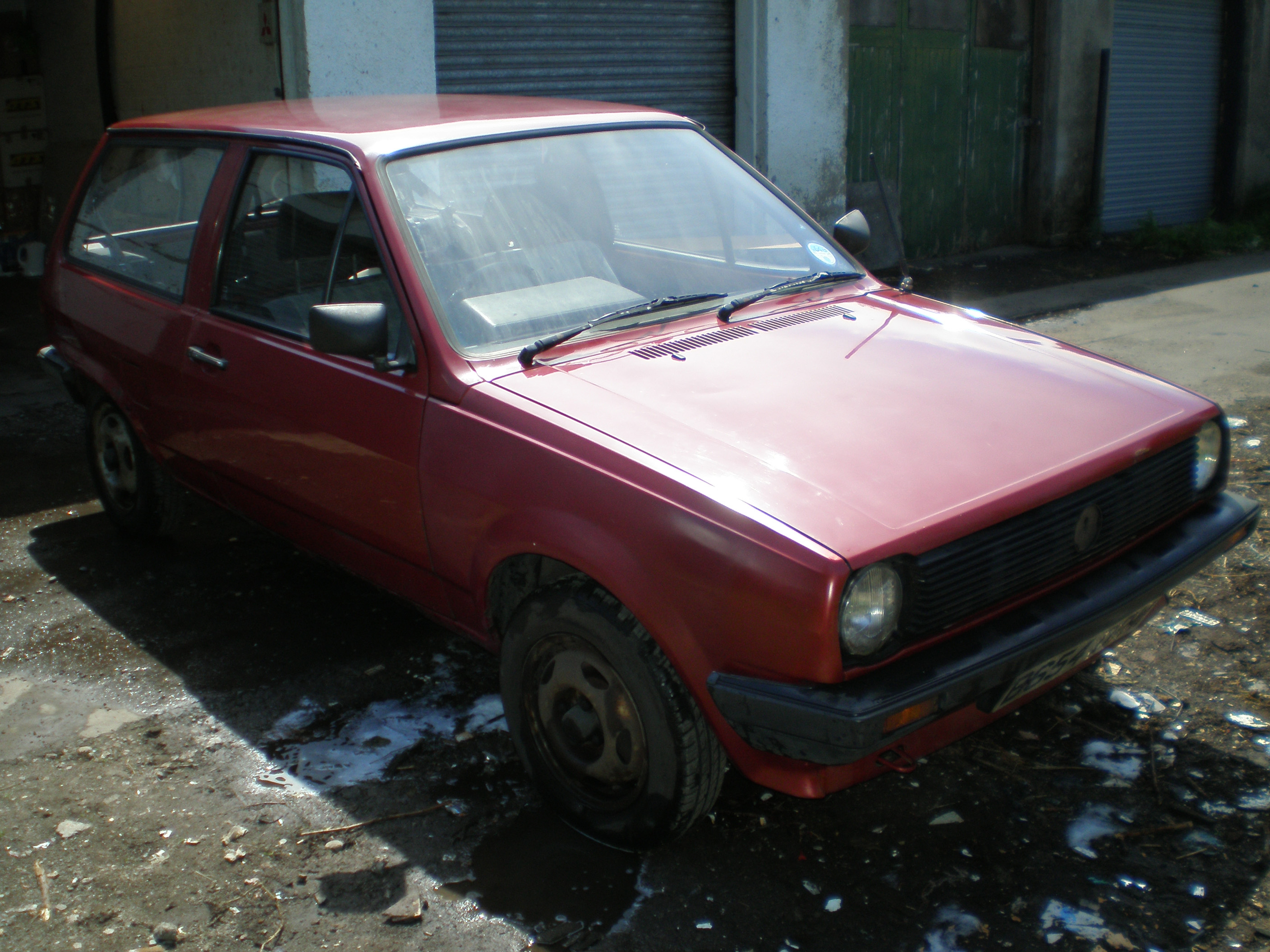

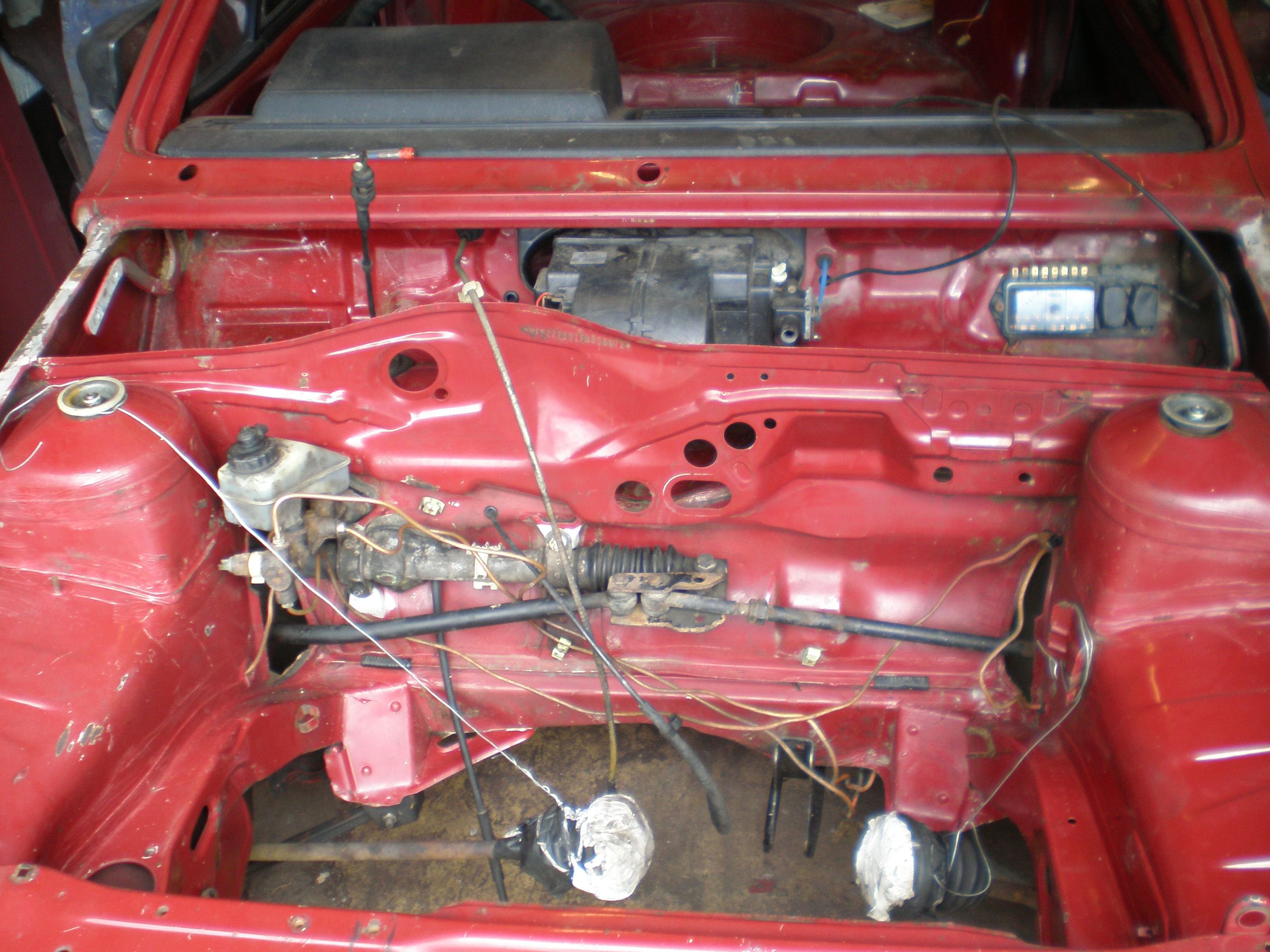

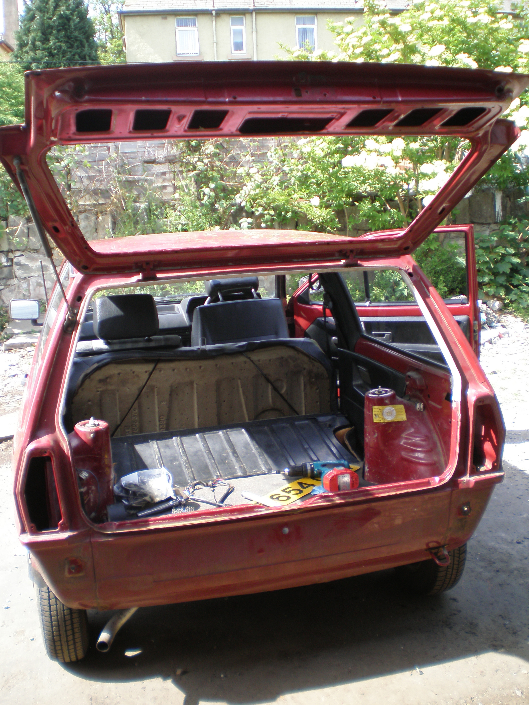

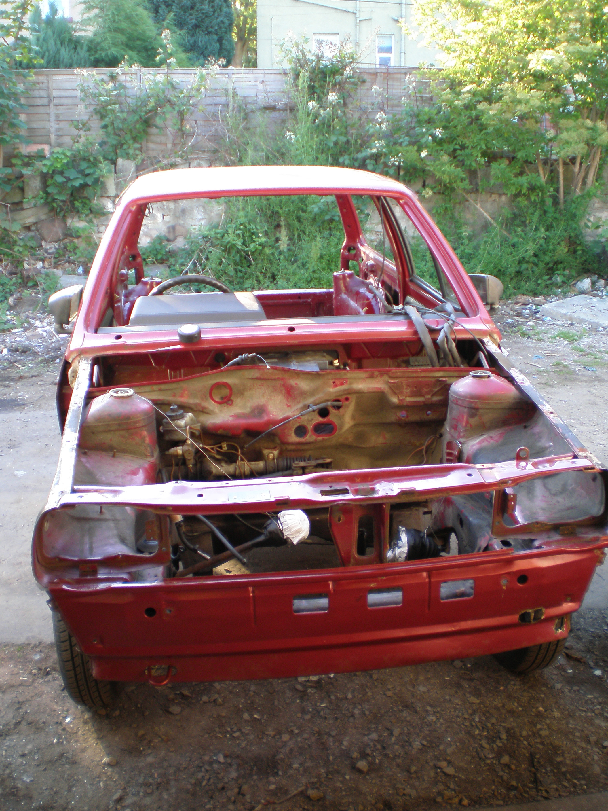

So until yesterday she looked a like this:
then I had a fun hour with a hired toy

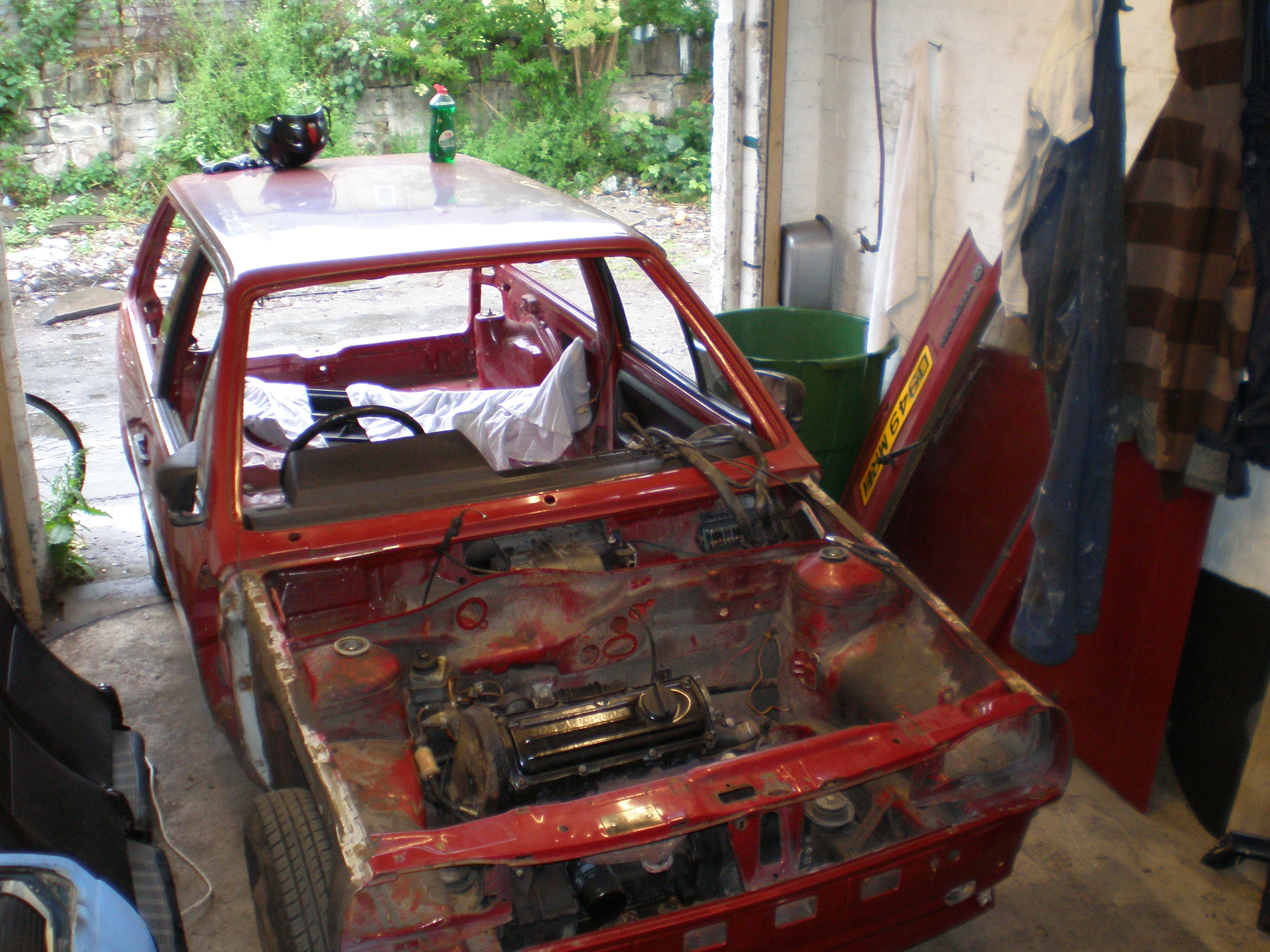

so she was all empty

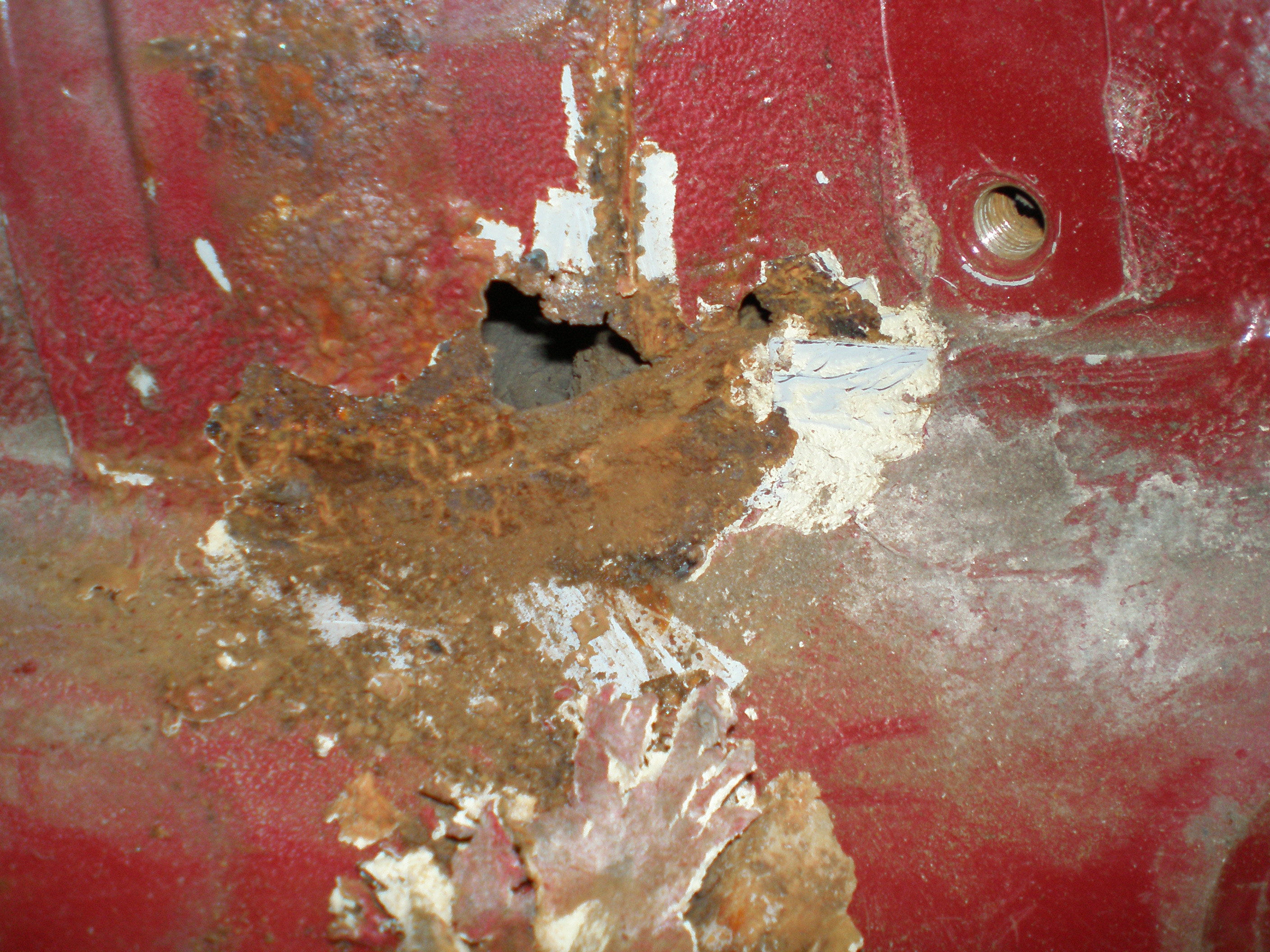

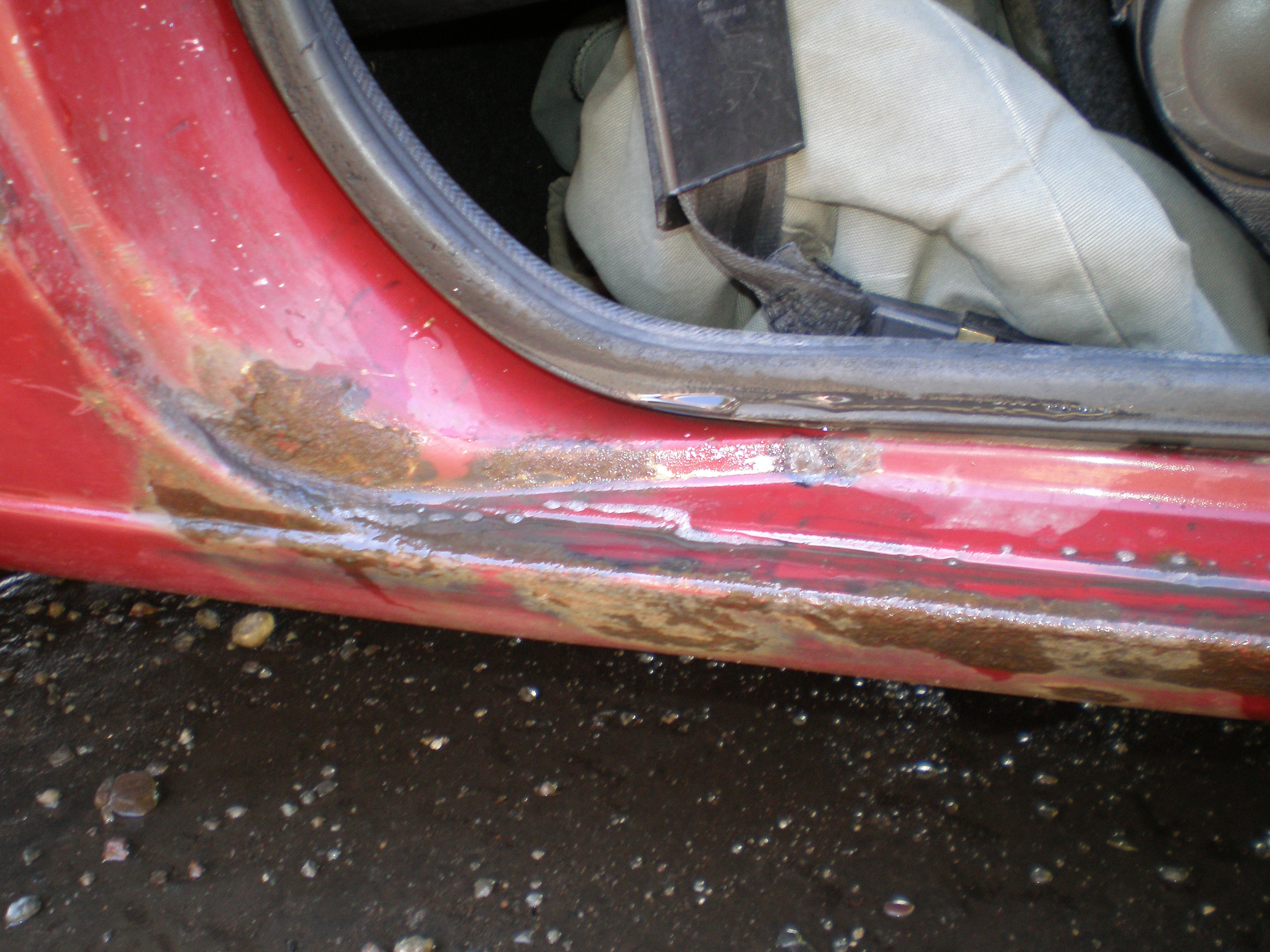

My hunt for rust has sadly had a bit more success, (I should just stop looking really!) it seems that at some stage someone has jacked her up in an unfortunate place which turned into:
"surface" rust has proved to be an adversary, but is getting sternly dealt with

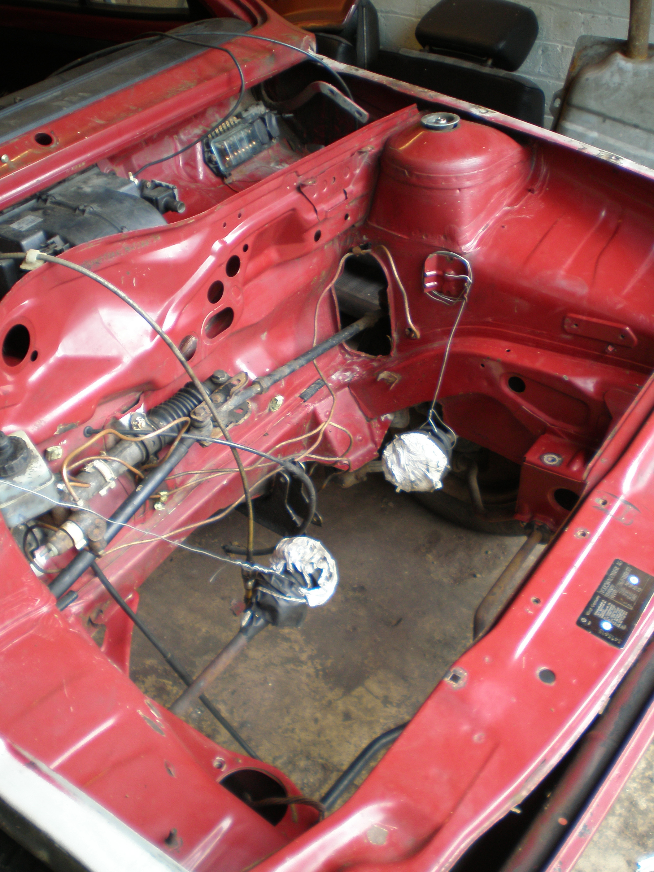

I hired a steam cleaner last weekend to tackle the bay, but in the end it wasn't all it promised to be.
I found that a method suggested on the forum worked much better.
Just get loads of white spirit, brush it into the areas to be cleaned, leave it a sec, then work into it with hot soupy water and a spunge, works a treat.
So even thou it was 40 bucks semi wasted, the steam cleaner was good at getting into the nasty corners. My lady was made happy by having it to valet her car with it!
anyway the bay looked like this once done:
Its not perfect by any stretch but i'll be in there sanding and a wee bit of smoothing so ill give it a proper spotless clean after that.

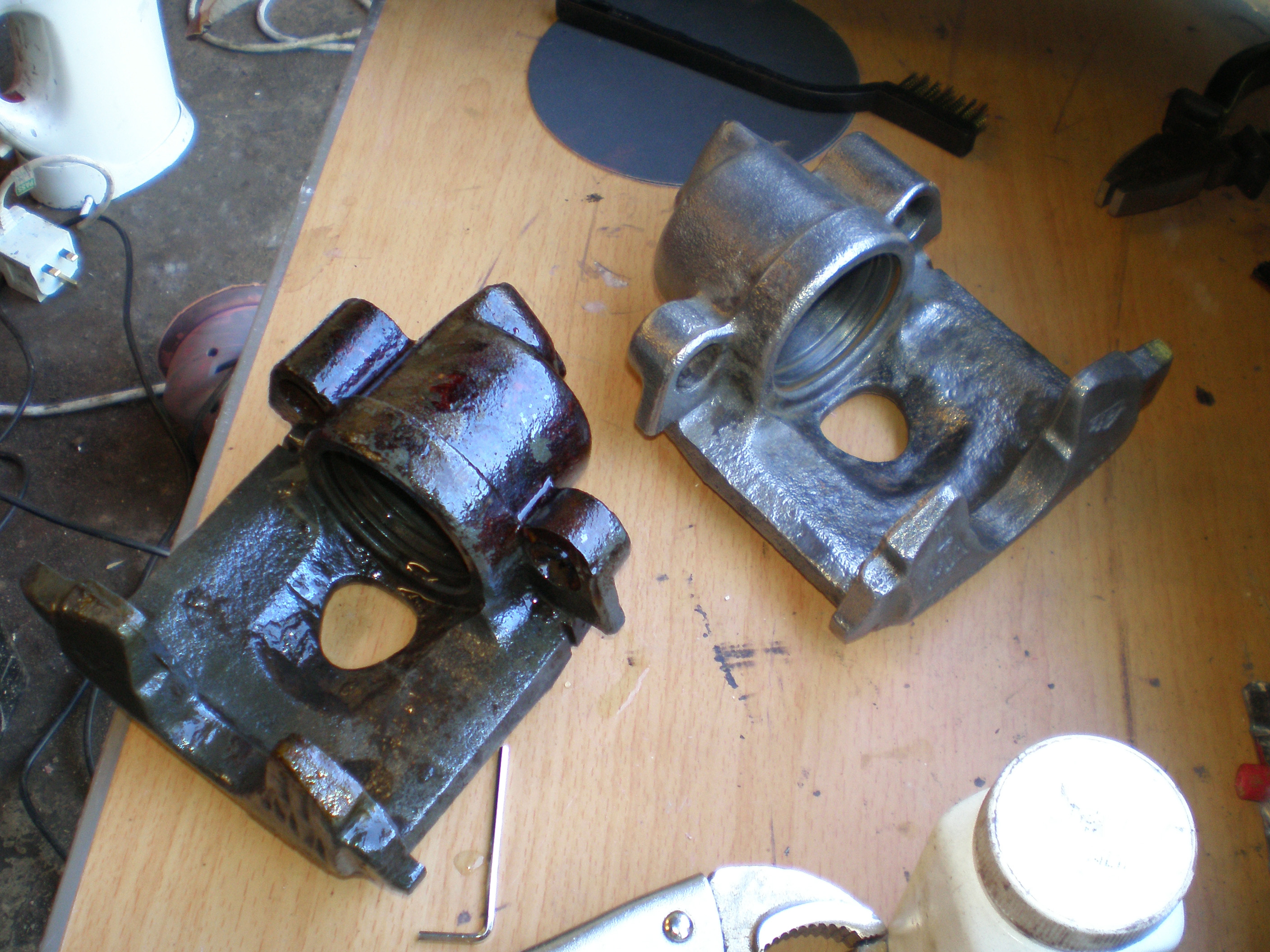

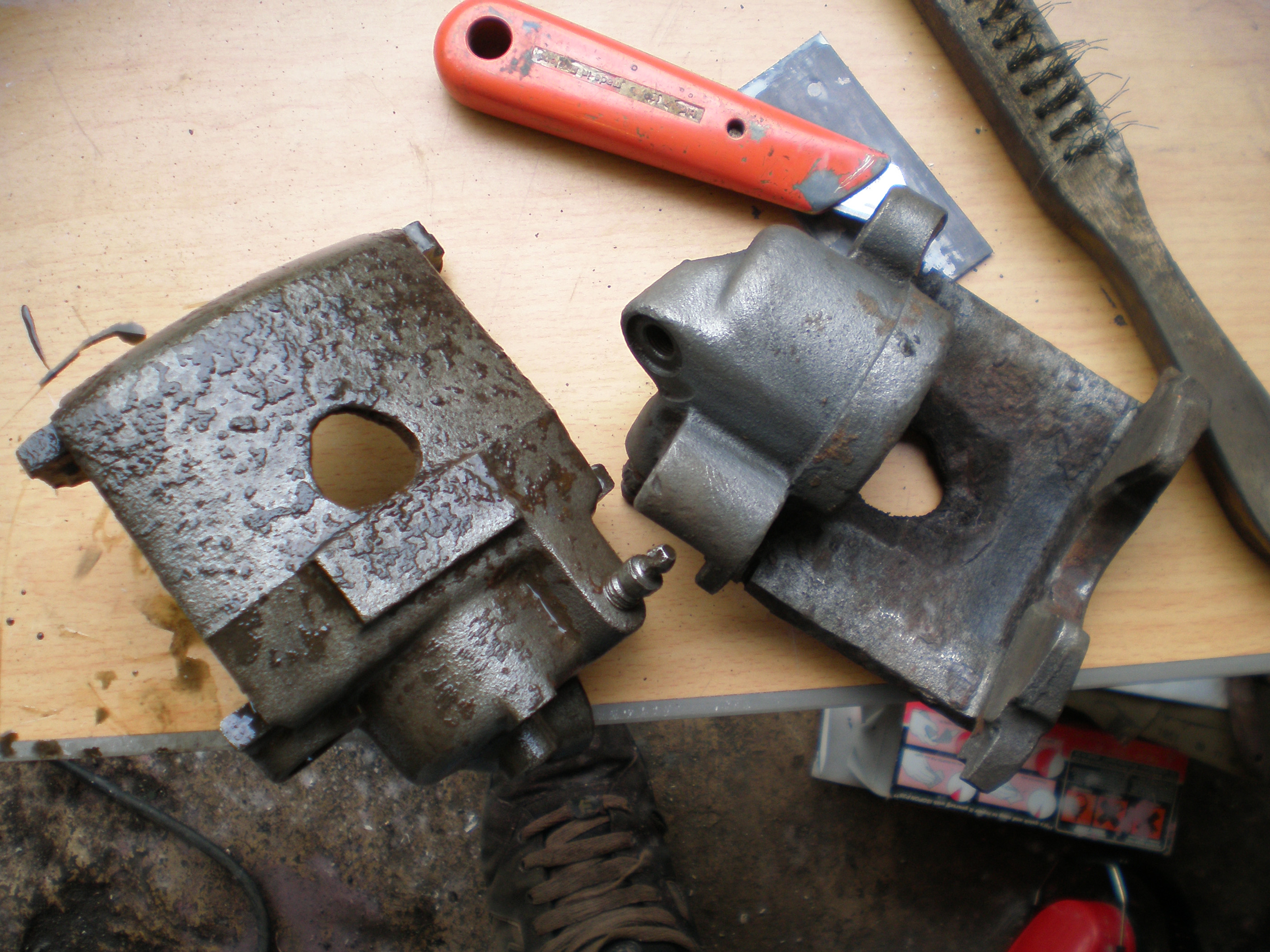

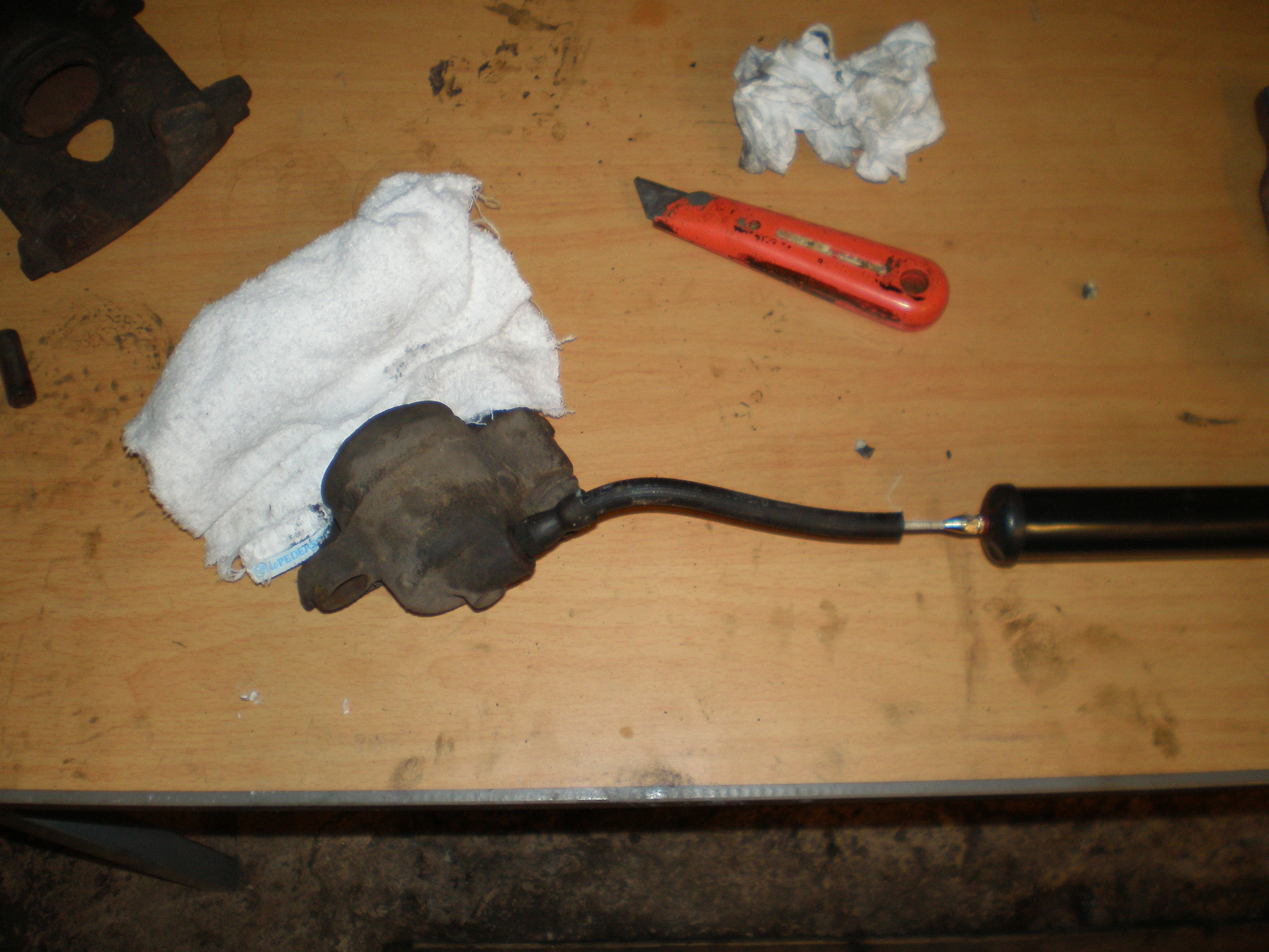

The old calipers are looking better and better, I get them out and give them a quick going over with the wire brush then chuck them back in:
wont be long till they get a seal kit and paint, can anyone suggest a kit? I've been looking on Ebay but can't find one specific for VWII's,

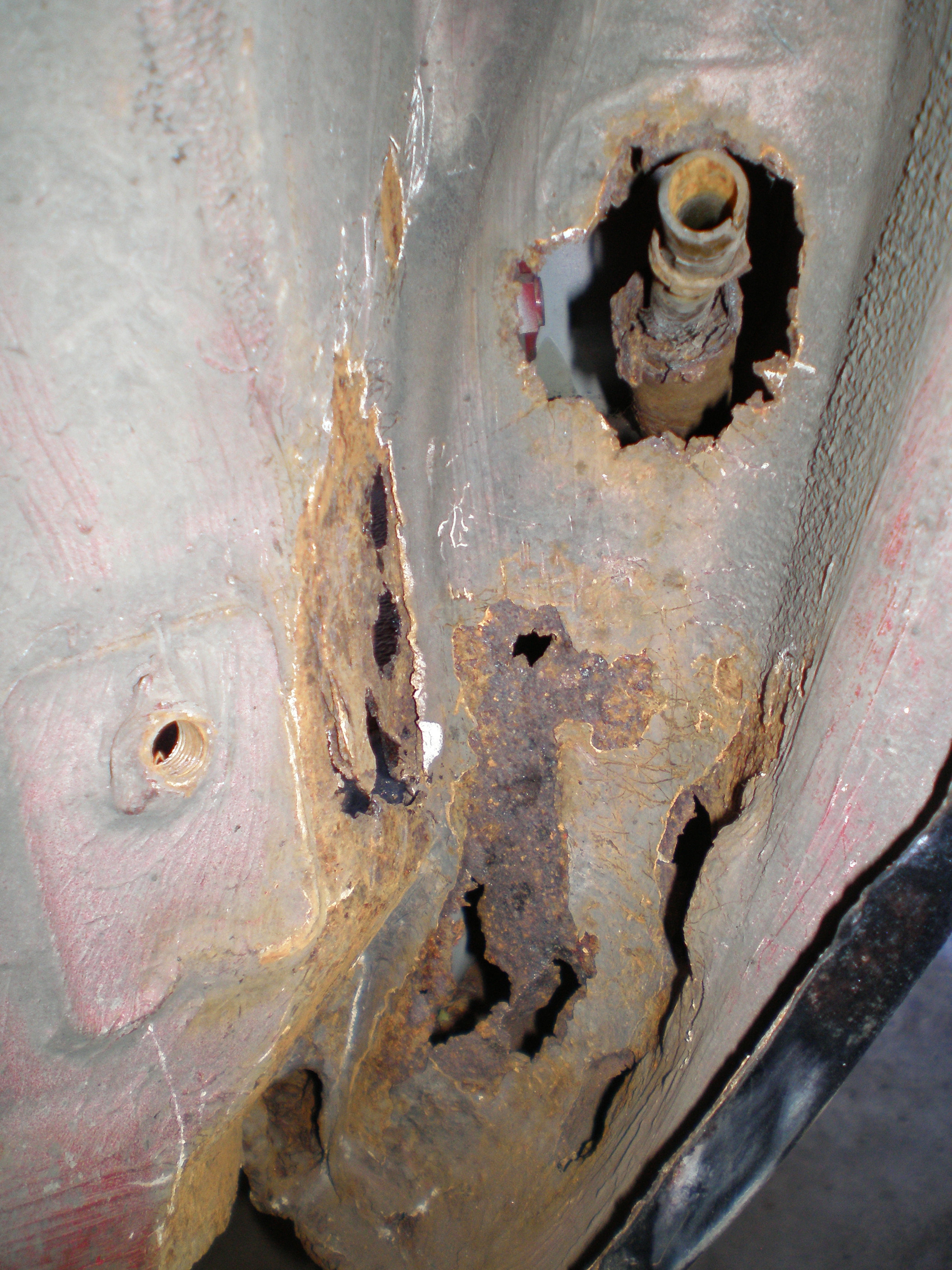

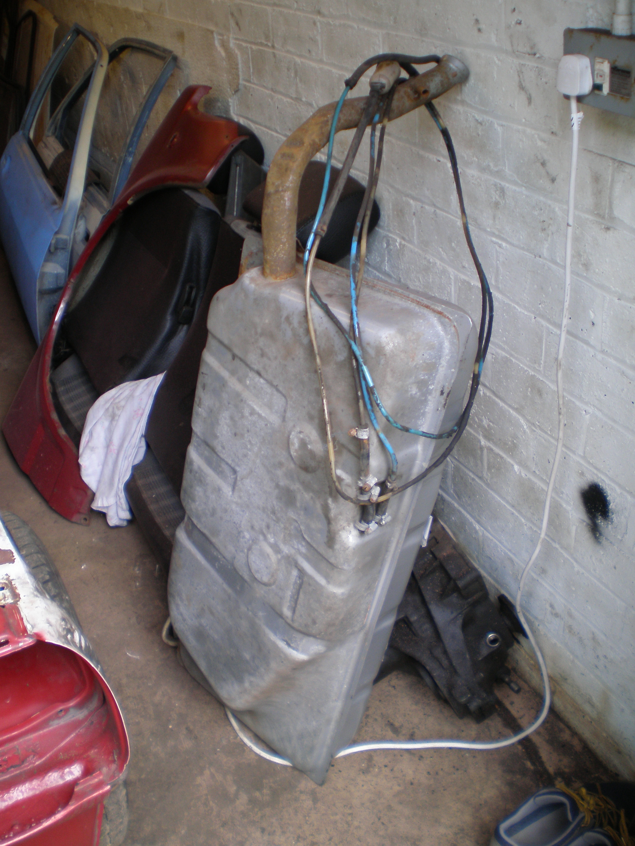

I pulled the fuel tank out the other day, It was a replacement I had put in a few years back so I was glad to see that its in pretty good shape, it'll just need a coat of paint/under seal before it goes back on.
Once the tank was out I could get a clear view of the rot behind the drives side rear wheel arch:
I'm a bit pissed off with the dudes who swapped the tank as there is no way they couldn't have spotted this, even thou it wouldn't have been quite as bad back then.
So there's going to be welding a go go, in the coming weeks.

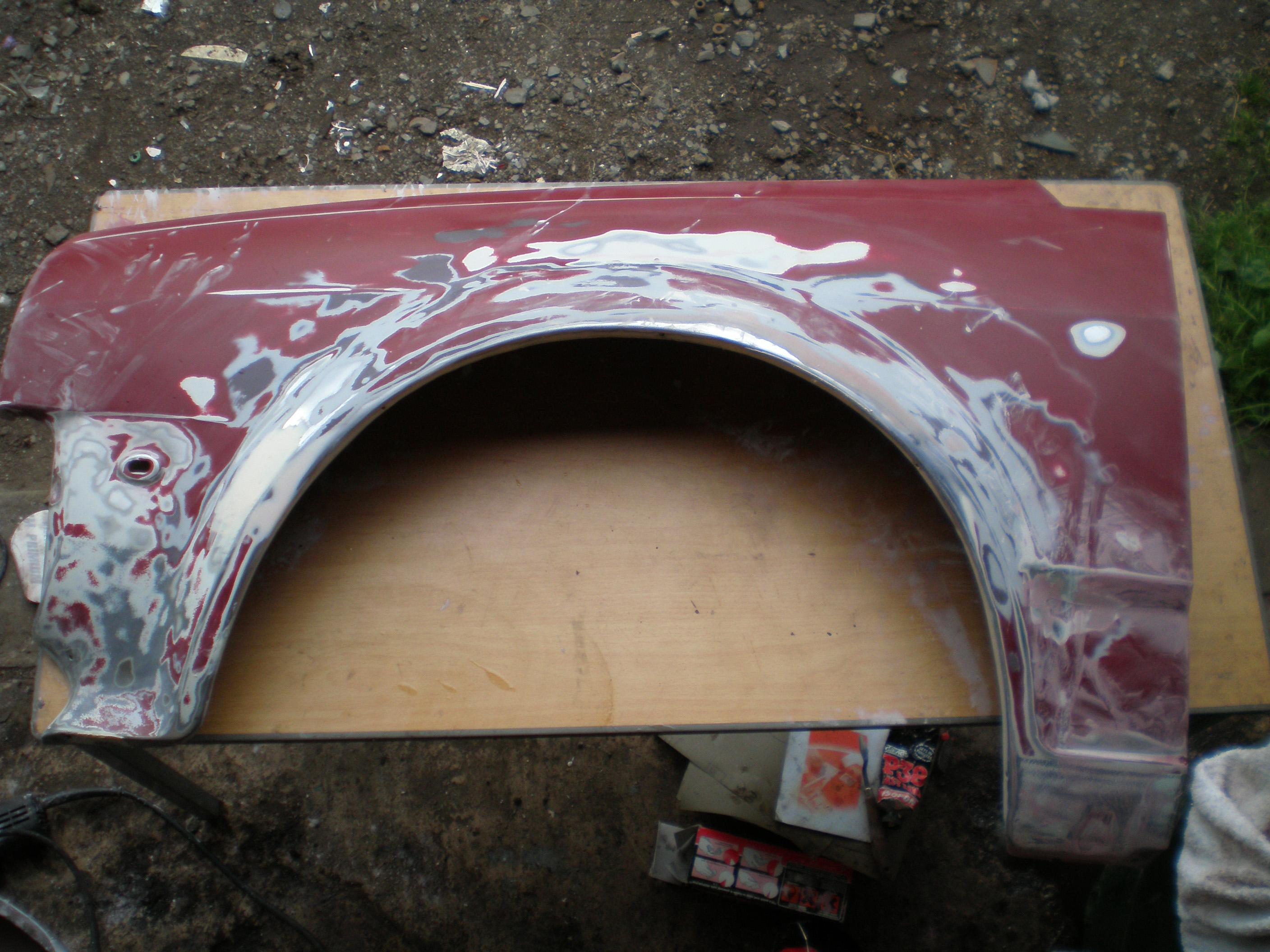

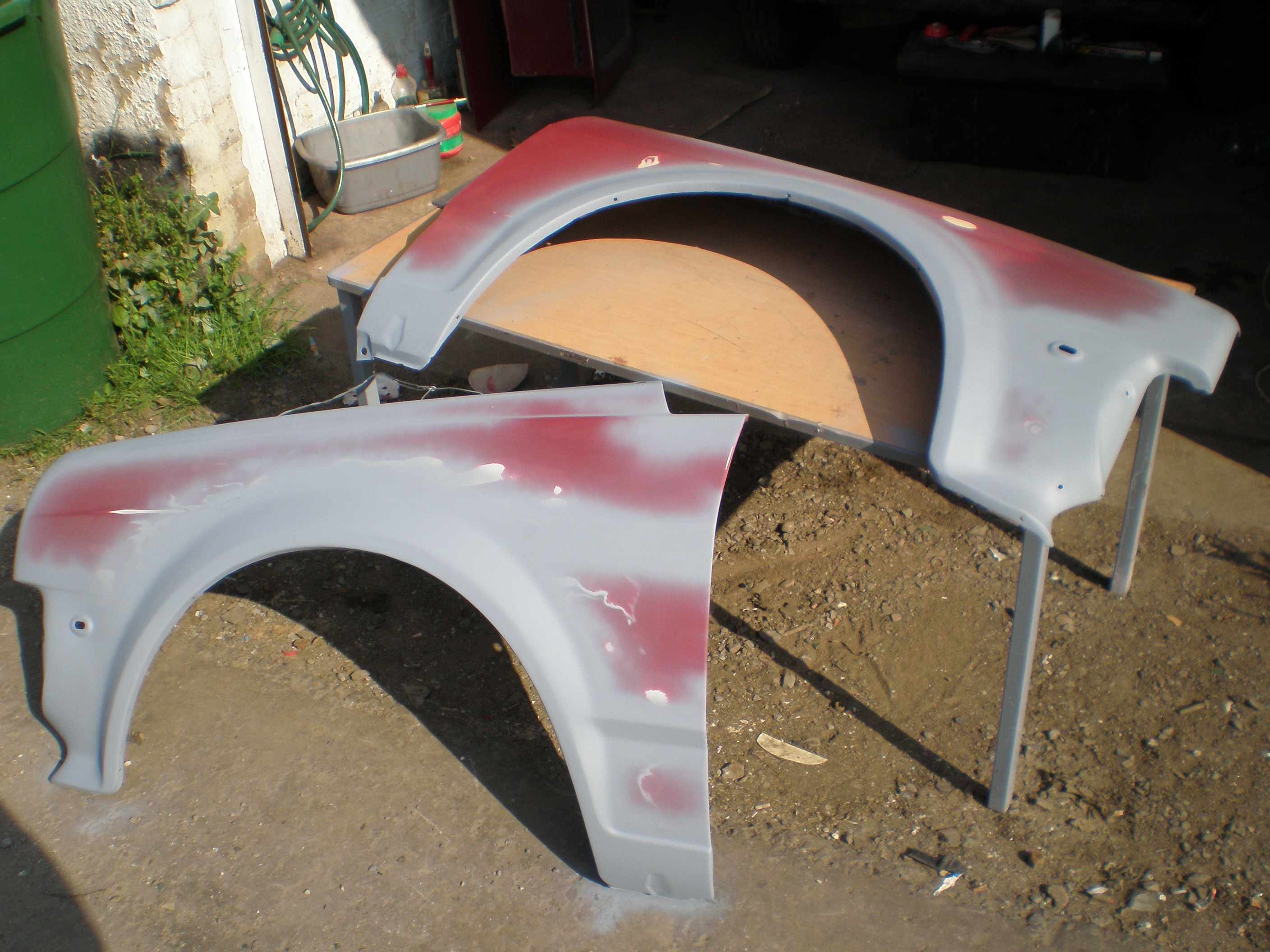

I've waded into the sanding now as well. I've both the wings on the go, its amazing the depth of pain I've found in some areas.
It will be a long dull task to build back up some depth of primer. It would be easy enough to just waft it on and then paint it, but I'm hoping to future proof this car for a good while longer, seeing as I'm getting a full respray.

So I've just been working on the wings some more, there nearly done now,
Question: the small square holes around the arch are only for attaching the plastic arch trim ye? (not the four on the tabs, I know they are four the arch liners)
If so I can fill them over/weld them up, as I don't intend on mounting any trim?

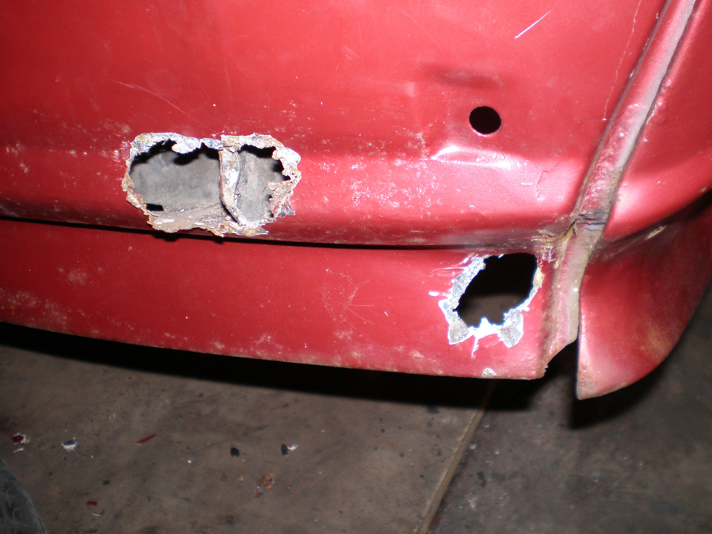

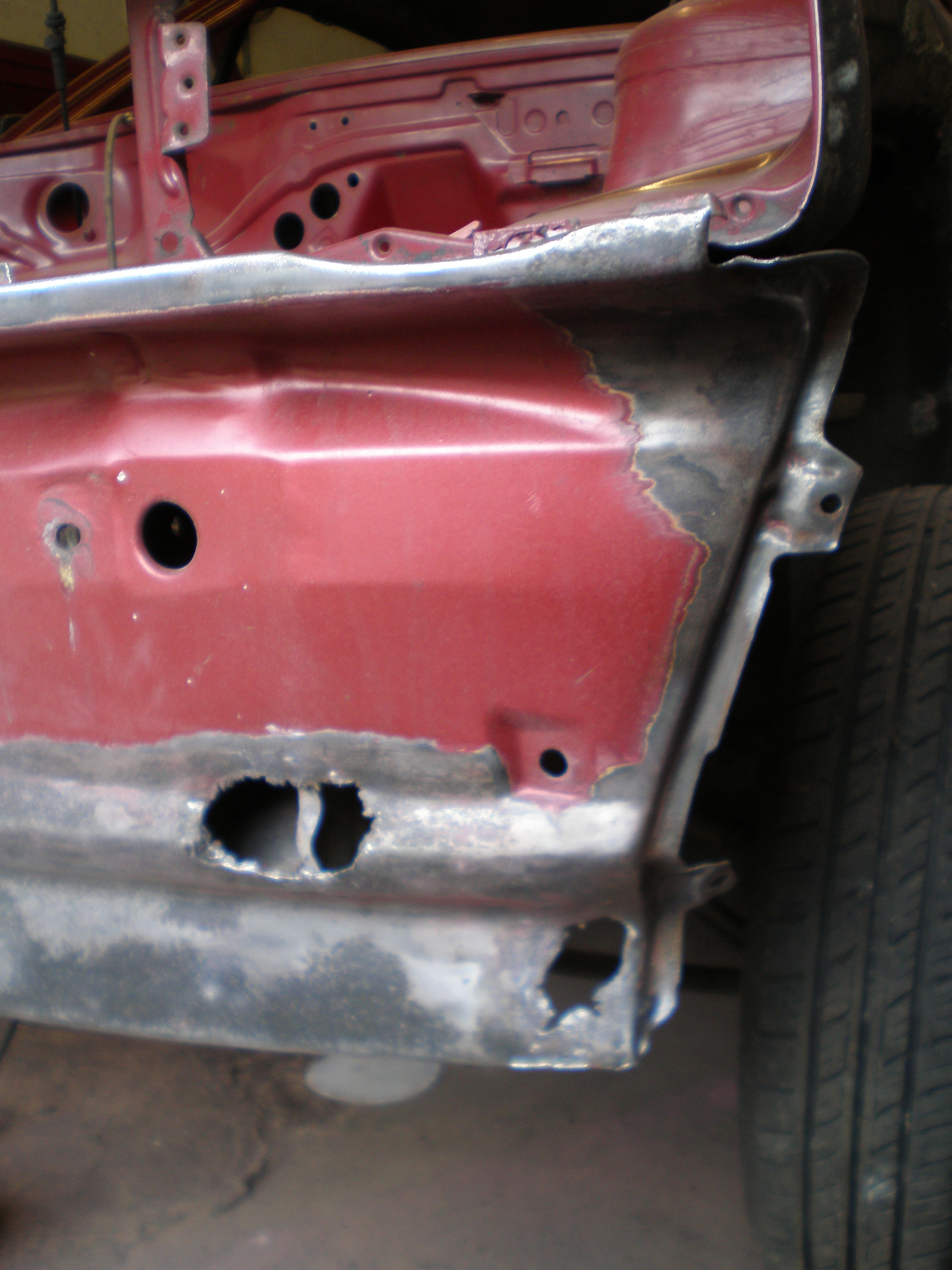

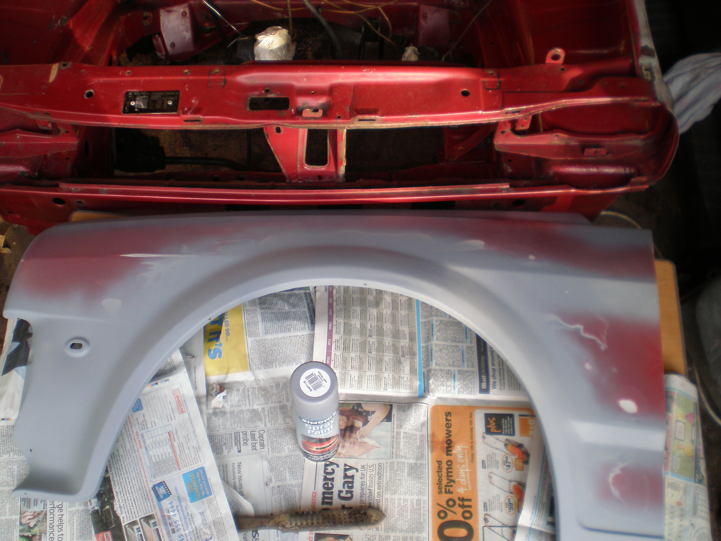

I attacked the front valance/panel (which ever you like to call it)
these were the holes I knew about:
and these ones I wasn't aware of!
it seems that at some stage the panel has been replaced, and either a substandard panel was used, or its just not been sealed in anyway.
So I'm thinking about swapping it out for a better example. On close inspection its only tacked on in a couple of places; mainly where all the rust is, surprise surprise!
If anyone has one of these panels going spare, or knows how I can get an OS one (if it doesn't cost the earth) please let me know asap!
I gave the calipers a final clean, the one on the right is the finished article
If you compare that with how they started out in my first post; /|\ there's allot to be said for Cider Vinegar!

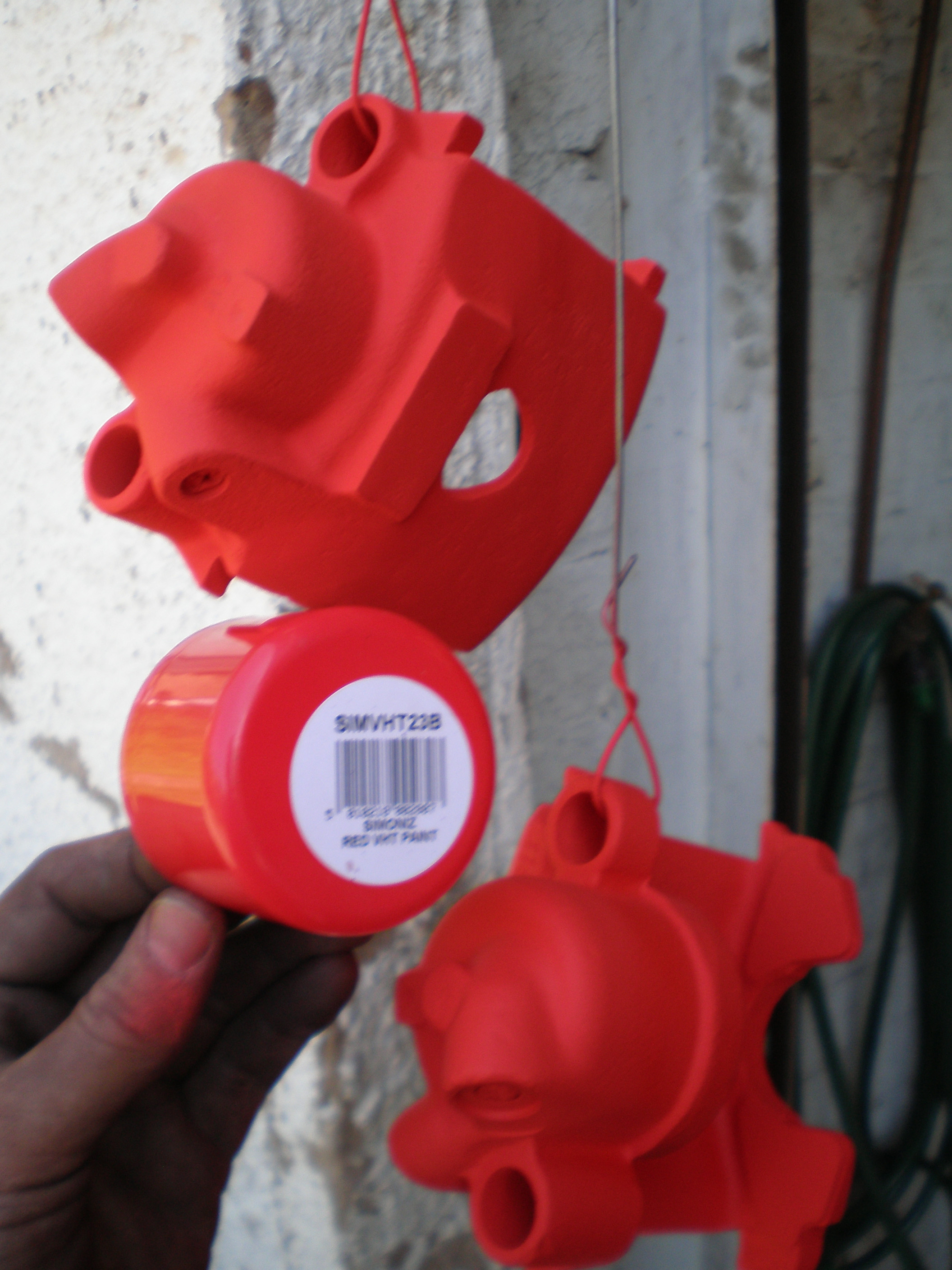

however to round off a fairly disheartening few days, I sprayed the cleaned up calipers with a few coats of High Temp "Red" paint.
Here's a shot next to the lid,
it doesn't show the difference as much as is should, but I'll just say that the lid is the colour of a clowns nose, the calipers however are somewhere between a Salmon/Orange and Luminous Pink!
but it's gona be fine just as an undercoat, I'll pick up some Red High Temp Hammerite this week, and get them sorted.
This is probably what you will find when you clean it all up!!
Hi Mark,
Ye I've been thinking that, it really reminded me of your thread when I found it.
It looks as though the rot has one down the way thou, rather than up in your case.
I had a good poke around in there and the inner arch seems solid for the most part. Just a bit bad at the bottom, its all getting cut out this week so I'll be able to make a no BS assessment then.
It's still a mystery to me why VW never put arch liners in the back? especially over the crud trap that is the filler pipe area,
It probably wont surprise you to know that the same dude who fitted the tank, is the guy who has passed it in its MOT for the last 5 years!
Anyways all fingers and toes crossed for it not to be any worse than it looks!

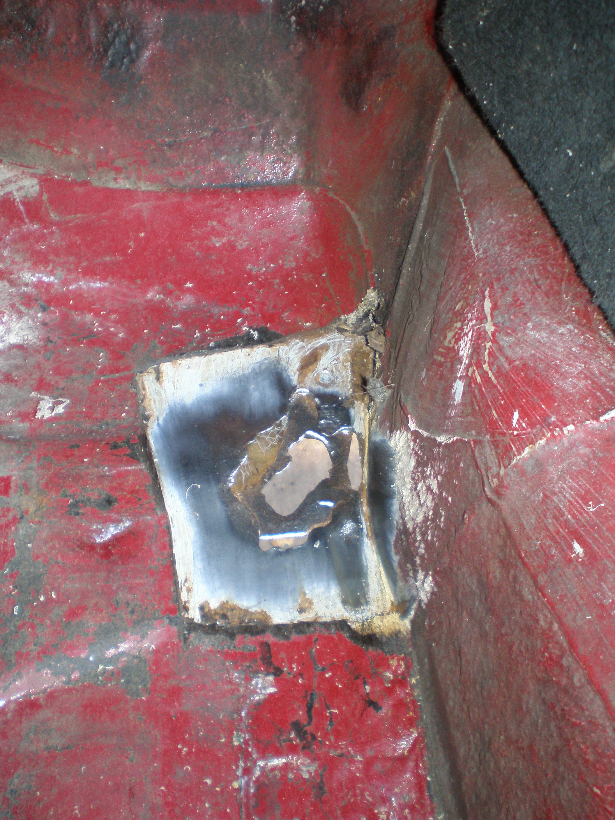

I bit the bullet and started cutting out the rust.
I couldn't get the grinder into the arch space at all, so had to look out the trusty Dremmel, By the way, if you haven't yet invested in one of these yet, then do so, its a life saver.
These two sort out the rust by the seat belt mounting point:
and this is the rather large hole left after i trimmed out the inner arch!
I've recycled the old bonnet into donor metal for all the patches ill be making. So its spirit will live on as other parts of the car!
I spent most of today making up the large patch for the inner arch. It took a while but in the end it fits pretty nicely.
The calipers are finally a respectable shade of red now and a replacement seal kit has arrived in the post.
These are now all lovely and assembled, but i forgot to take a pic.

I cut out all of the old tube, ground down the two welds to leave a clean hole each side of the panels.
The plan will involve a fresh length of tube, two 35mm rubber bungs (with careful holes cut through them), mounting the tube on three 15mm rubber grommets, these will be set into the bungs, and through the arch repair patch. Add a little grease/sealant and it should be fine.
If its all hidden behind a liner, it should be fine.
Ill let you know how it goes.

So, since the cutting has begun, it has continued in a fairly serious manner!
The new front panel arrived in the post - again, you have to love car panels delivered to your door (on the second floor no less)
so the face lift got under way
then I just steamed into it after realising that if i just cut round all the old welds, I could the clean them up far more neatly with the better access.
it was a fun afternoon, my arms looked like I had the measles by the end but all in good fun! :?
I test fitted the new panel as well, should do the job nicely:
I've been in denial about the driver side sill, Its got to go, so the next step is to source some new panels
(Mark am i right in thinking you've had to do this? where were your patches from?)
I've borrowed a smart little Mig welder from a pal and I'm re-teaching myself how to weld.
So hope fully the holes will be closing up as fast as I'm opening them :-)
Yes you are right.. I got 2 replacement sills off eBay. But they were hadrian panels replacements.
(http://hadrian.dominohosting.biz/hadrian/h...ent&Ret=ALL)
They needed work to fit properly as they seem to be over panels as they are designed to fit over the existing sill!
Thanks very much for that Mark,
I've just got off the phone with them, very reasonable prices I have to say.
they even do rear valances, wings, wheel arches, bumpers etc.
The sill is a must have but, I'm going to have to do some serious thinking about whether I patch all the other holes, or just buy replacement panels.
How are they to make fit? do they need much trimming or fiddling to get a satisfactory alignment? is the steel better or worse than the original?
