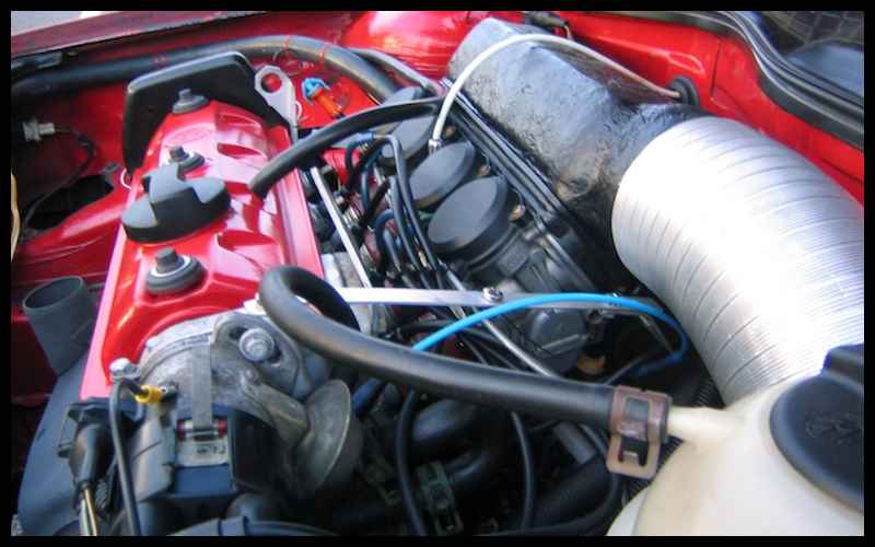

Running ZZR600 Carbs along with a custom made Fiberglass airbox for the carbs

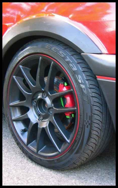

Brakes: G40 Brakes with Green Stuff Pads
Wheels and Tyres: 15" Black alloys with kumho Sport tyres all round

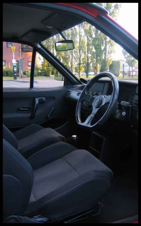

Interior Styling: MK4 Golf seats
GT revcounter clocks and a Sporty steering wheel

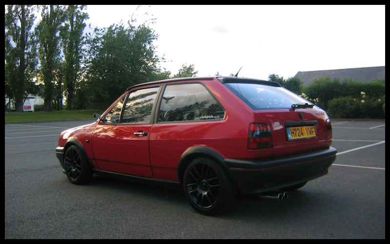

I bought this car at the weekend (27/06/2011) and its my first car, what a beauty it is i'll upload some photo's to show you all what she looks like, it needs a bit of work of work the bonnet has been painted by hand and some point and is flaking off quite badly and the same as the wings... they haven't quite be aligned properly but that'll all be sorted. There are a few dents here and there but i've got someone coming out to remove them as i can't find the time this week to sort them and i'm away at College on block release so i'm gonna have them done and i'm going to have the car put in for a paint job(respray) hopefully the entire car but might just be the wings and bonnet for now. i haven't got a camera to take photos of my own and upload them just the photo's the seller sent me. There is also some rust on the bottom of the drivers door and part of it missing on the underside that needs sorting but looks like the door will need to be replaced urgh i can't find one atm but will do soon.

Massive love for this! That interior is bang on! Did the front and rear seats require much modification? So sweet!
Honestly I haven't a clue it came like that most of the hard works been done for me ;) but i've had a look and it doesn't look too bad to do to be honest, they fit in pretty easy from what i can tell, but i can't say for definite as soon as i whip everything out of it i'll let you know!
Awesome dude! yeah no worries :) enjoy it!

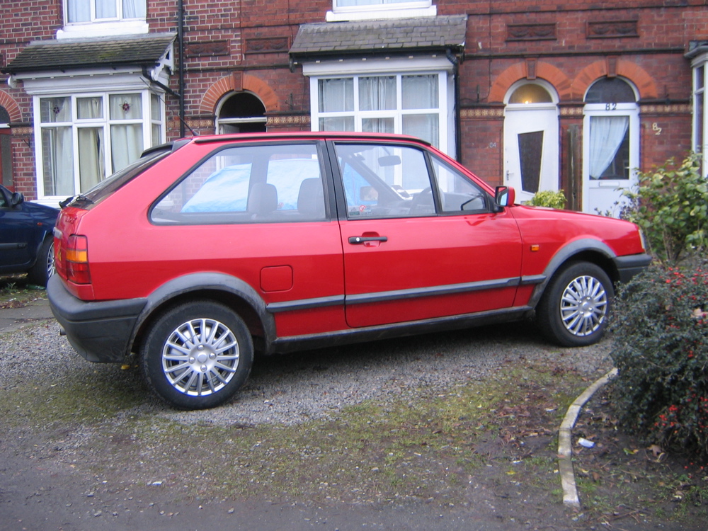

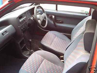

So today the guy i bought the car off sent me an email with loads of info in bloody helpful guy! but he sent me some pics aswell of the car before it'd been changed so i thought i'd share them too,

how do the carbs sound through an airbox like that?
i just have a pipercross dome filter over all 4 so i just get the raw noise but i imagine that would change the note completely?!?!
They sound pretty amazing mate, i'll be honest i get more exhaust and road noise when i'm in the car than i do carbs aha, but it does sound pretty good! i wouldn't know where to begin or compare sounds it's my first car don't know much about them aha, i'm using my knowledge bank (my dad ;) ) I imagine yours sounds a hell of a lot louder thn mine, i would take the box off but the carbs mixture would mess up and it's set up to run with no problems in winter, so i'll leave it

loving the airbox mate! thinking of doing one for mine, just to quieten it down a bit and hide the carbs a bit more lol
