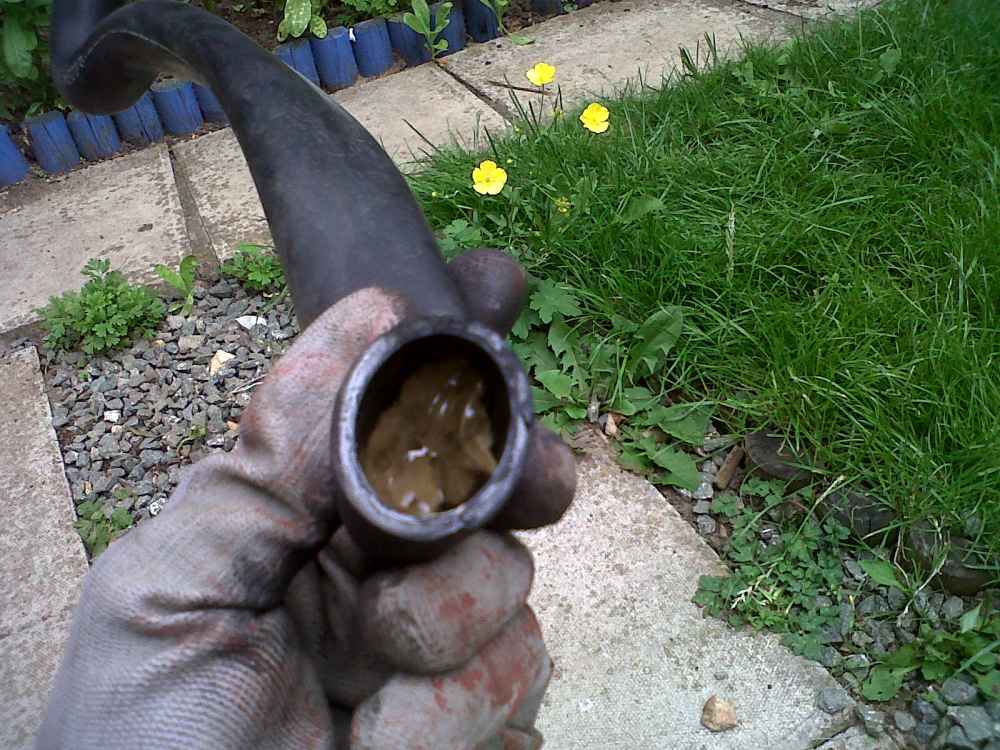

just took the pipe out its full of gunk is this normall
its normal-ish , mine was like that not as bad, just years worth of crap building up mate, give it a clean and see how it goes
Quite a bit of gunk in there mate. i cant say as i haven't heard of it before but I'm sure if it isnt able to release pressure through the breather it will build up and probably cause whats happened in your case.
its all cleaned out now ill trial and error it for a few days and get the filter for it thanks for you are help guys.
