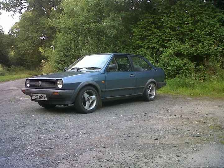

hi I'm new to vw so this should be interesting. i bought a mk2 saloon the other day for £900 of a mate (matt way)
spec:
afh with bikes carbs
2.5 inch exhaust, down pipe to the back
lowered 40mm all round

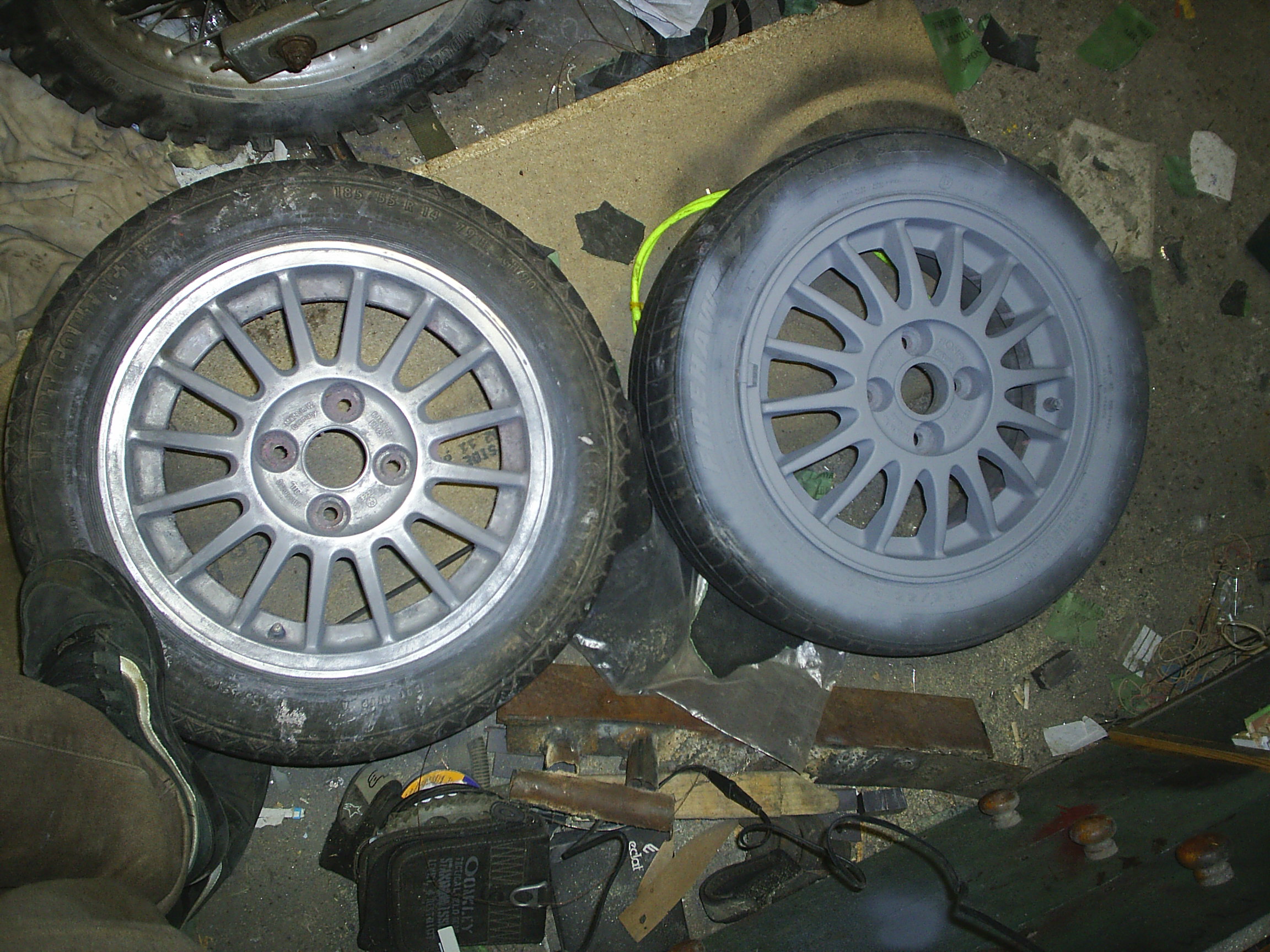

started refurbing ronal wheels

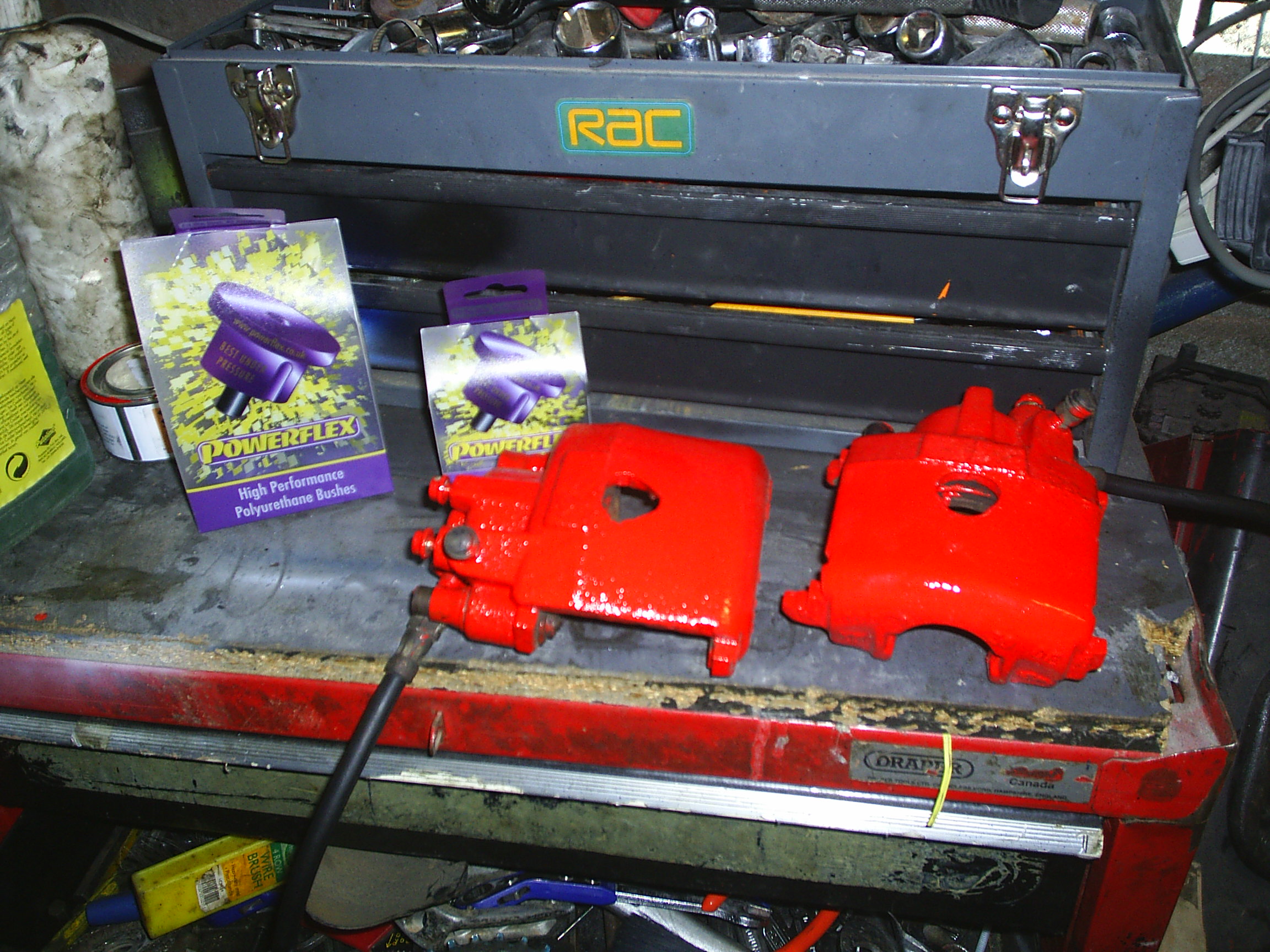

cleaned up and painted some g40 calipers ready for some new discs

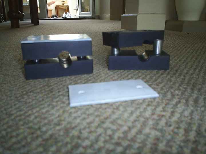

with the tinted lights and below is the arb blocks i made

little update, 1 wheel primered :) god mutli spoke wheel are a pain in the ass to strip down
also g40 caliper and poly bushes for the tca's

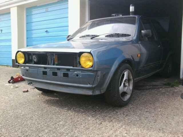

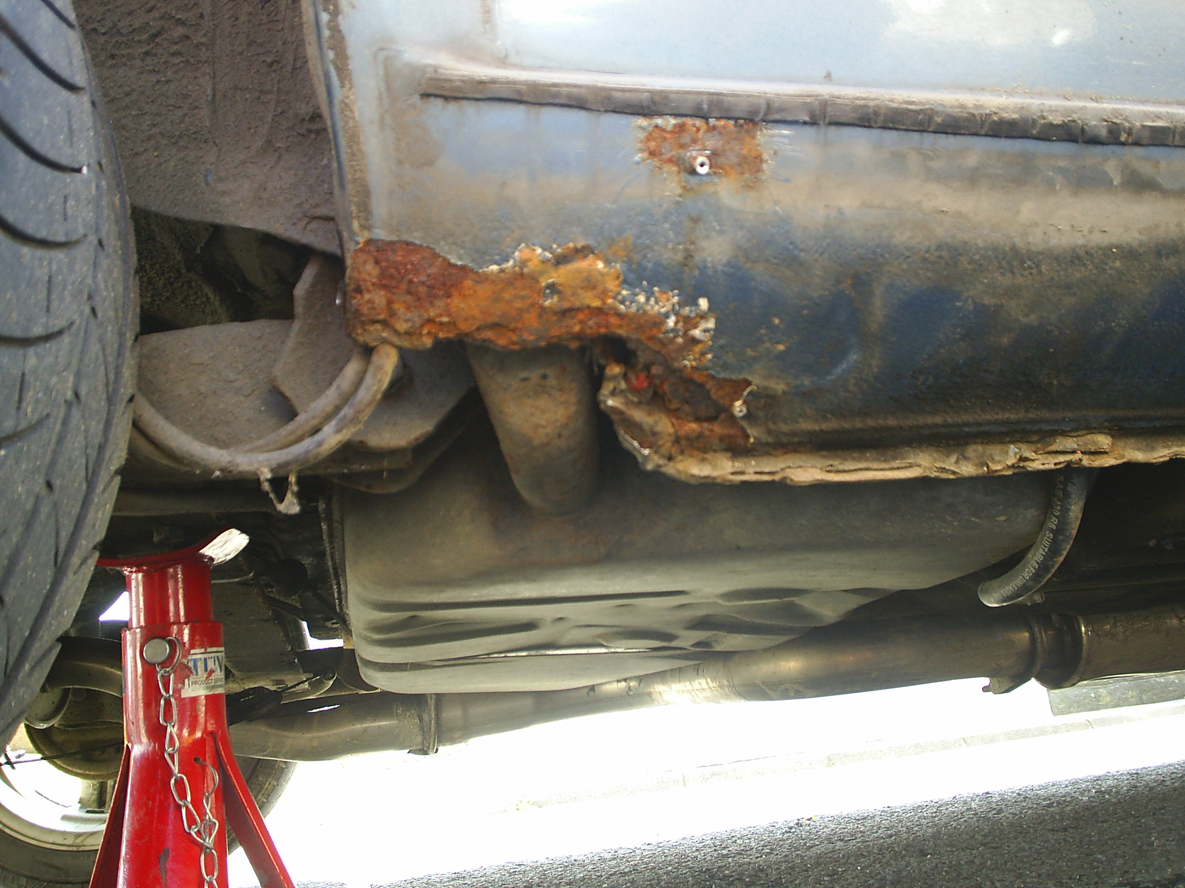

got al the plastic trim off 2day and dint reali find much rust, jus a bit of rot at the rear of the o/s sill and sum surface rust on the n/s rear sill and few spots on front arch. all in all pritty pleased :)
few pics ill get shots of the rot/rust in the morning
You know it looks badass with no bumpers leave them off :D

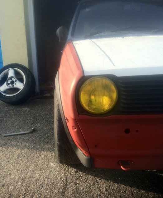

all bumpers n trim going back on once sprayed up matt black
not sure on colour yet maybe oxide red :)

chopped out the rot in the sill...CAN SOME ONE PLEASE SEND ME A PIC OF A NORMAL DRIVERS SIDE SILL? I'm not sure on the original shape s the fuel pipe is there

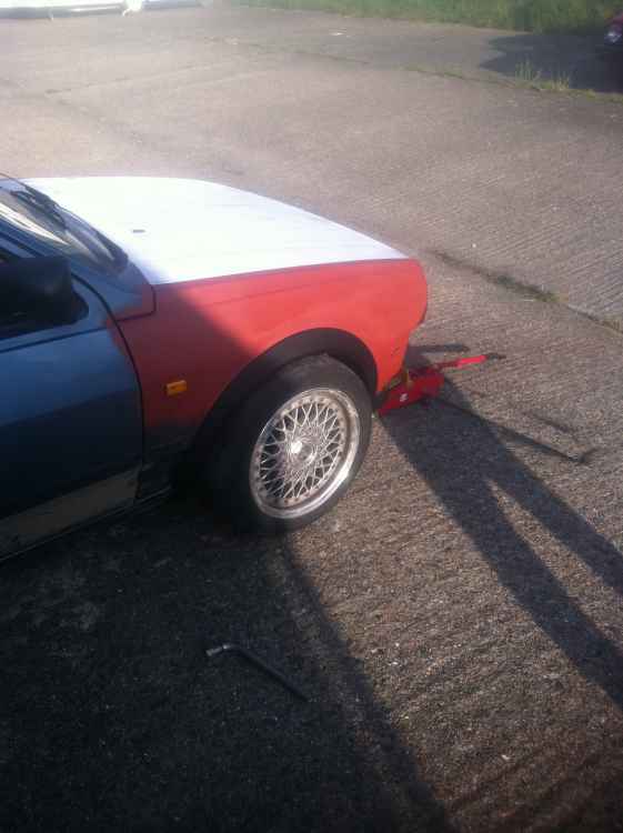

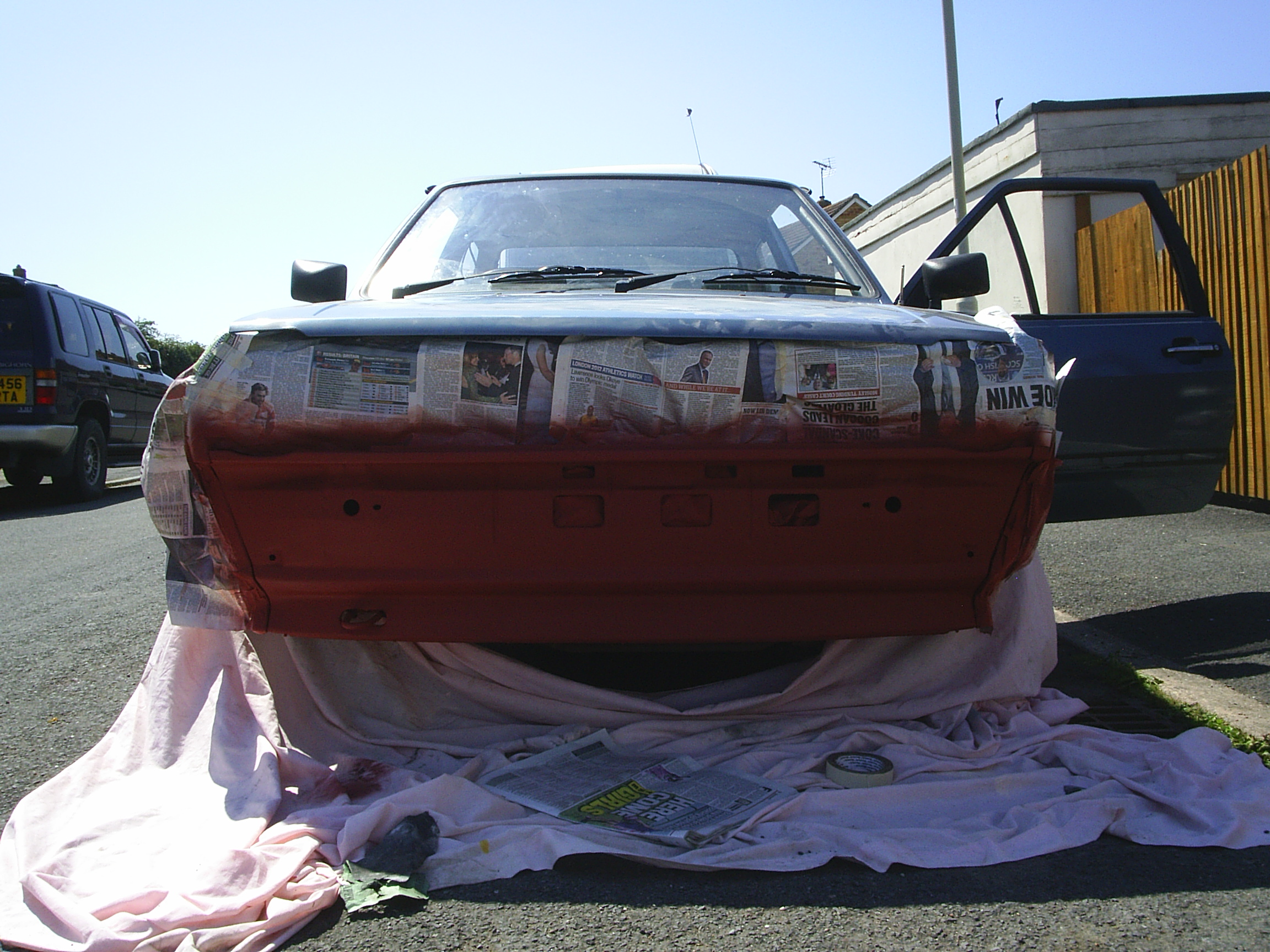

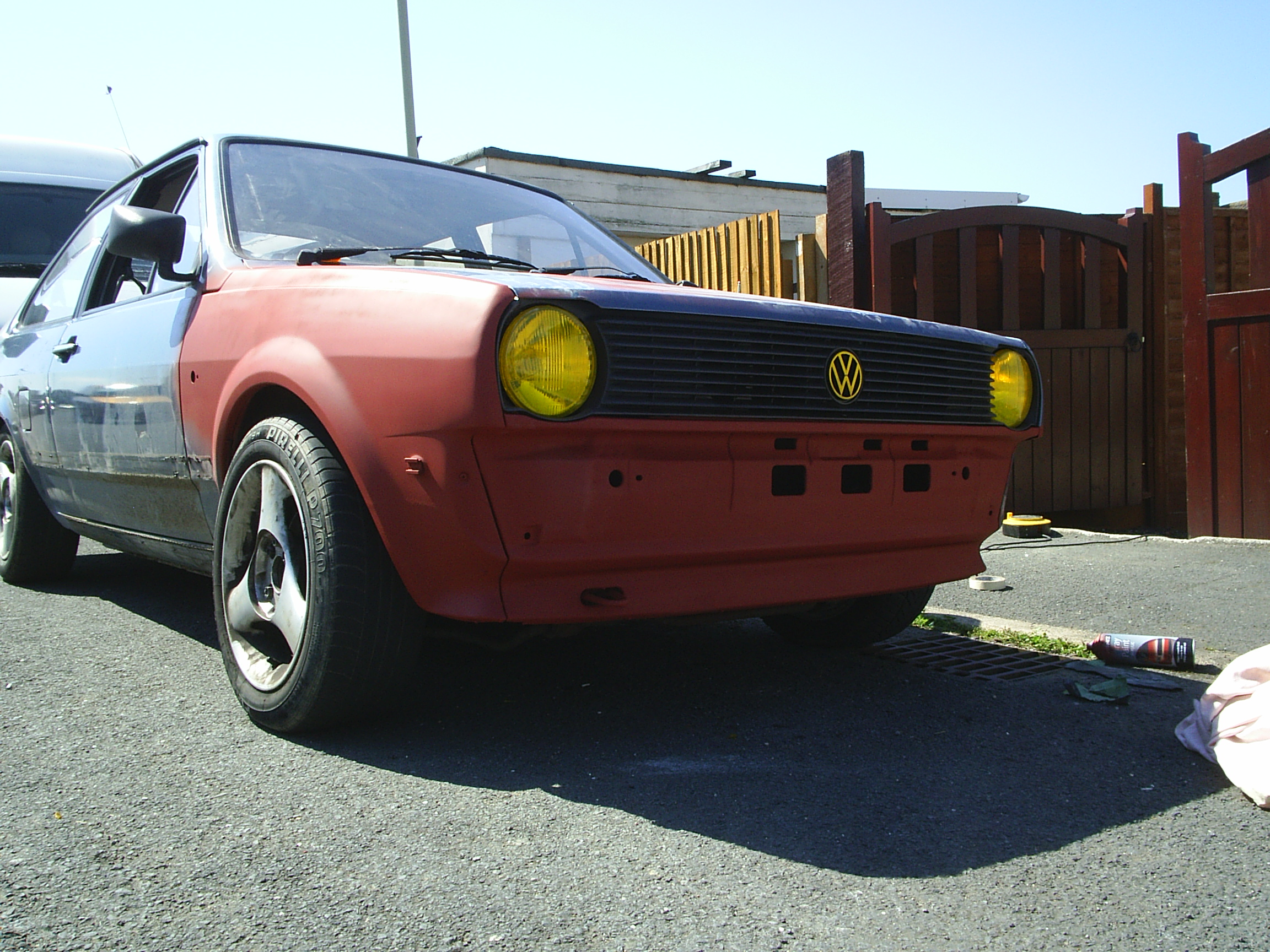

took the spoiler off (will be for sale)and started spraying the car oxide red :) reali glad i am now, looks mint imo

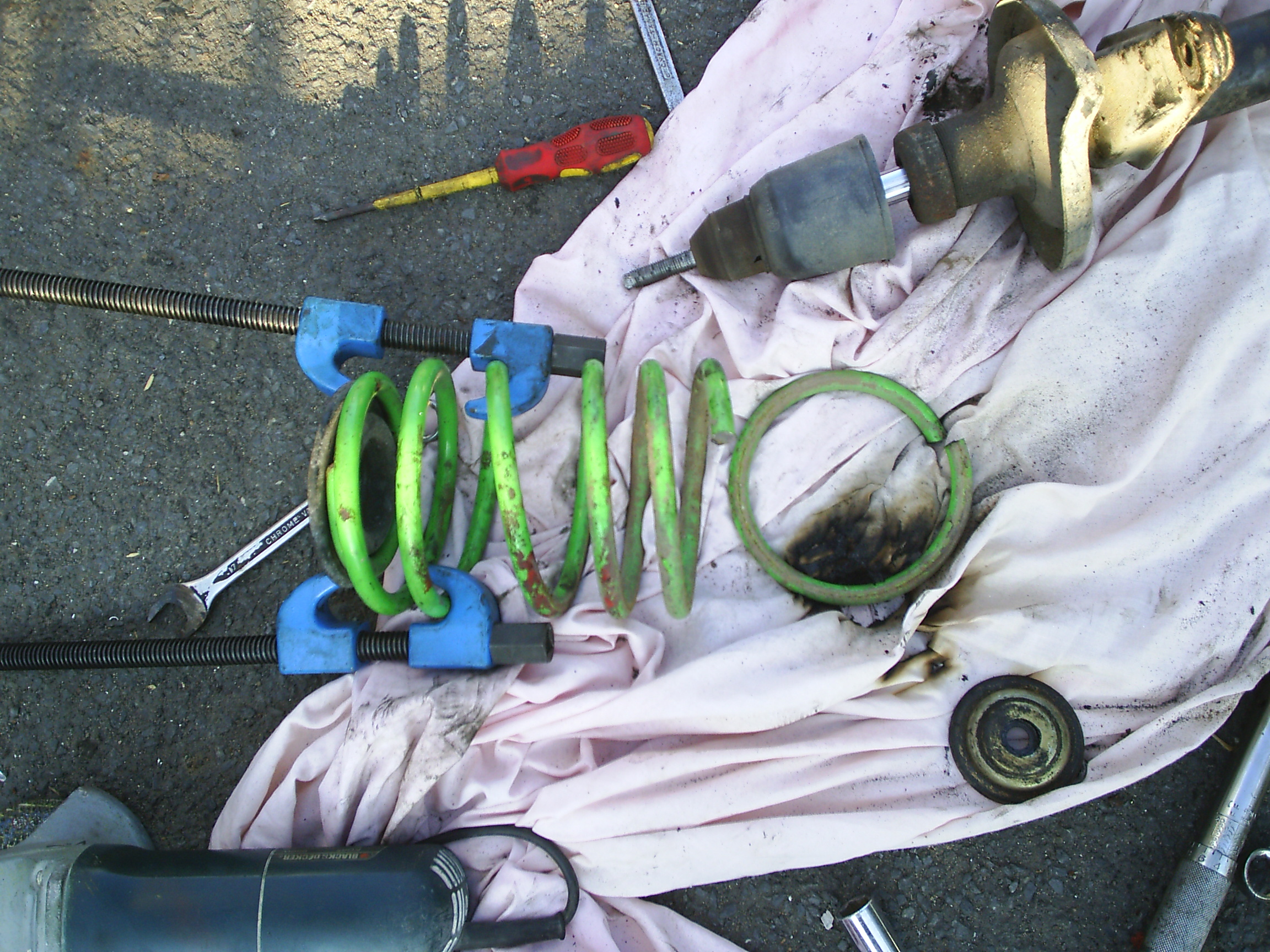

choped a coil off the front spring (40mm lowering springs b4) but it still looks the same at the mo
As you can see matt set fire to the sheet from grinder sparks :lol::lol::lol:

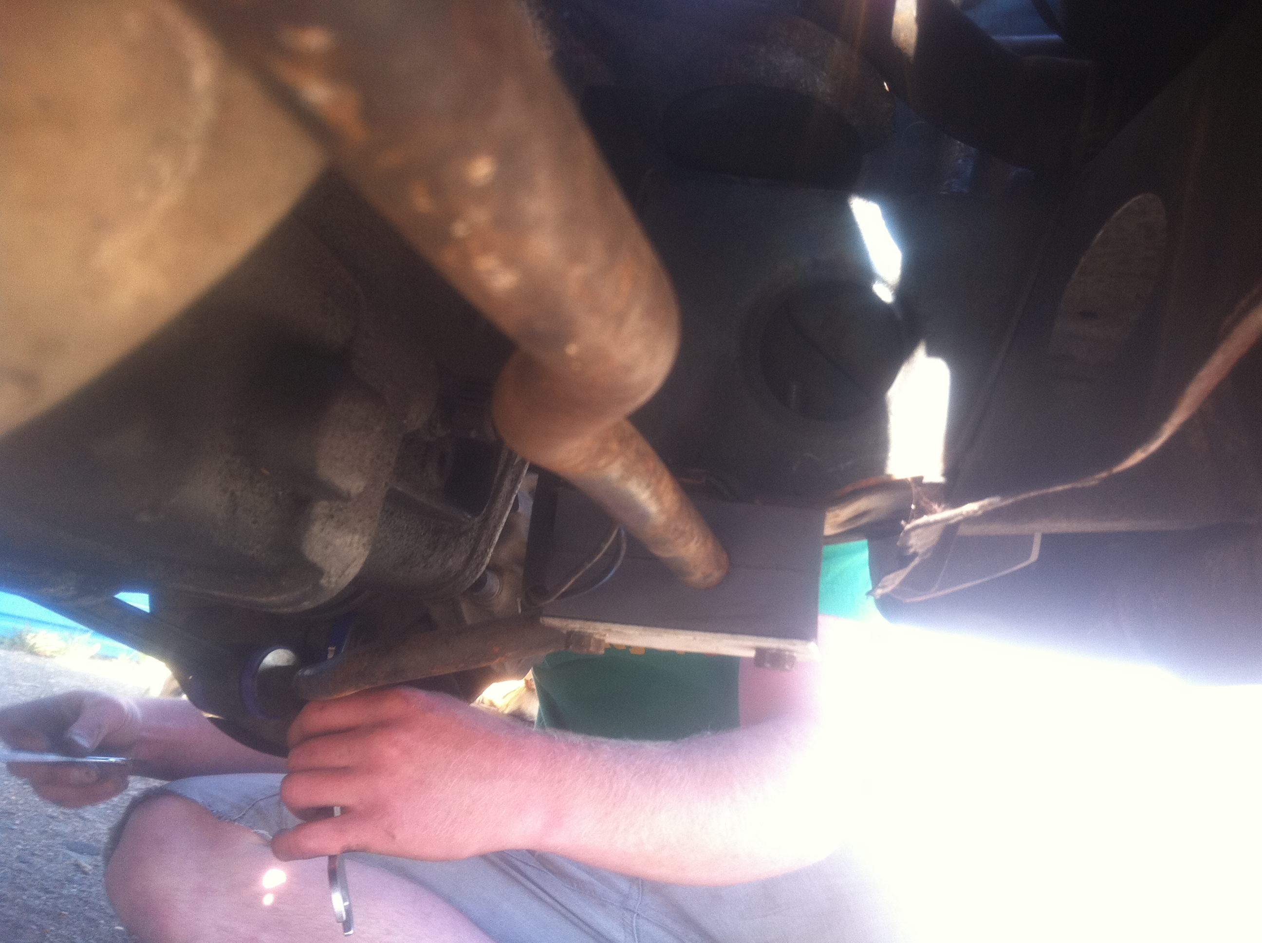

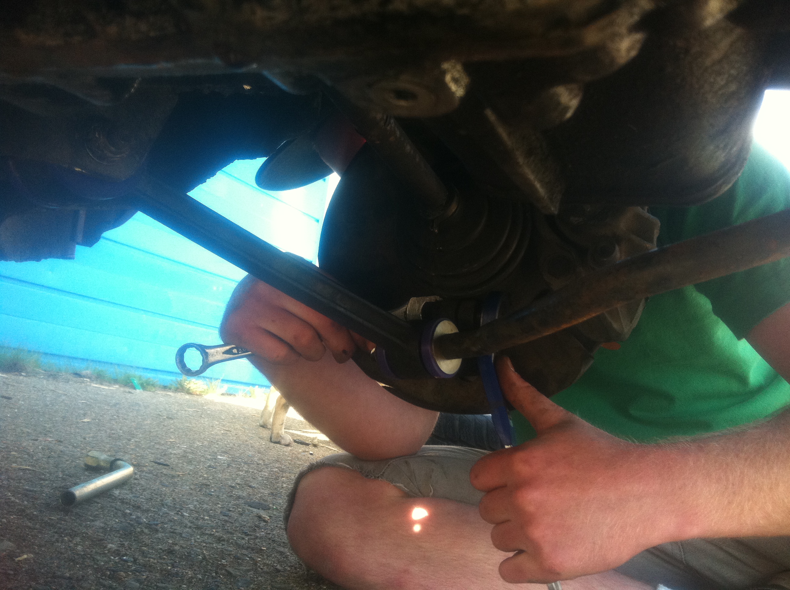

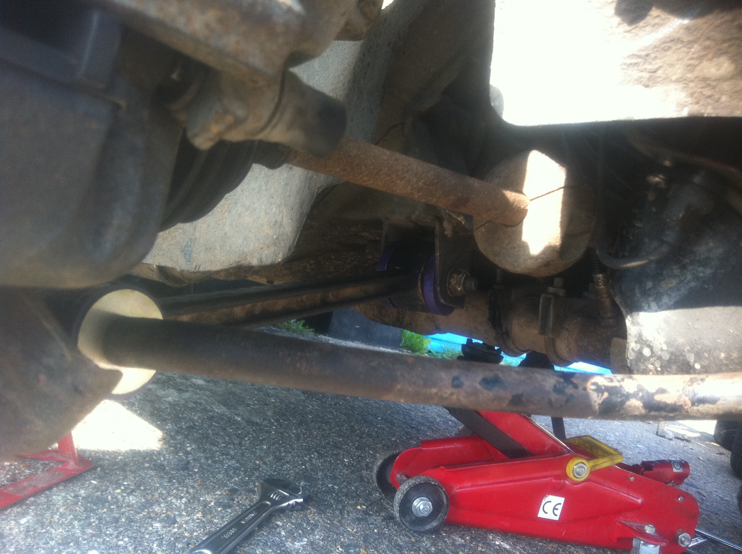

fitted the tca poly bush's and arb blocks (wheel is now in the right place lol)
think my arb was bent aswell so fitted a 4speed one (which i was told wont fit but it fits fine :/)

plated and welded the driverside sill...rust free sill :)

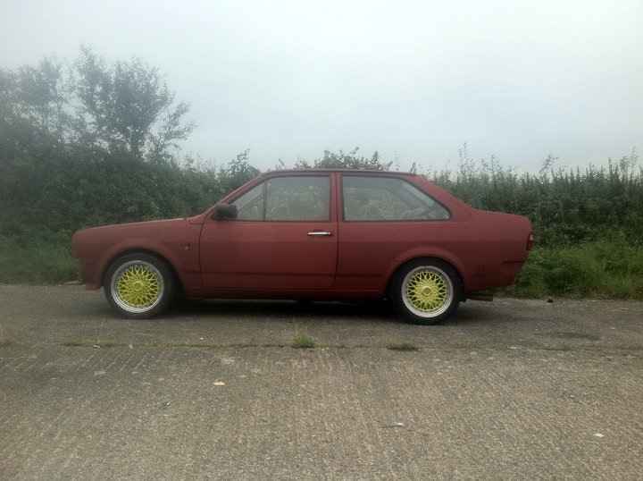

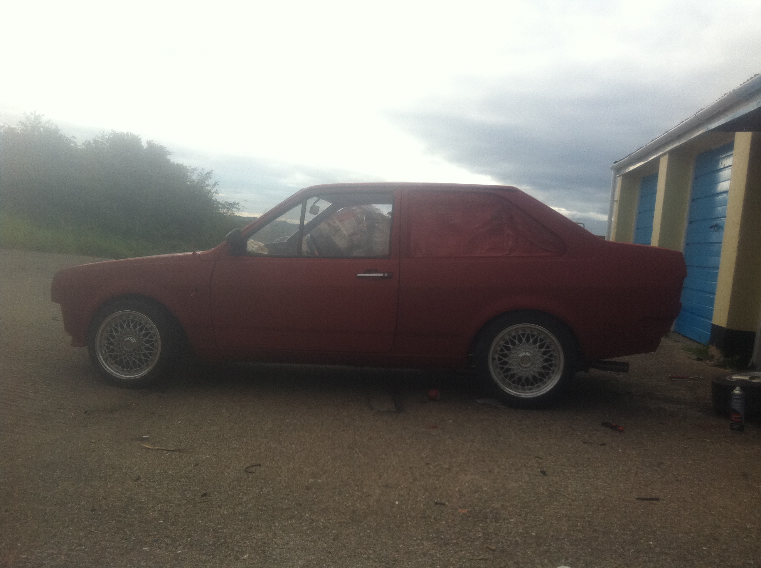

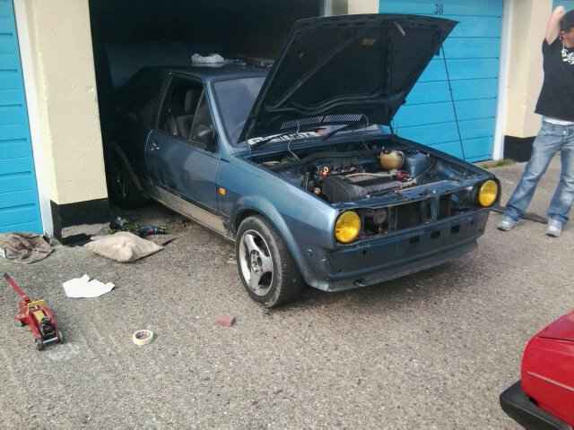

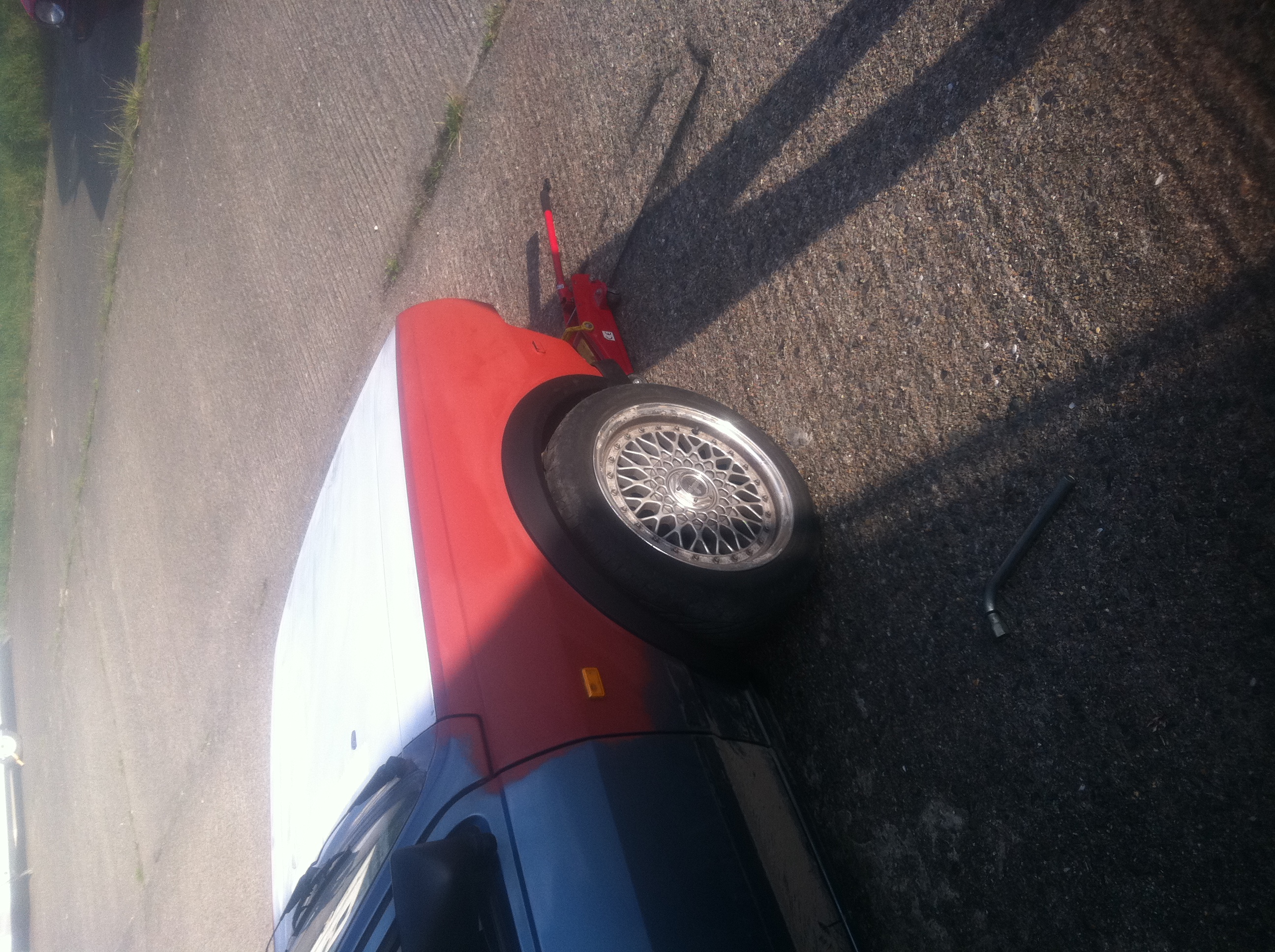

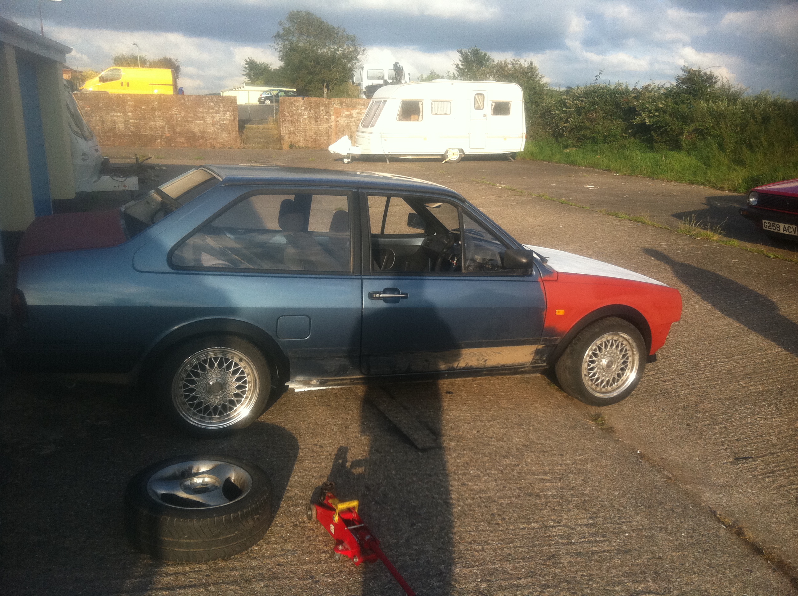

Over the past few weeks iv managed to get it al sprayed up oxide red :) i bought a tub of oxide primer to use in a gun with compressor but i done the door and even with thinners and fiddling with the gun it still dint give a very good finish so i decided to do it with rattle cans and i must say I'm quite pleased with it. Also got the weldin finished off.
And for future referance... No a 4 speed arb wont fit properly, i thought it was okay but it slightly hits/rubs the end of the gearbox :( so i measured up the old 1 and it seems okay still so painted it up ready for re-trial of fitting this week.

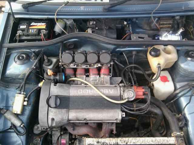

Also bren lookin into what to do engine wise and I'm defo going for 1.6 bottom end with 1.4 head and custom itb's usin the body of what i think r gsxr itb's with megasquirt ecu
Also got a set off lenso wheels that I'm cleaning up atm, not sure on centre colour yet tho....any sugestions welcome. I'm likin gold or white atm
Have got some nylon and ali engine mounts and rear beam bush's in the works atm should be done in few days
Anyway heres some pics
Edited by loon27

crop them in paint mate :D looks great on them lenso's, wasent holding much hope when you said you'd bought some but i like it! 185's on the back and 165's on the front maybe? ;)
Is the yellow just a photoshop or is that how they are?
Not feeling the red oxide, probably because half of my car is in red oxide and i hate it :-(
You should go with motorsport theme dude, would look epic with it being a loon!
Love it. Looks great on the lensos.
I email the photos on my iPhone to myself. That way it asks you if you want to resize it when you email. Large works fine for forum purposes.
