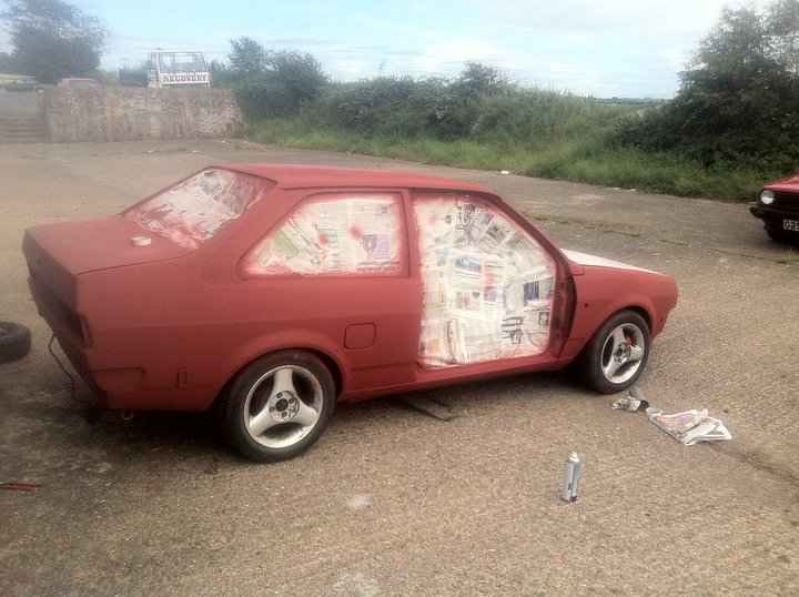

matts mk2 afh oxide red saloon
Loving the lenso's, what size are they?
  • Replies 47
  • Views 5.6k
crop them in paint mate :D looks great on them lenso's, wasent holding much hope when you said you'd bought some but i like it! 185's on the back and 165's on the front maybe? ;)

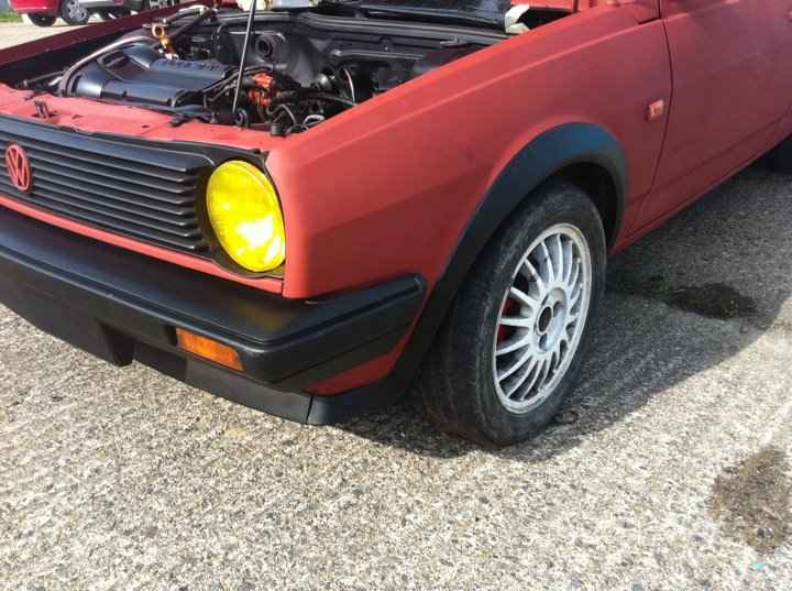

Is the yellow just a photoshop or is that how they are?
Not feeling the red oxide, probably because half of my car is in red oxide and i hate it :-(
You should go with motorsport theme dude, would look epic with it being a loon!
yea wheel colour is photoshop, i will be leaving the centre ilver and polishin the lip
wheels are 15 by 7, has a nice offset tho doesnt rub

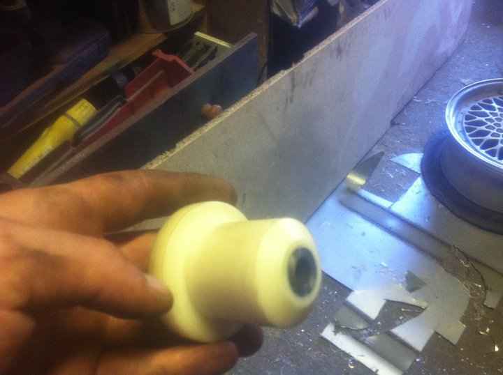

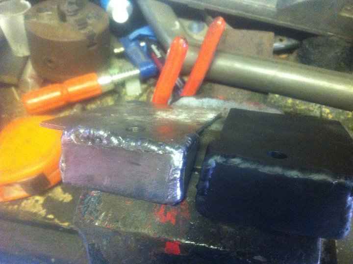

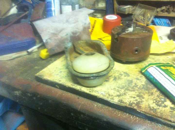

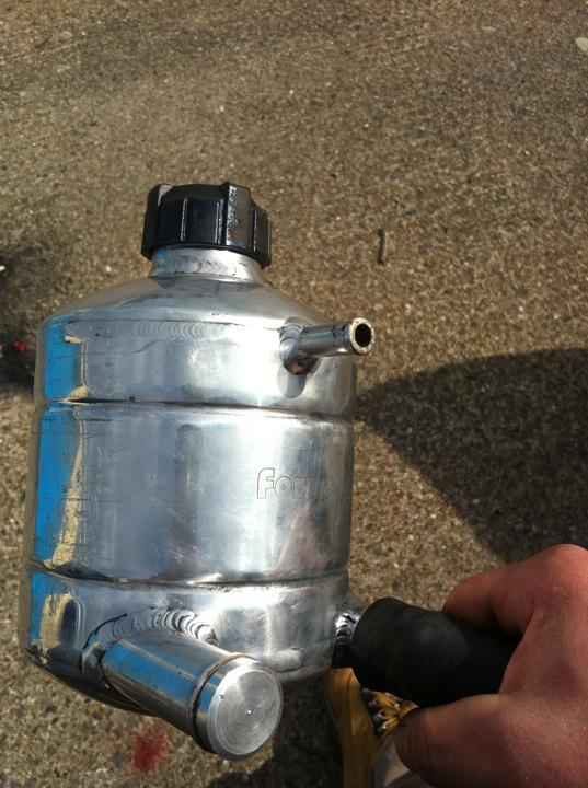

the last 2 days iv been in my garage making nylon engine mounts and rear beam bush's, I'm going to have the front gearbox and front engine mout made of nylon and the rear lower gear box solid ali (or maybe half nylon not sure yet) can see the ali mount in the back ground of the catch tank pic

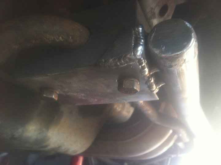

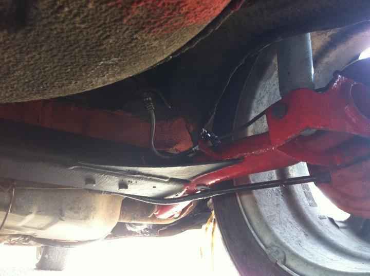

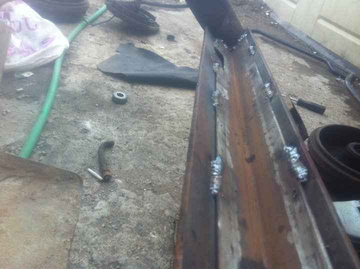

i was lookin into do a rover arb conversion on the beam but then had a thought 2day and welded a piece of angle iron down the middle, picture to show what i mean
me and a mate twisted the beam befor and wer shockd at how much you could twist it, now it still has a little bit of flex but id say its a big improvment

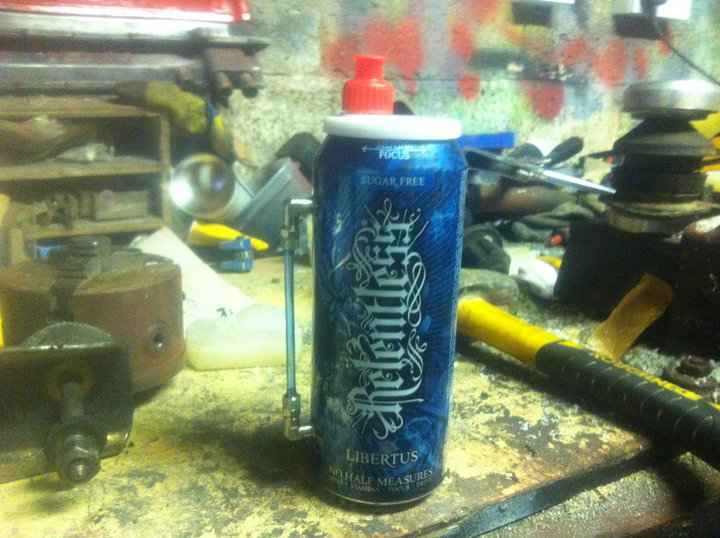

also made a catch tank :)

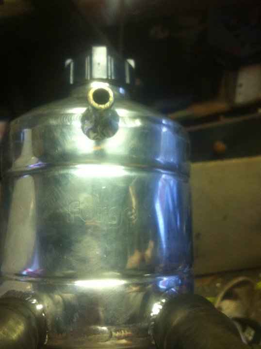

i swapped a paintball gun for this forge header tank, ill jus block off one of the ports at the bottom

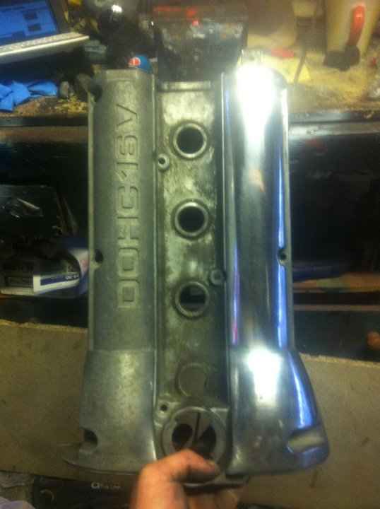

and started to polish the cam cover, the picture is from bout 15 mins with a mop in a drill using carbide polishin paste/block

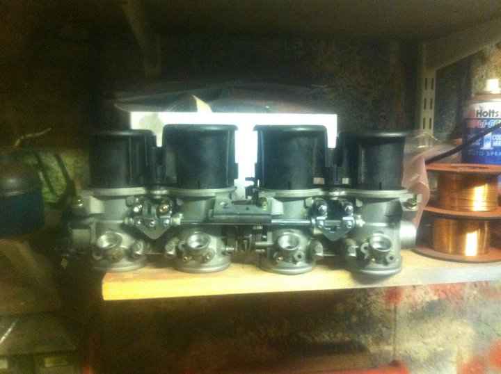

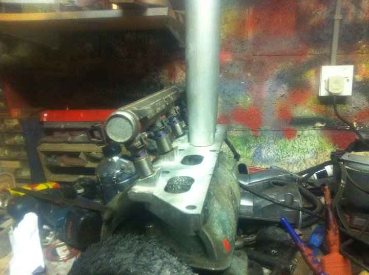

also started to make the manifold for the itb's.
i used the standard afh mani and mill'd it down so just had the flange and injector holes left, am then going to weld on some ali tube that has been oval'd one end and then weld the bodies to the tube and thn the boring part of port matching and polishing the inside :(

finished moking up the manifold jus need to weld it all together

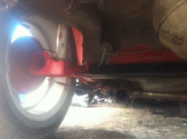

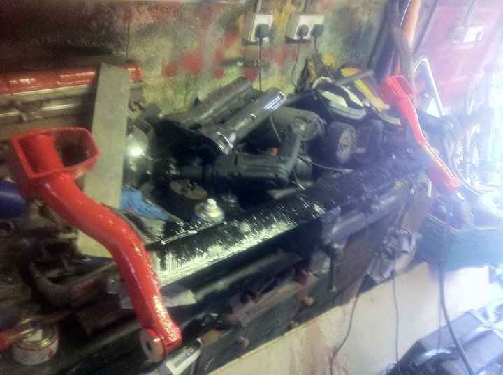

used a wire brush thing in the end of my drill to get the rust off the rear beam, and it worked a treat :) stripped it raw and painted it with red oxide primer then with red caliper paint and black spray paint
fitted it today along with the nylon bush's and some braid brake lines

does anyone no if a 4 speed rear gearbox mount is the same as a 5 speed one?
i have a 4 speed lyin around in my garage and duno if i can use it as a template to make a new one for wen the subframes on
how did the standard manifold work with the bike carbs? I'm cutting down a standard one to work with mine as cba to make one haha
cheers
cheers
worked fine mate. silicone hoses wer used just have to ram one end over the oval then jubili clip um on
it wasnt done by me or the last owner so its worked fine for a fair while

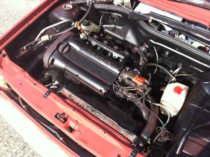

Afh engine with cbr carbs on the itb manifold, iv left the injectors in to fill the holes incase the new owner decides to go throttle bodies if not u can block the holes with bolts or sumthing
The cambelt was done by last owner (matt way) befor he dropped the emgine in around a year ago

Rear beam was strengthend and derusted and painted red and black with nylon bushs

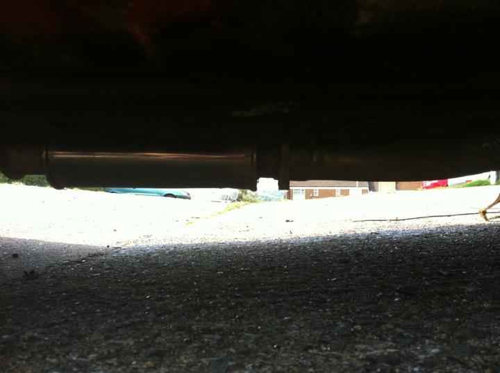

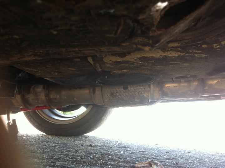

2.5 inch stainless steel exhaust

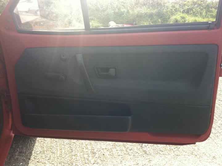

Carrado front seats in good condition, coupe s door cards including the rears, mono tuner steering wheel with quick release, still has the original tape player with ipod cassete adaptor.

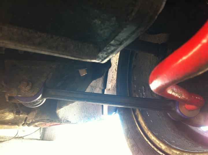

Brand new powerflex poly bushed tcas and nylone arb blocks made by me ( see thread)
It will be on a set of 14x6 ronal multispoke alloys but the tyres arnt the best, will aslo come with the lenso rims witch i started to refurb, the lips have been polishd jus the centres need to be sprayd in what ever colour you'd lik, they will possibly come with a set if decent low profile tyres.

And a 2.5 inch stainless exhaust but still the standard manifold

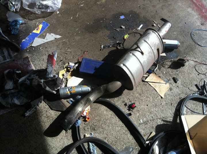

whats the zorst like? pictures....
how much for them spare front struts??
and also would like pics of both the exhausts
Dan
20 plus postage or collection for the struts.
Ill get a pic of the exhaust 2moro altho I'm not sure if i will sell it seperate as thn i wont have one unless u can make a offer i cant refuse ;)
