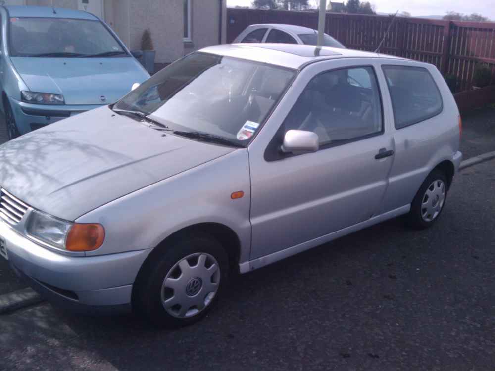

6nSponge's silver(ish) polo!
Thanks for the comments!! I shouldve taken a few more photos of when I first got it, the paint was terrible the old owner had covered it in primer! Also did the clutch when i lowered it as we had the garage, but for some reason i didnt say on this i did the clutch! Yeah i need to redo the wheels in a lighter colour, will probably redo them over winter as the steels will be better in the snow!
