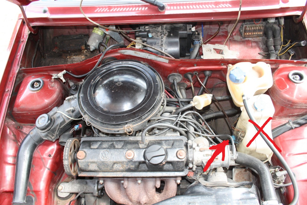

i've checked the fuses, none are snapped, but i don't know where abouts the pump/motor and wiring is in the engine bay
can some please do this noob a really massive favour and circle where i'd find the washer pump and the wiring?
cheers, tom
x is the washer bottle.
arrow is to the pump on the side of the washer bottle
how did i seriously miss that. i thought that was just a connector.
