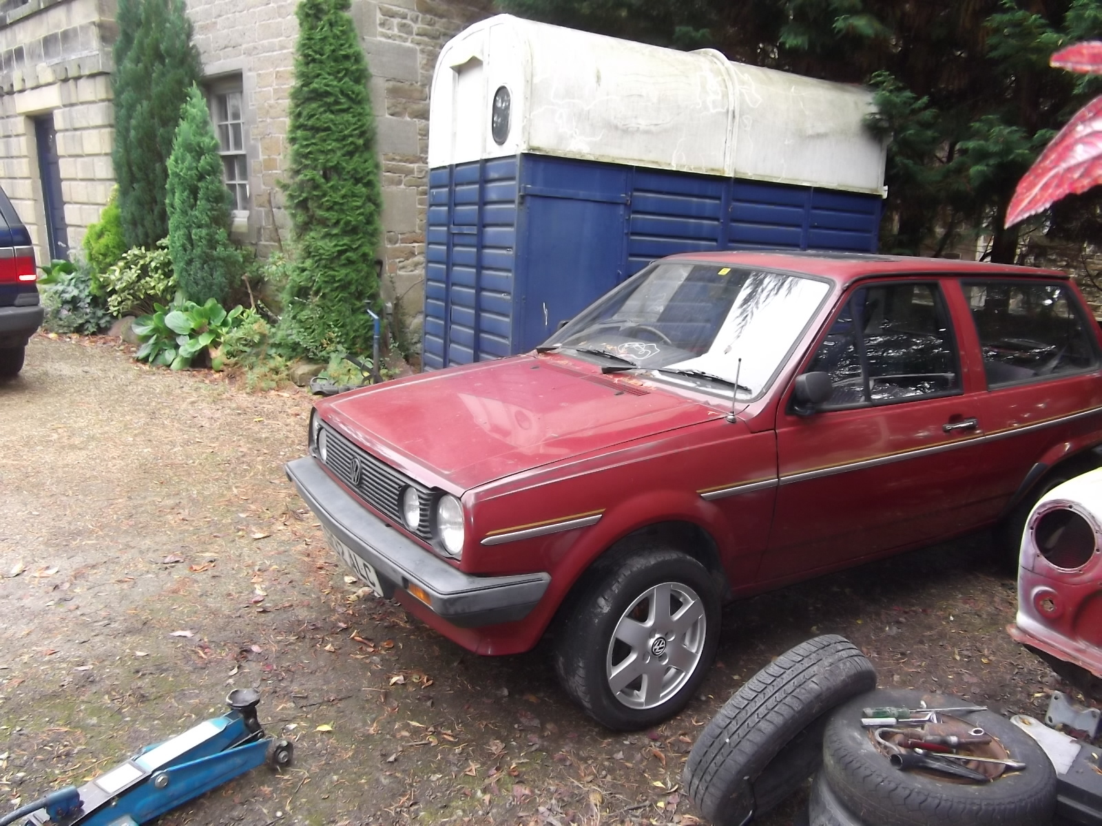

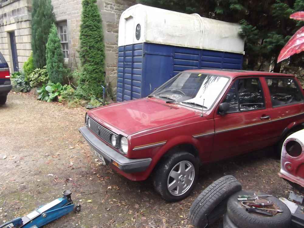

I wonder who can spot the deliberate mistake in this picture? ;)
It'll be someone who knows they're early Mk.2's.
I say leave the 1.4 under the bonnet and fit a decent set of dampers and springs, and not ones that will "slam it into the weeds" :lol:
Top fill rad and expansion tank.
pretty sure you are wrong sir loafsalot, the washer bottle is mk3 but the rest is early mk2.
Wrong head/engine, washer bottle and airbox/airbox cover.
Edit: Fuuuuu- I deleted a post while Leon was writing his :lol:. I thought the early engines had a plastic airbox cover and different cam cover.
Give me the banana!
Correct!
Everyone can see it's the wrong engine/washer bottle/expansion tank... Too obvious :p

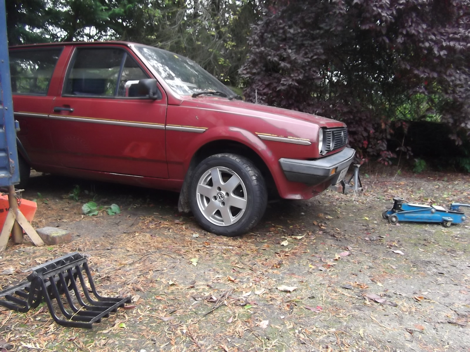

What reg is it? I can see three letters at the end of the plate in one pic, which'd make it at least A reg (august '83-July '84) unless it's a personalised reg?

The reg plate for this one is HBA3**Y

The one in the pics ends in ALC. Is it a different car then? that's what had me confused! :?

The plates on the car, in the photos, are from a mini. Place i have it stored had a funeral procession start there and to tidy up the yard and what not number plates were put on all the cars.
Plate is *******

Ah thank you for explaining it was bugging me! :lol:
