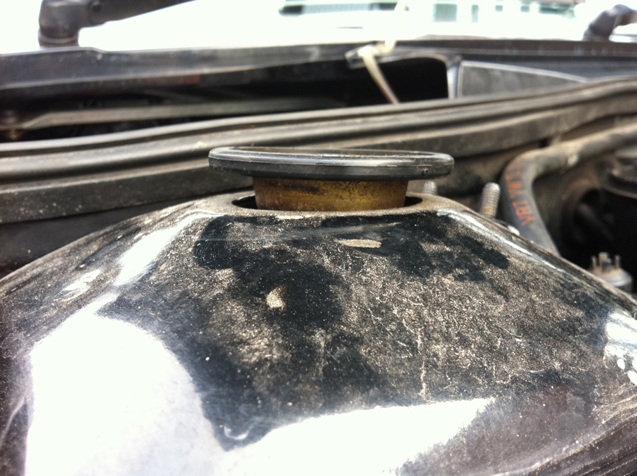

this is how its sitting at the minute ,
Yeah, those top mounts look about fucked.

As far as I'm aware those cups never sit flush
mine have NEVER on all my polos on stock and aftermarket suspension kits
i would like it to sit flush tbh as when you jack it up it goes flush which is fucked up as when you hit bumps/potholes the suspension legs clearly moving up and down :?

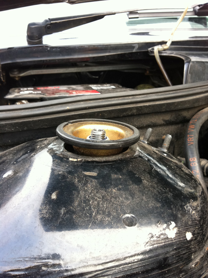

i took suspension out today and replaced the top mounts , to be honest , they werent actually that bad , i also dropped some 2ps down the strut for good luck too ! thanks yeti !! and slapped it all back together , used some round exhaust rubbers too , one on each side like so .
to be honest , if you just use the rubbers you guys with the problem should notice a massive difference , and as you will know , only will need to remove that top nut ,
rides and handles so much nicer now too ! no more clattering :D
