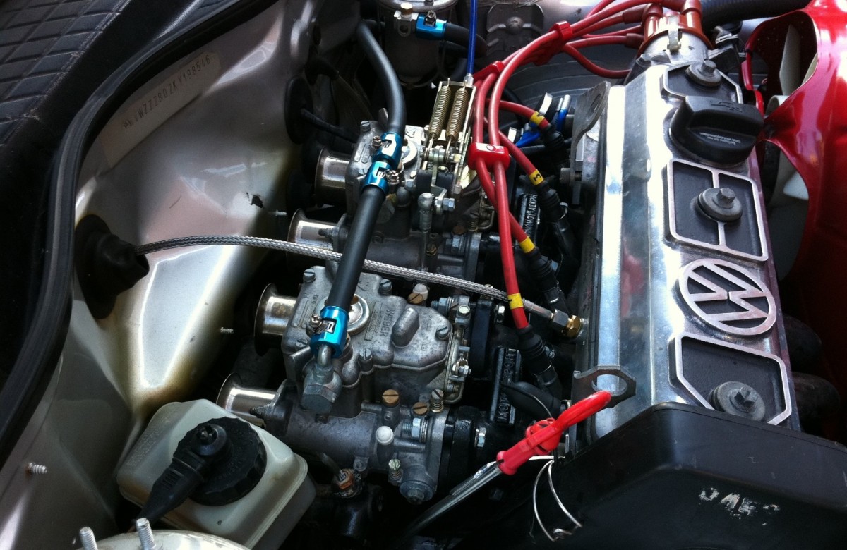

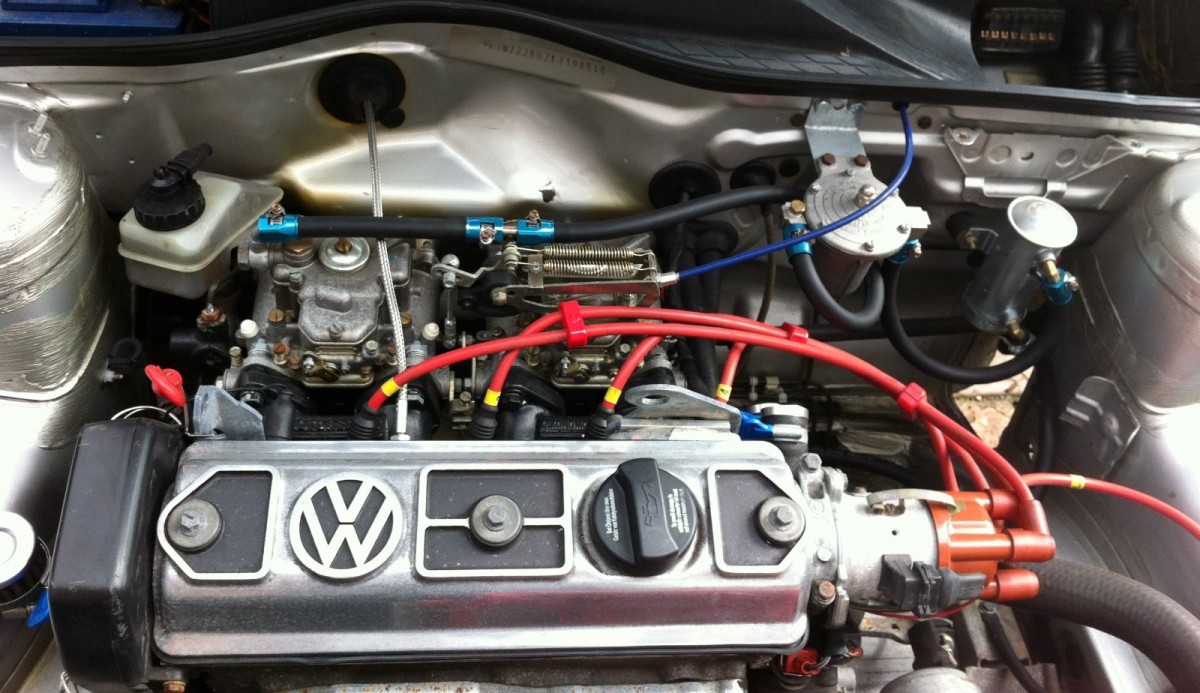

Here's how the engine bay looks now:

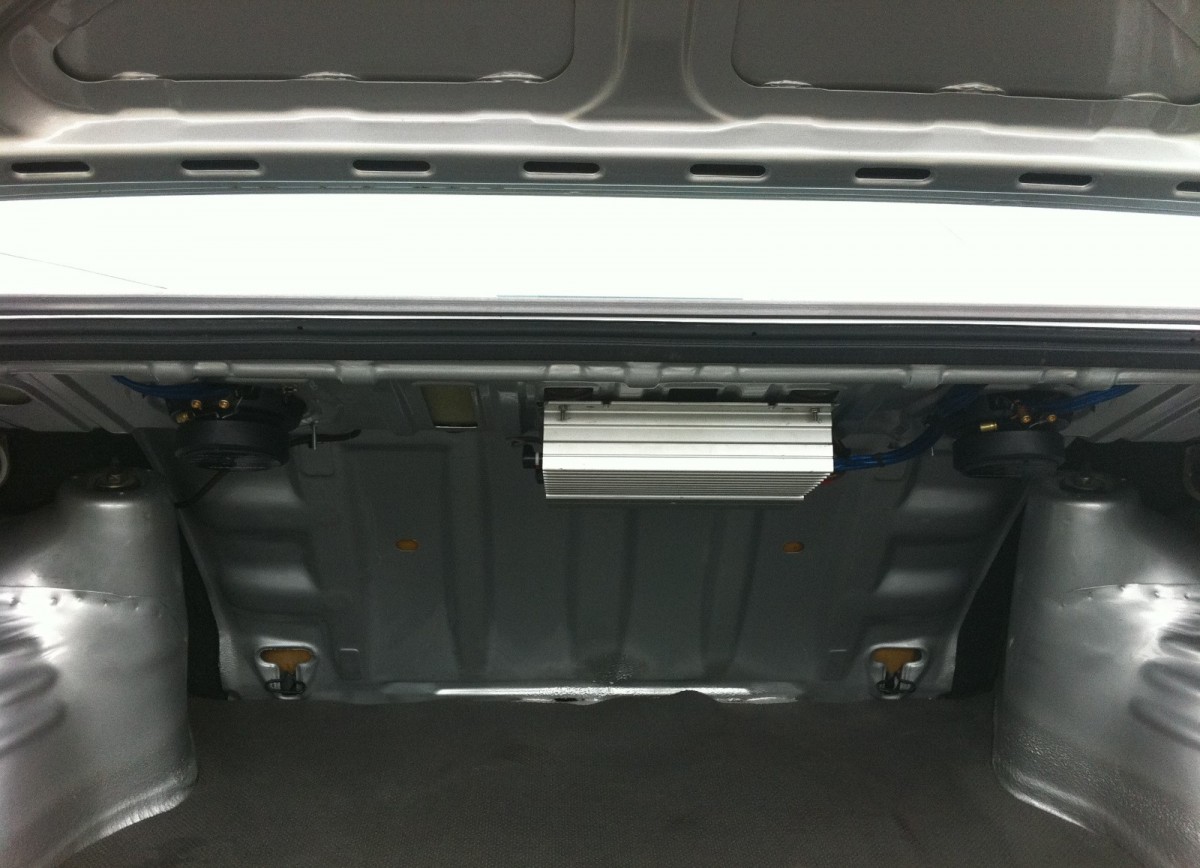

I installed an amp to the underside of the rear shelf, replaced the shelf speakers and ran a set of RCA cables to the front so I can plug my iPhone in. Now I control the volume from the phone - works a treat. Still need to find some way of mounting a dock for it though... Considered using the centre speaker grille but can't think of a sensible way of doing it.

Looks really great! Did you mask or replace the sticker on the fan shroud? I love it when people pay attention to little details like that!

MattLoaf - The radiator cover is powder coated, so what you can see there is a sticker. Managed to find it on ebay here - he has loads of other stickers too: ebay sticker man
Will get some better pics of the engine bay up at some point.
The downside of twin 40s is that the left-most trumpet gets in the way of the master cylinder, so I need to do something about that (for now the trumpet's chopped, but that leads to some interesting noises and idling issues). Looks like either a master cylinder from something else where the tubes point in different directions, or I'm going to have to get a pedal box with the MCs and reservoirs built in - but that's £500 I don't have. Nobody seems to have much experience of webers in a polo these days as everyone's going with bike carbs.

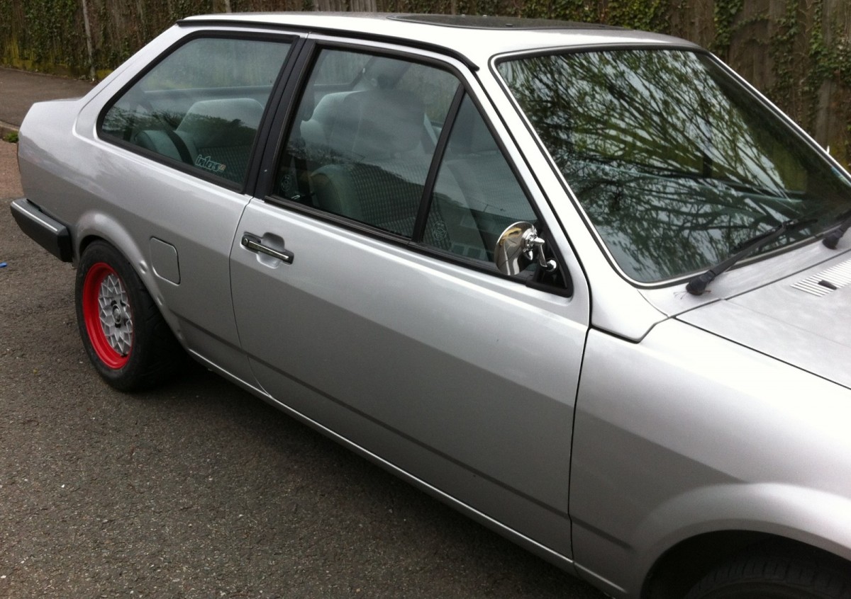

I also finished my wing mirror...
I "Engineered" (sat there with a hacksaw a pot of QuickSteel, and a file for hours on end) a blanking plate for the passenger side mirror by butchering an old wing mirror for the base.
For the driver's side I got a chrome mirror thanks to polohmadness and another old mirror thanks to prankstar2003 and made another 'blank', with a hole in it, and painted both sides up in satin black. While I was there I also painted the plastic base surrounds as they had gone pretty manky over the years.
I'm pretty happy with the end result but it probably won't be to everyone's taste :)
Drivers side:
Passenger side:
Aaand some random engine shots:
Anyone know where that manifold came from? It looks to me very much like the VW motorsport inlet manifold, but on one side it says "Motorsport" (as you can see in the pic), and on the other, it's all in... foreign. Like, greek or something. I can get a better pic if anyone has any ideas.
Also thanks to MaxMax for helping me out with a fuel pump blanking plate to cover where the old mechanical fuel pump was. No more leaks :)
You can see the chrome dipstick tube in one of the pics - was a pig to fit as you have to sort of bend it to the right shape. I'm sure it's easier with the engine out...

where is the header tank mounted? i can see the hoses running off, but can't see the tank? would like to get mine out of site too, it looks gash :lol:
looking good mate, loving the twin 40's!
Awsome stuff man, its my sort of car 8-)
Lovely :)
Header tank is gone. I replaced the radiator for a header-tankless model. I think its actually a radiator from a 1984 1.3. Can't remember exactly which one. I had to chop the top mounting brackets down a bit but after that it fitted perfectly. So the filler cap is now on the rad itself instead of on a separate tank.
The other mod that made a big difference was relocating the washer bottle to the boot. I got a rear washer bottle from a bready, installed it in the boot and ran a long length of tube from the front washers all the way back. Only took a couple of hours to do and makes a big difference to the way the engine bay looks.
Pics of the boot install and washer bottle mounted in the boot.
The washer bottle itself is one from a bread van as the engine bay one won't fit.
Next up I'm planning to move the battery to the boot so I can hide the fuel pump and regulator in the battery tray. This might take some time as I have zero budget.
