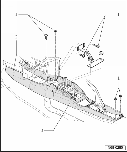

Removing
– Remove upper part of centre console → Chapter ^^
– Remove bolts -1-.
– Detach Velcro strip -2- on left and right.
– Guide centre console -3- over handbrake lever and lift off upwards.
Refitting is the reverse of removing!

Removing
– Remove bolts -1-.
