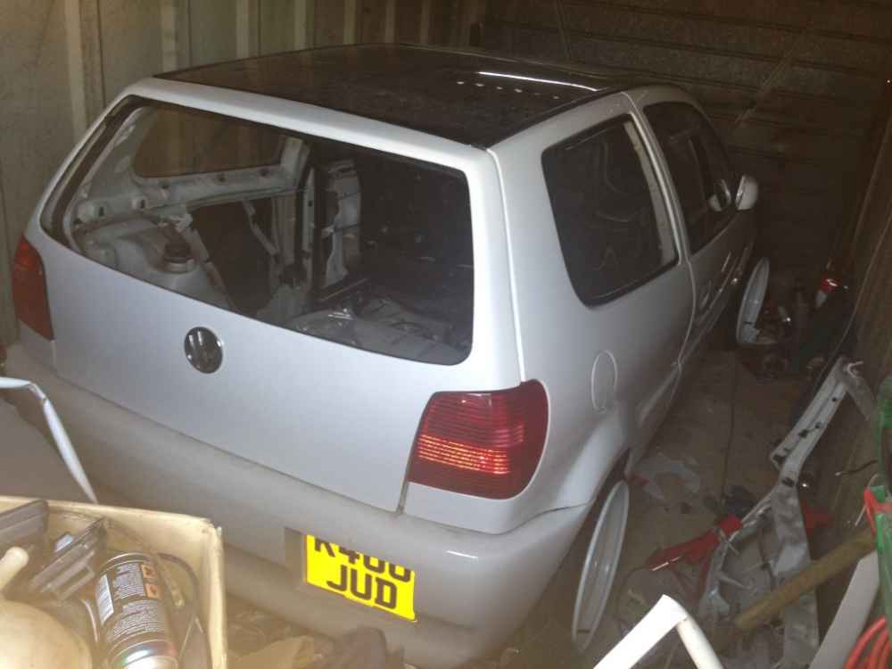

Just got a quick picture of how the engines sat in so far.
nice! what sorta mods you gotta do to fit it in?
Sub frame needs cutting out and welding to suit the new fabricated rear mounts, engine loom fitting into fusebox, vr6 gear stick remote fitting, new metal clutch pedal welding in plus vr6 clutch master and reservoir, front panel cut out to fit new fan and rad, drive shafts made to fit, exhaust made to fit, theres a fair bit of work goes into one but its all worth it for the sound at the end ha
