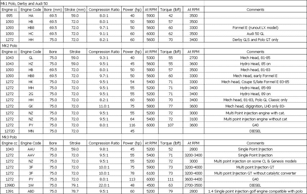

Yeah, I've got a list like that. If I can, I'll post it up later on. its pretty much complete too I think. B)

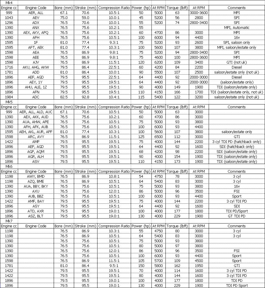

Here you go, sorry its in the form of a pic. It needs to be updated to include the mk7 as well I suppose. :-o
I've missed the first line off the first pic as I'm limited to 600 pixels in height on my image hoster, so I've re-added it with text.
mk1 polo, Audi 50 and mk1 Derby.
Ah thats a neat table gaz, cheers
ooooh good to know i got 60bhp/86tq and not the 55 like the other 8 valvers :) (AEX !)
8-) I'll probably move it to the FAQ section once kryton's seen it.
Cheers for that, very helpful.
You can stick it in the FAQ now :-D

i thought the late model mk4 (AEX i think) were 65bhp? everywhere else has it down as 65bhp?
and the other mk4 1.4s (akv) are 60bhp
those were the official figures that vw gave out and vw/audi always underates the power of their cars too
Edited by dreleask
Nope, the AEX was always 60bhp. Anything that would have given it more power would have changed the engine code. Plus any more power and it would be stepping on the toes of the 1.6 8v.
According to etka, the AKV is the late model 1.4, which replaced the AEX in around 1997. The two 1.4s that have 55hp were fitted with automatic gearboxes, although It now seems the APQ engine had 60hp.
You're right about VW/audi often underestimating the power of their engines though.

Yeah ETKA lists the APQ engine as being 44KW (which comes out at 59hp)
It's as near as makes no differece, VW list the engine as having 60hp in the uk, so that's what I've put. Every bit of data has been gathered from official sources, either from VW brochures, etka or sometimes haynes manuals.
woo! I'm on AEE power now! any idea what the torque if it is likely to be?

Which engine codes in the 1.3L engines used solid lifter heads? I would love to get my hands on a 1.3L over here in the states.
HH, HK, GF and GK are all solid lifter 1.3s. The GF isn't listed though as it's a golf engine. (it's identical to the HH)
