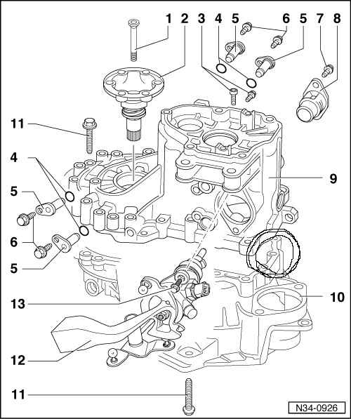

thanks again nige,anyone know how to split the box apart?its virtually there but what seems like part of the change is bolted to the bell housing (torx so cant undo it)inside
Dismantling and assembling gearbox
Removing and installing gearbox housing and selector mechanism
1) Countersunk head bolt, 25 Nm
2) Flanged shaft with spring ◆ Removing and installing => Page 39-1 ◆ Assembling=> from page 39-8
3) Torx socket head bolt, 30 Nm ◆ For reverse shaft support ◆ Self-locking ◆ Always renew
4) O ring ◆ Always renew
5) Pivot pin
6) Bolt, 25 Nm
7) Bolt, 25 Nm
8) Cover plate
9) Gearbox housing ◆ Servicing => page 34-75
10) Clutch housing ◆ Servicing => page 34-75
11) Hexagon bolt, 25 Nm then turn 90°further
12) Selector mechanism ◆ Dismantling and assembling =>from Page 34-86
13) Hexagon bolt, 25 Nm
Which of the RED highlighted sections do you need?
its in the circle marked but its an internal hex or torq headed bolt,dont knowhow to get it apart as thats all that seems to be holding the bellhousing to the main part of the box
‒ → Remove both reverse shaft support bracket bolts (arrows).
‒ → Remove selector shaft with selector mechanism cover, to do this place selector shaft in neutral position. Then remove bolts -arrows- and pull selector shaft out of the gearbox housing.
‒ → Remove cover plate -A- and pivot pins -B- from underside of gearbox.
‒ → Remove pivot pins -A- on top side of gearbox and gearbox housing to clutch housing securing bolts -B- in area of differential.
‒ → Remove bolts -A-, from inside clutch housing for securing clutch housing to gearbox housing.
Note: Do not remove nuts -B- for output shaft bearing support.
‒ → Take-off gearbox housing, if necessary carefully lever up all round and alternating between sides on the protruding housing flange (arrows), being careful not to damage sealing surfaces.
