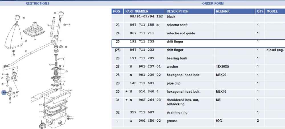

all of the selectors are the same on the 4/5 speed
they are differnet mate
the 4 speed is like pic
the 5 speed has another part on the bottom for the extra movement
plus they are a different size and mount
Not from what I can see on etka,allthough I could be wrong

Doing some research with pics there is a difference, but if you look on etka only one is listed, 191 711 233. Curiously the diesel has a different one listed?

The reason etka may only show one is because the five speed is compatible with a fourspeed box, however the four speed selector is not compatible with a five speed box, I found this when converting to five speed and playing around with a few things. Atleast this is how it seemed to me, may be wrong though.
