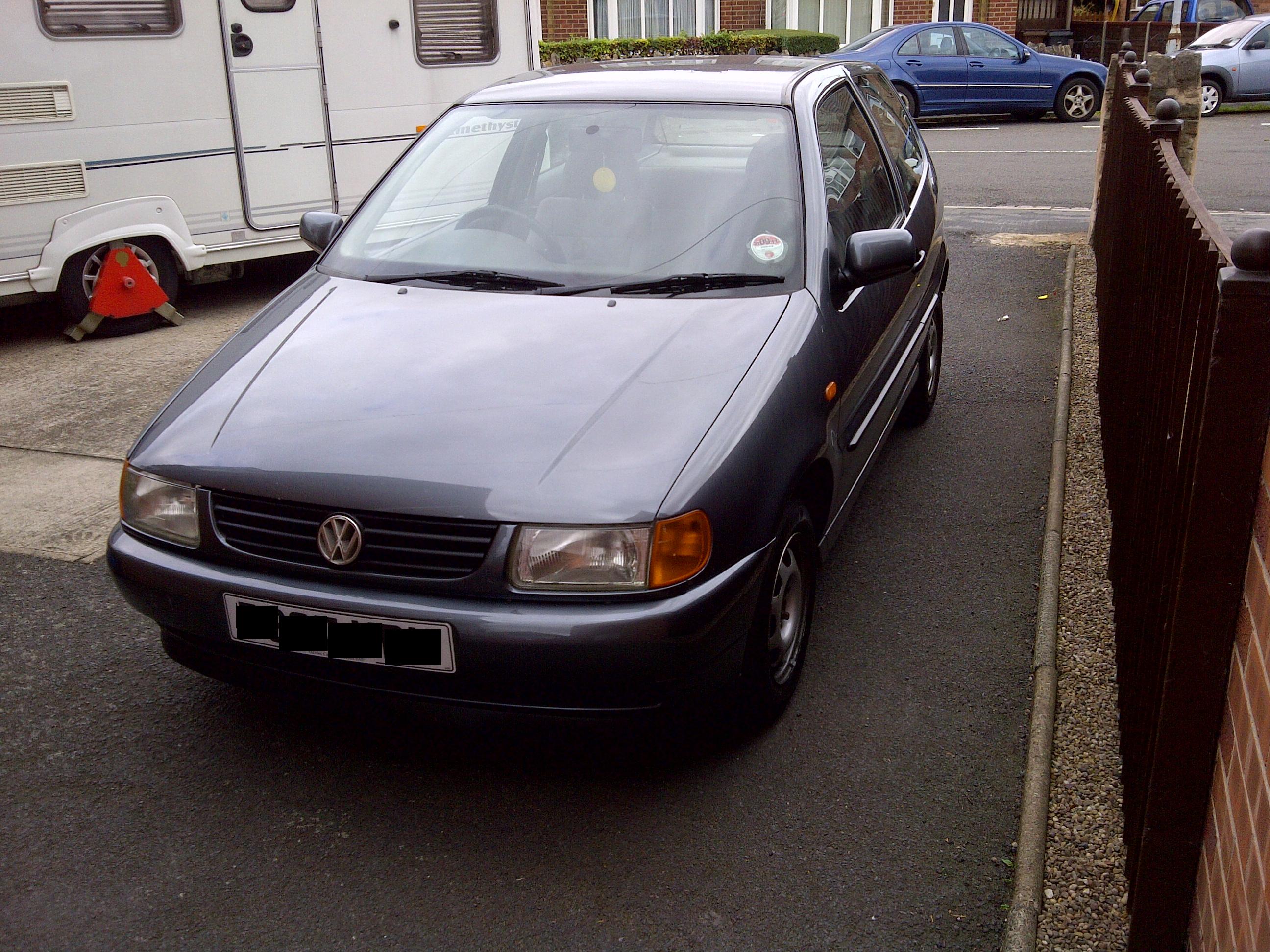

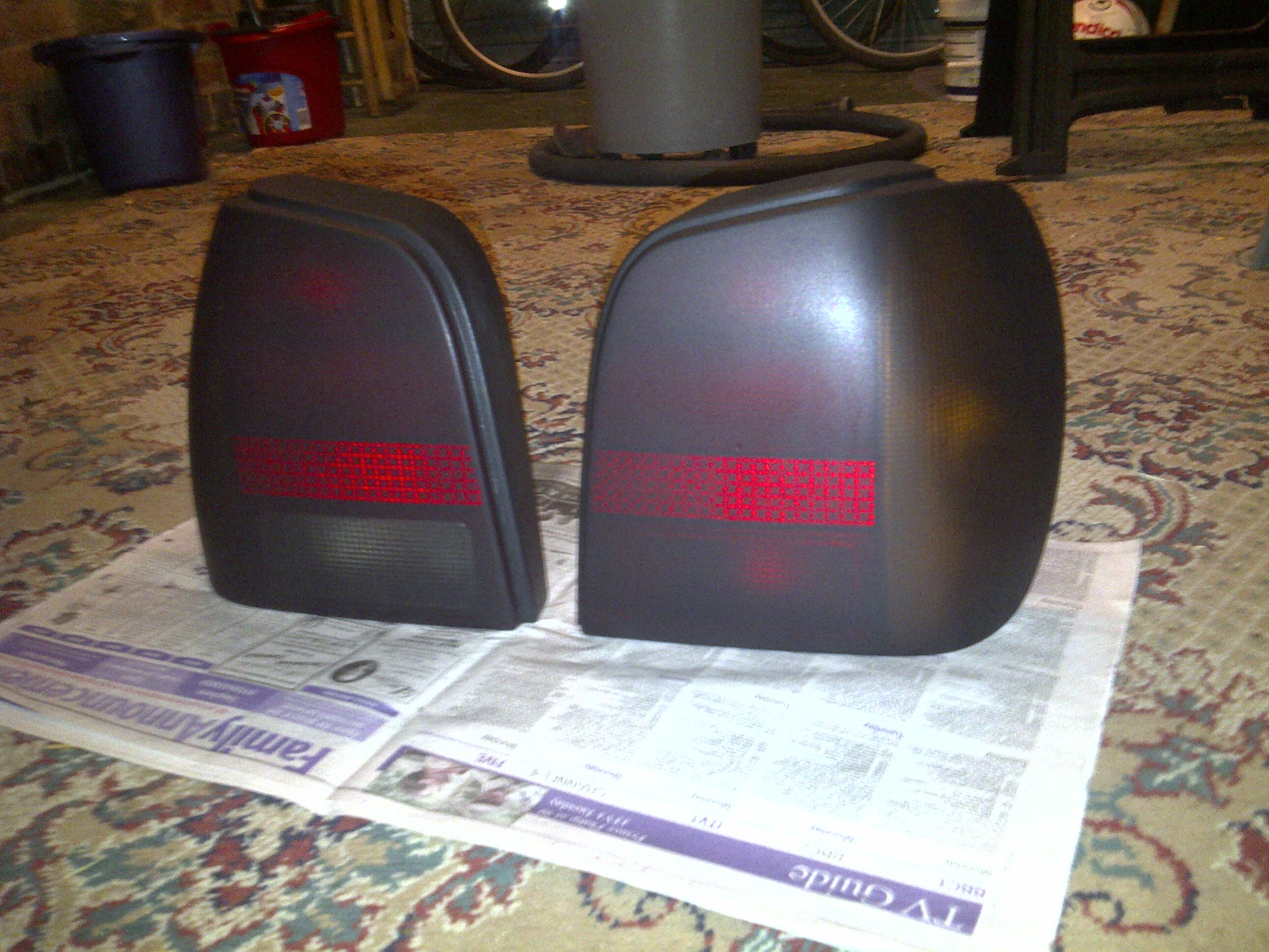

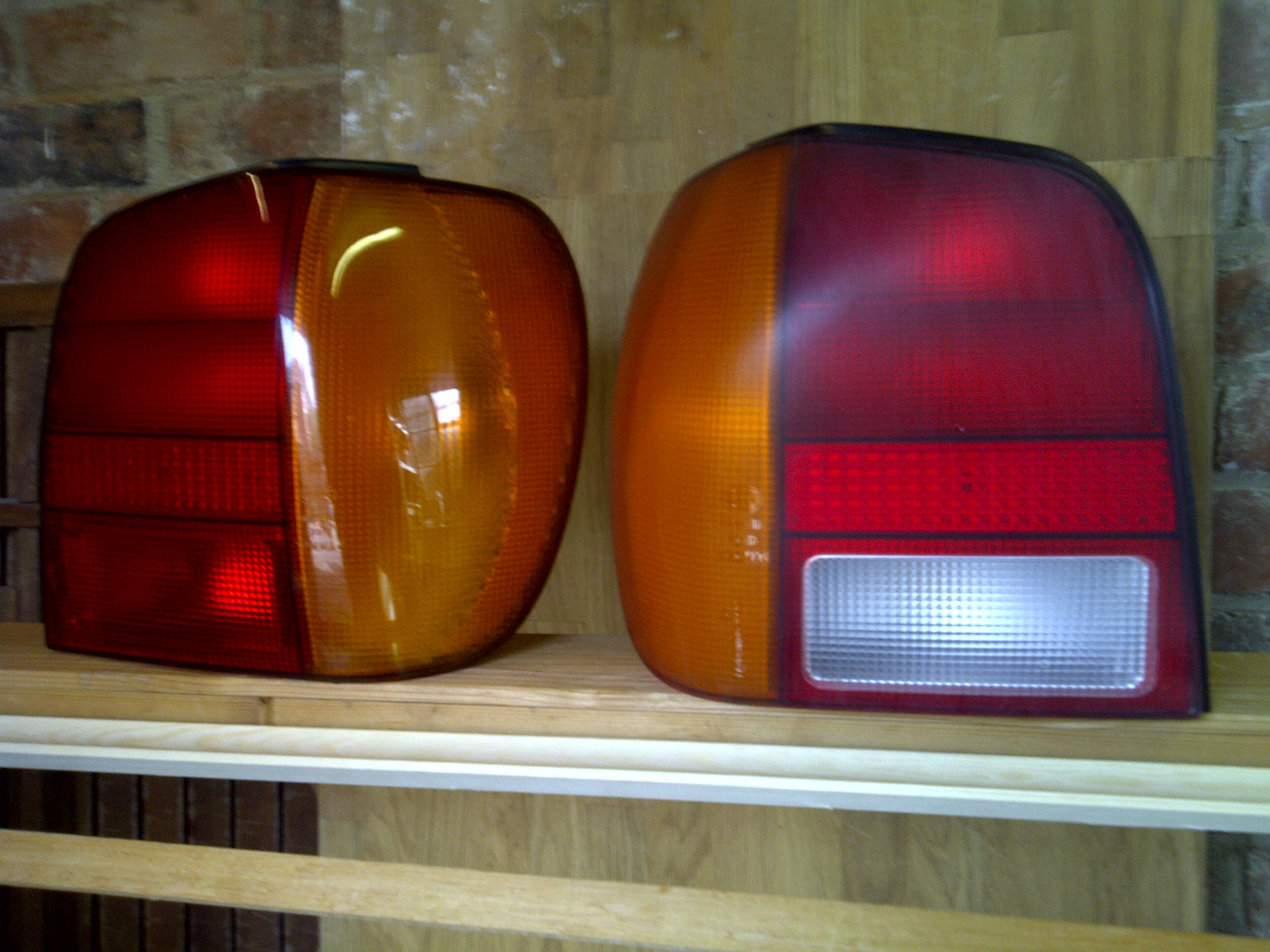

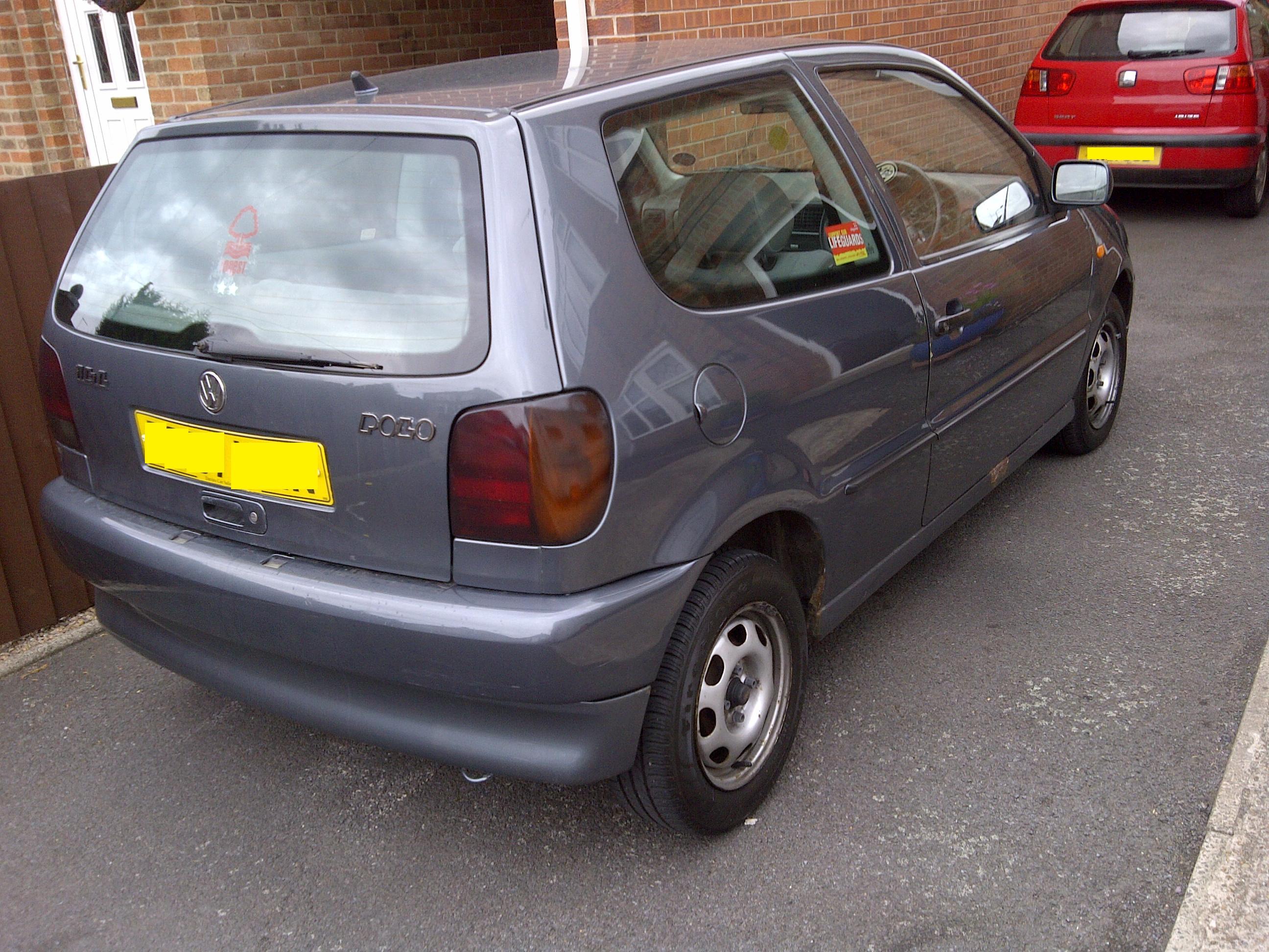

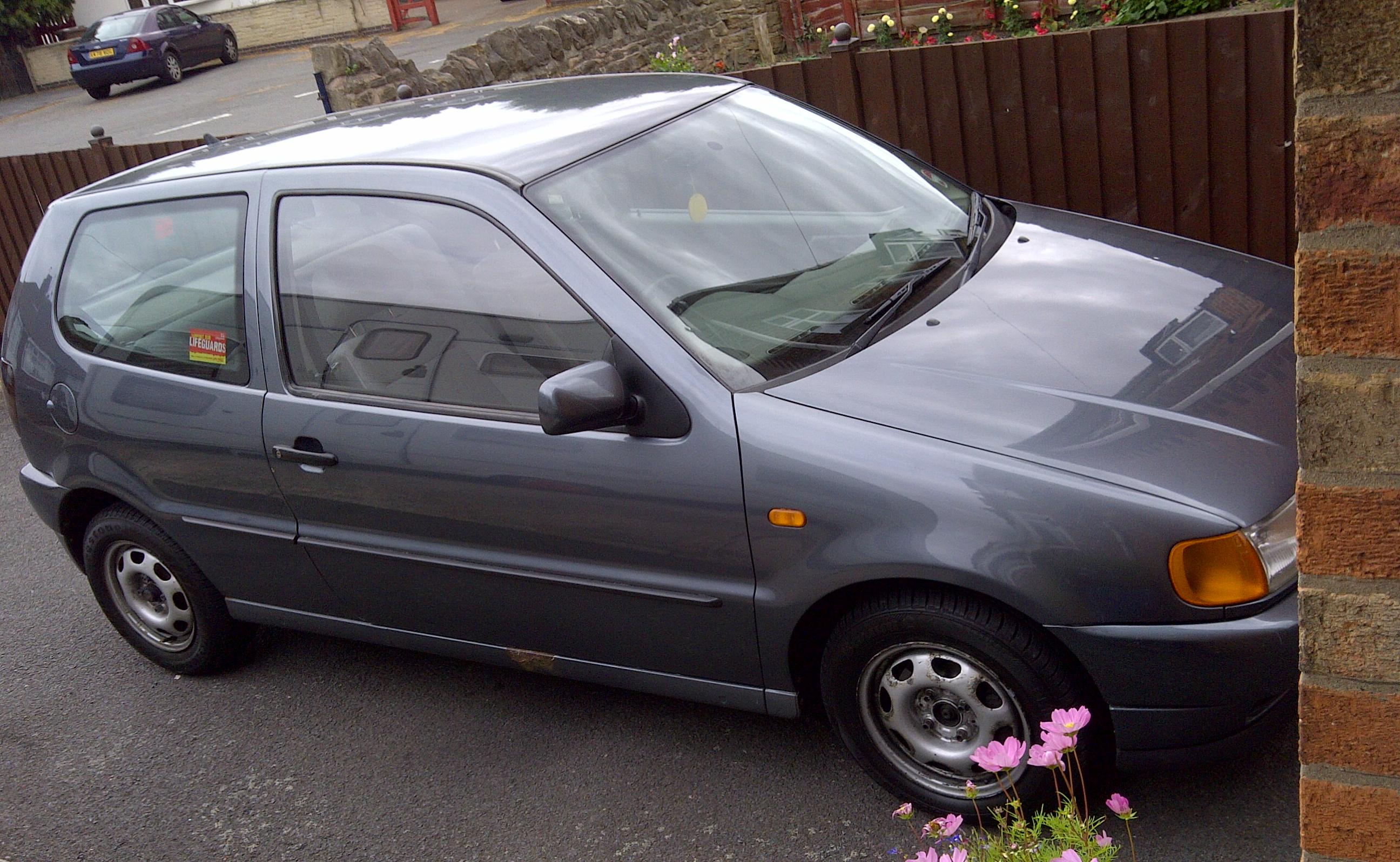

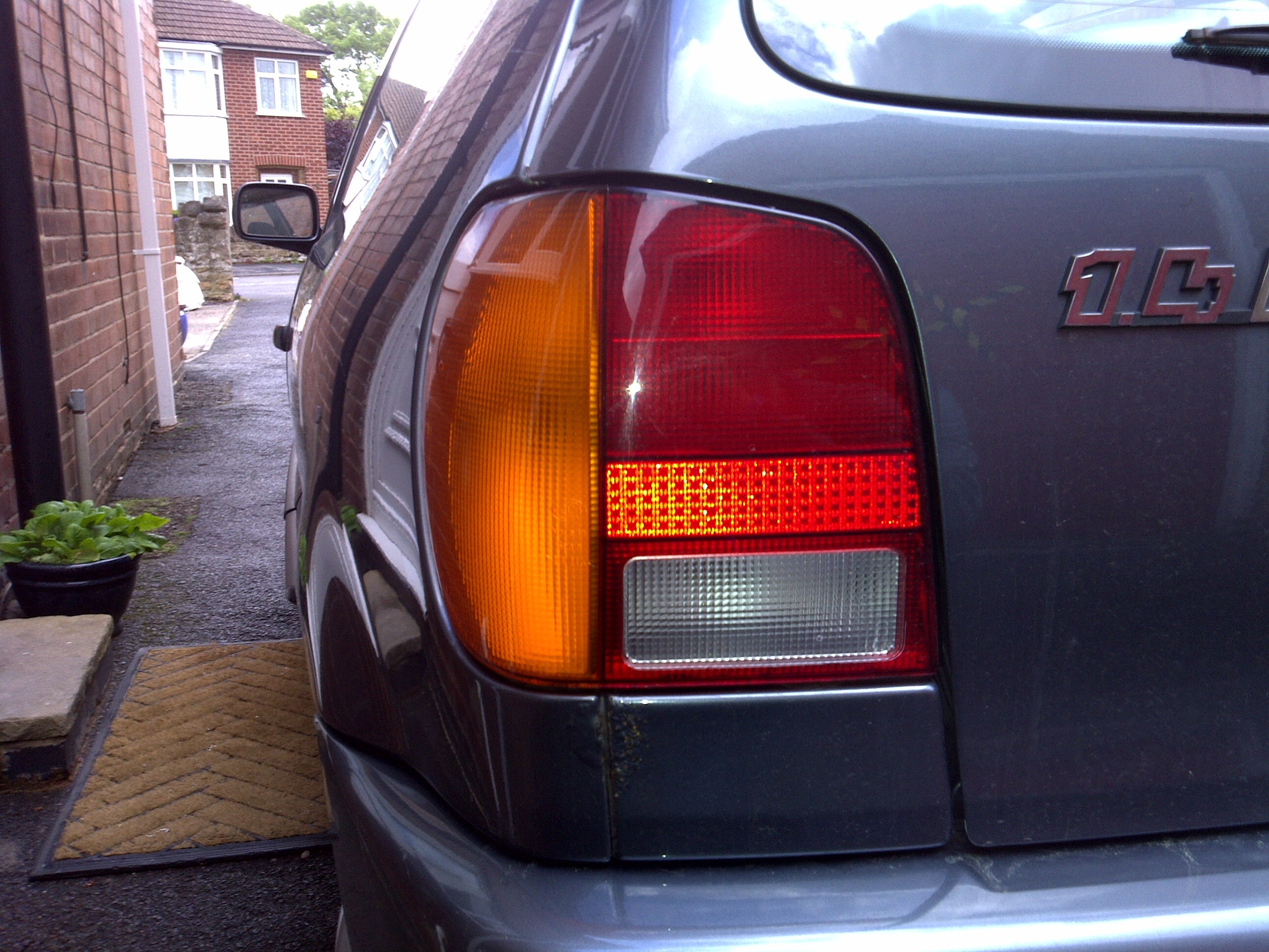

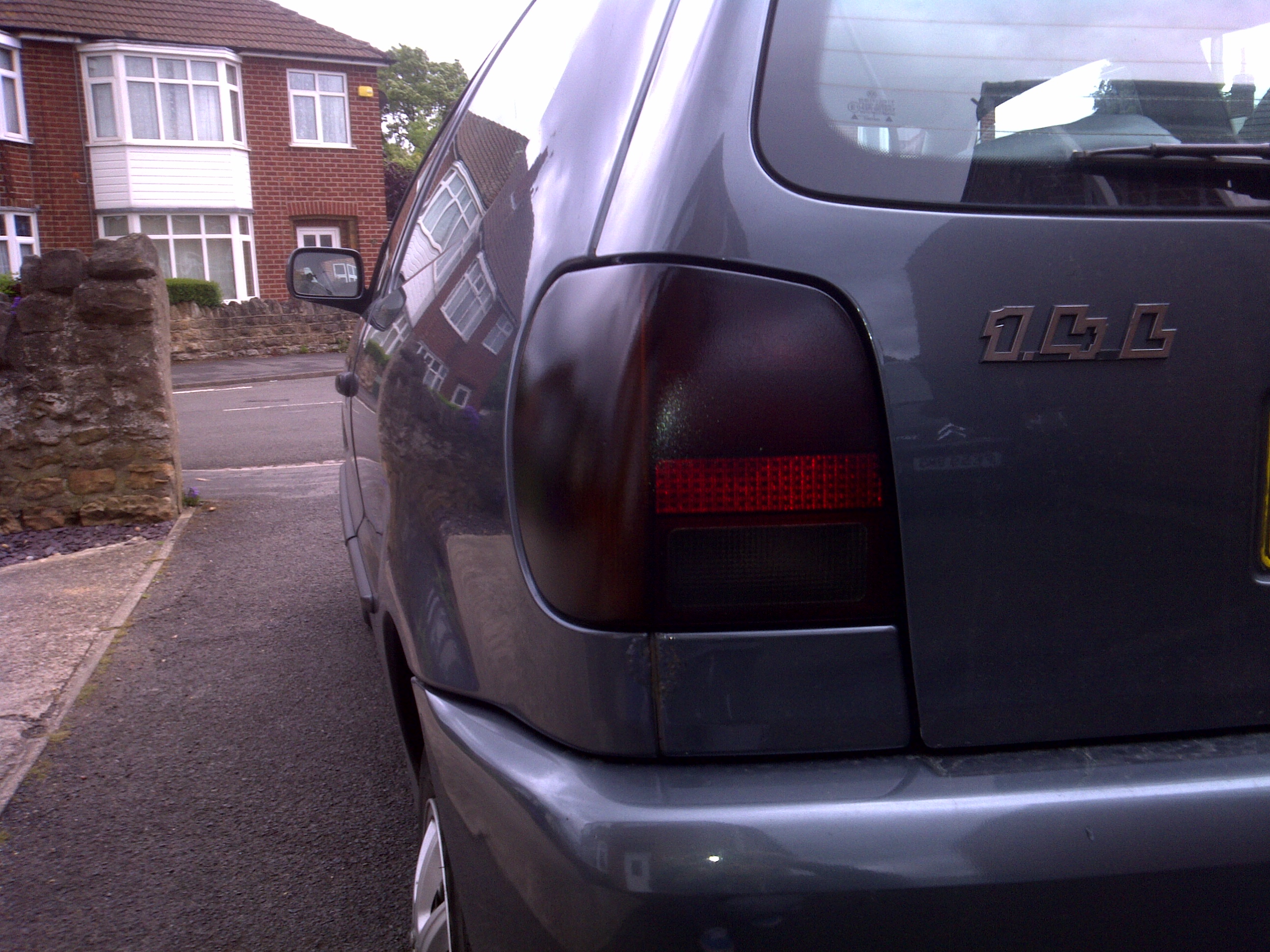

had my polo a while now and decided I'm gona change a few things only got around to spraying the back lights. eventually going to lowe it 40mm tint the windows new plates smooth the boot and take off the black side strips.

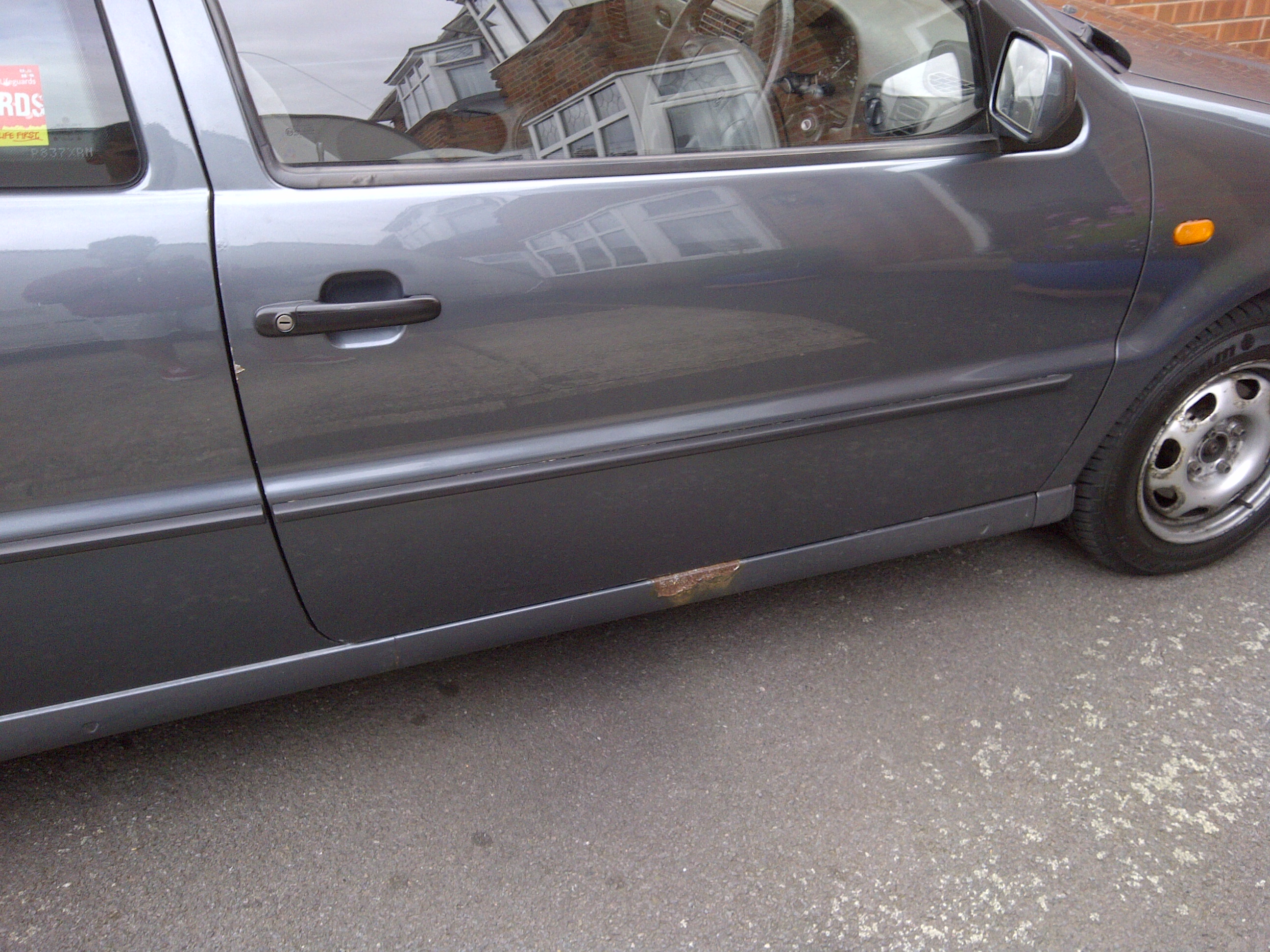

p.s does anyone know if the side strips will need filling and smoothing when i take them off ? thanx

nice base to start with , the side strips are stuck on with like double sided stick tape just pull um off and clean the sticky s**t left behind off the doors and rear quatars . Dave
side strips are just glued on so they come off.. just heat them up a lil to loosen the glue and use an old credit card or soemthing like that. ohh and if you are left with some glue on the car get yourself a fudge wheel off ebay and that'll get the glue right off
