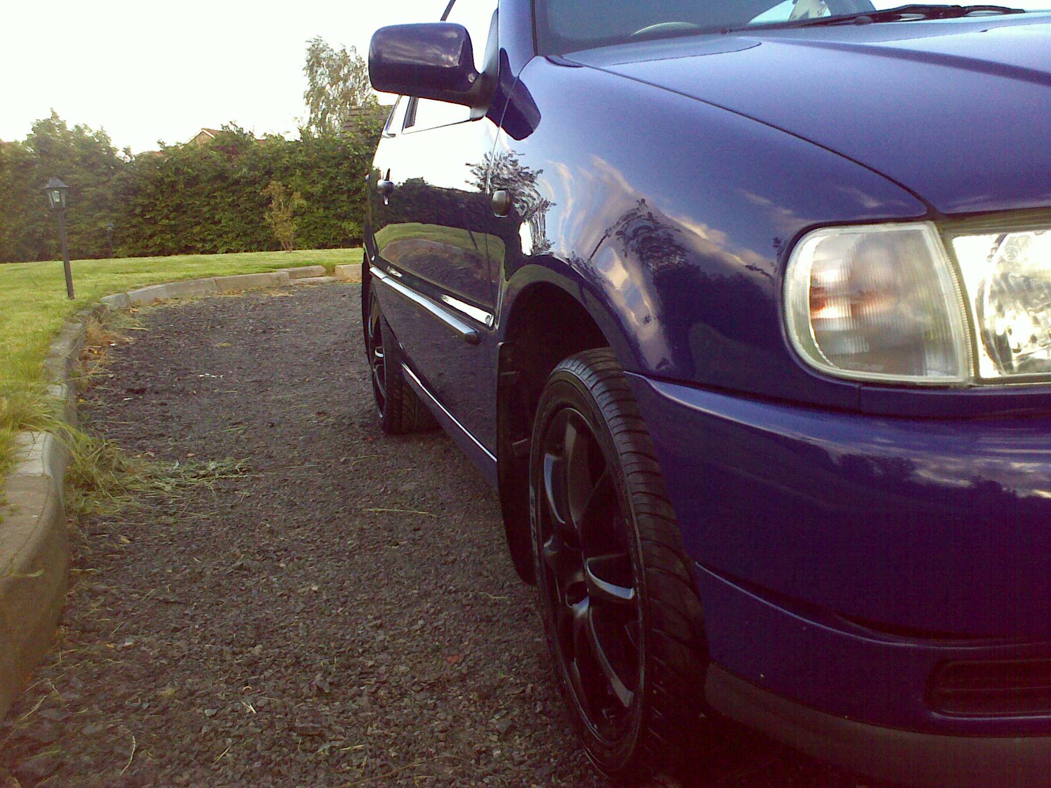

Bought some TSW Lightweights and painted them Stealth Black

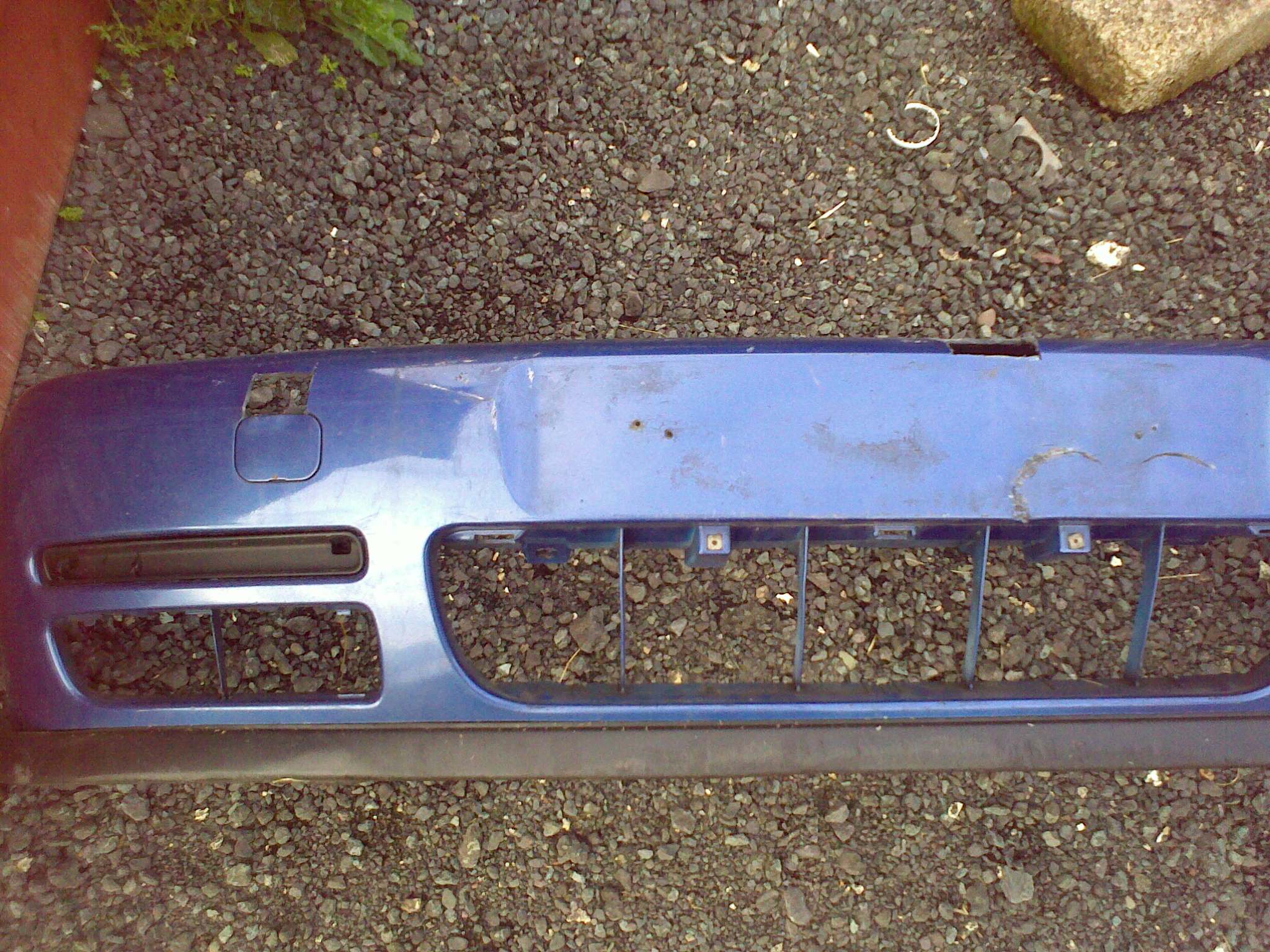

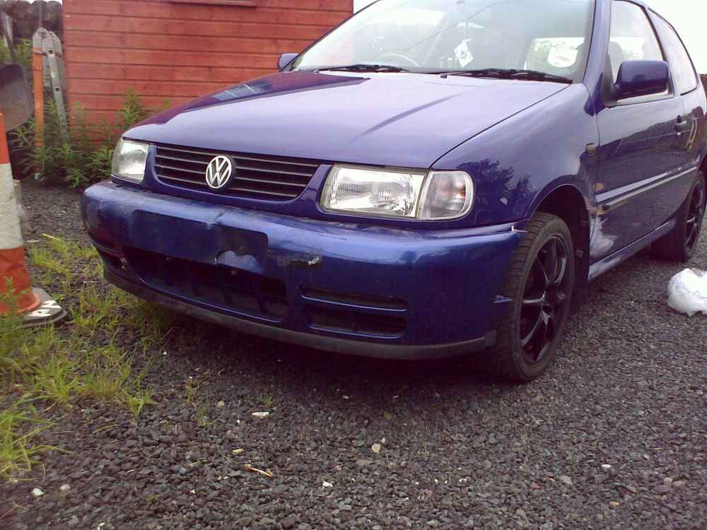

After a run in with a fallen tree i decided I'd fit a 16v front bumper, got this free as it needed a little work

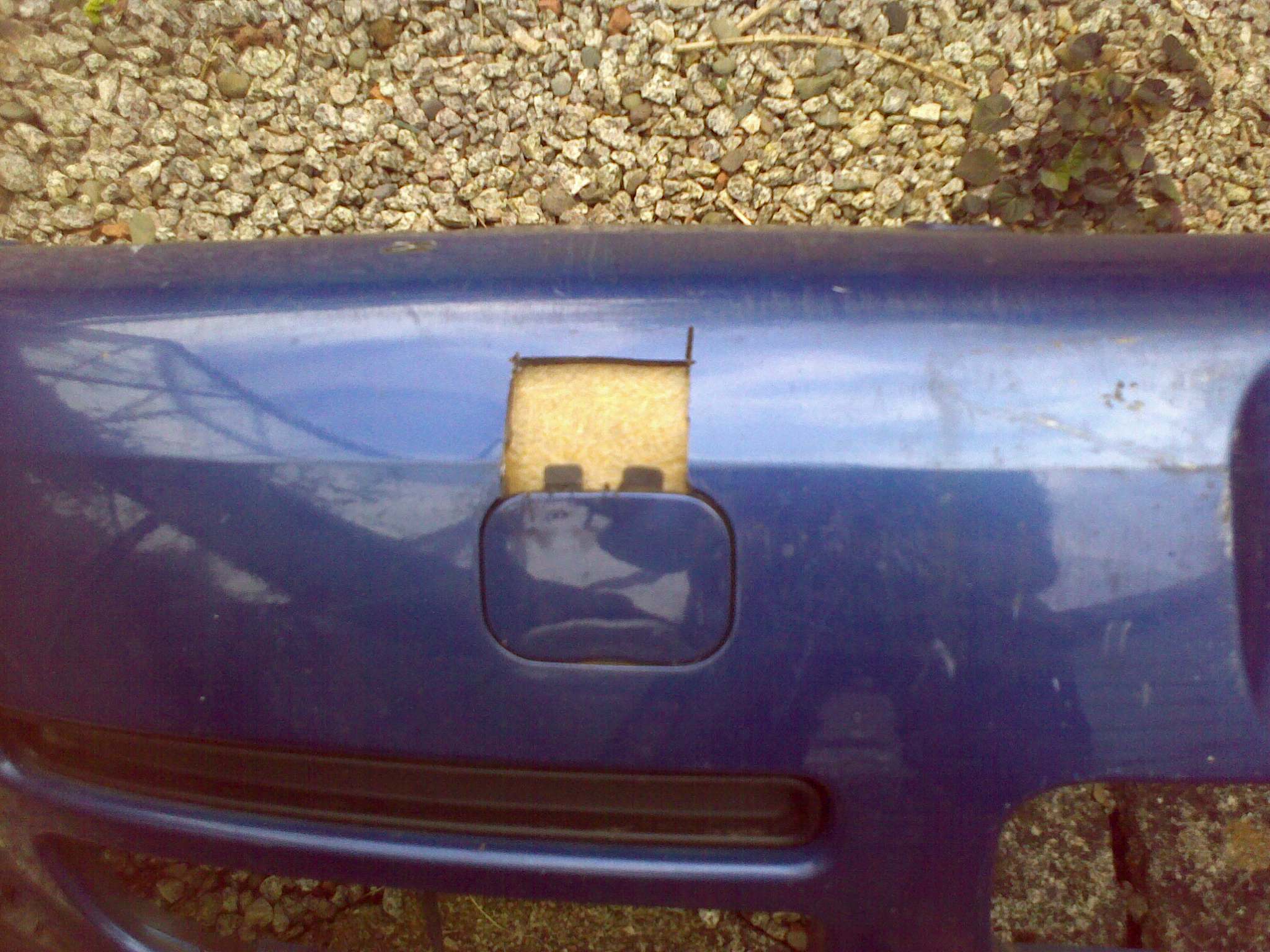

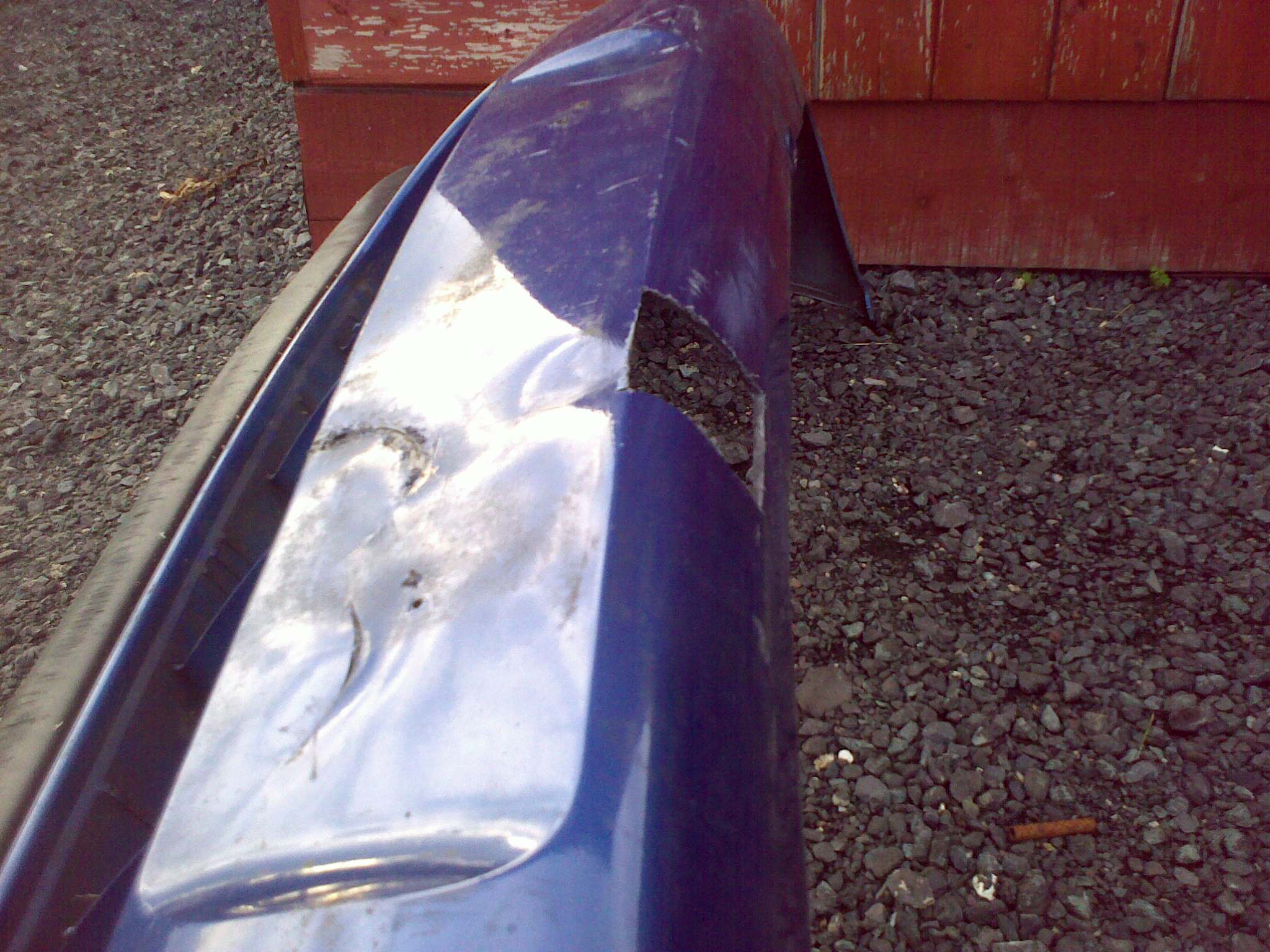

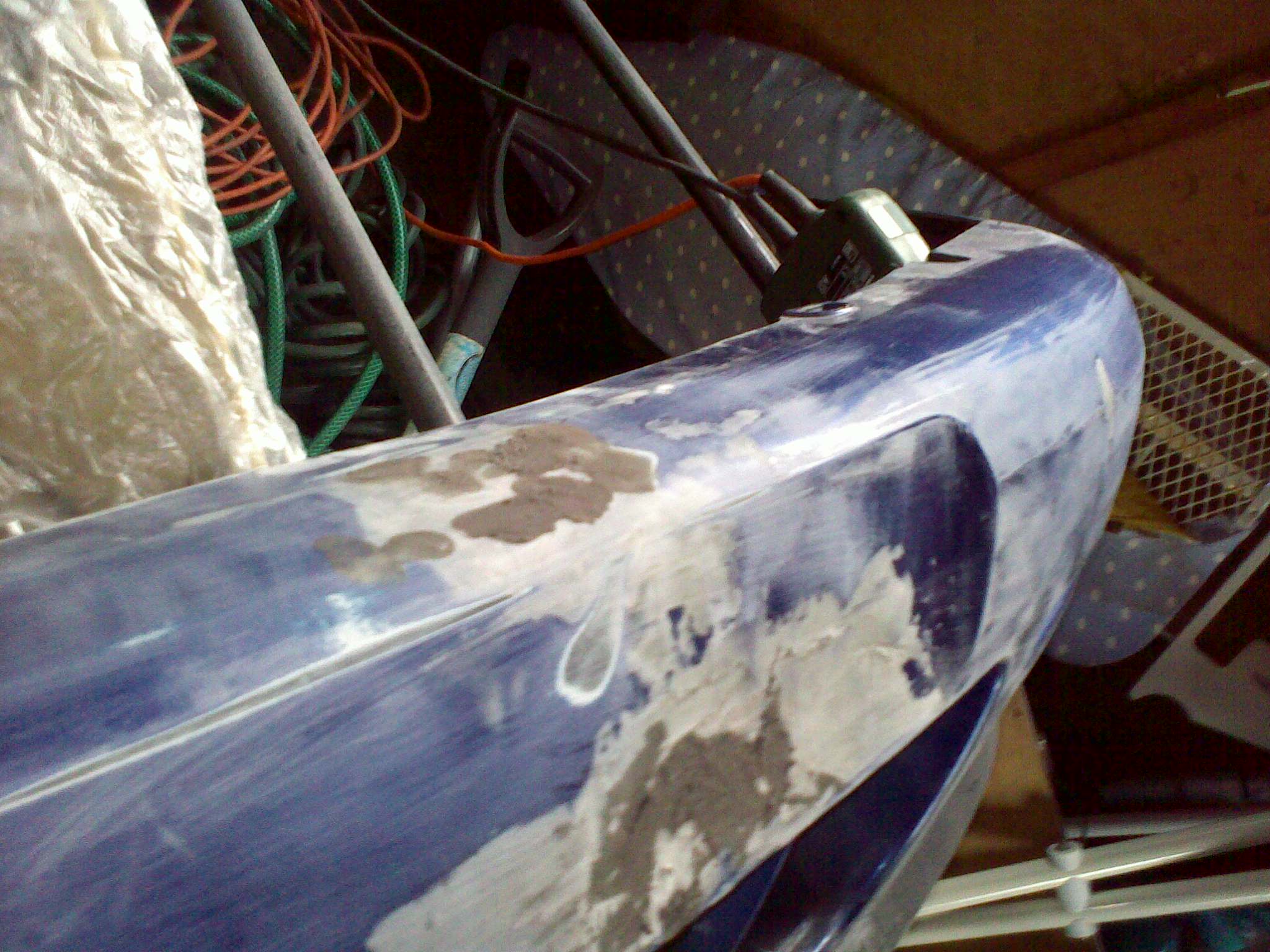

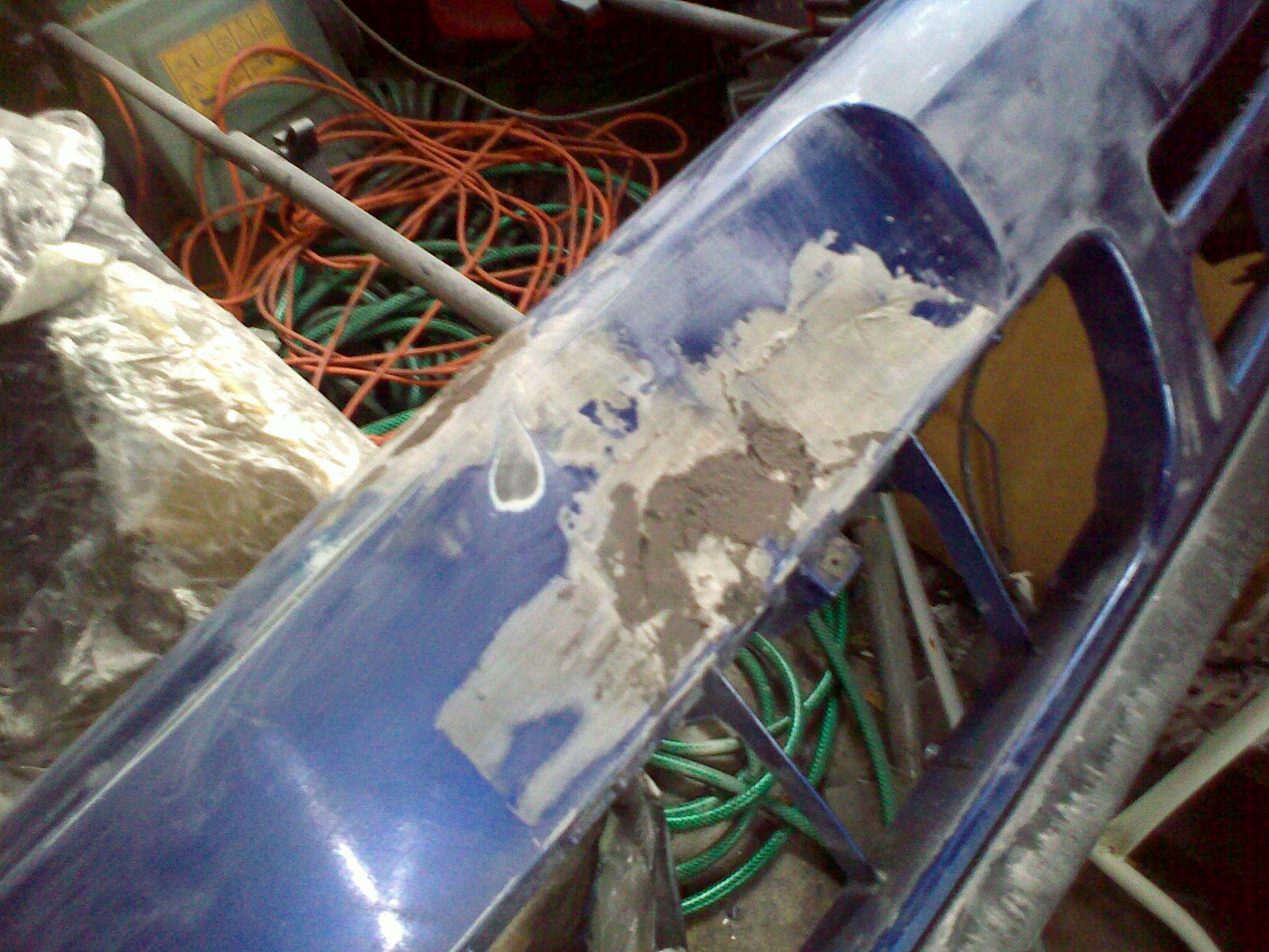

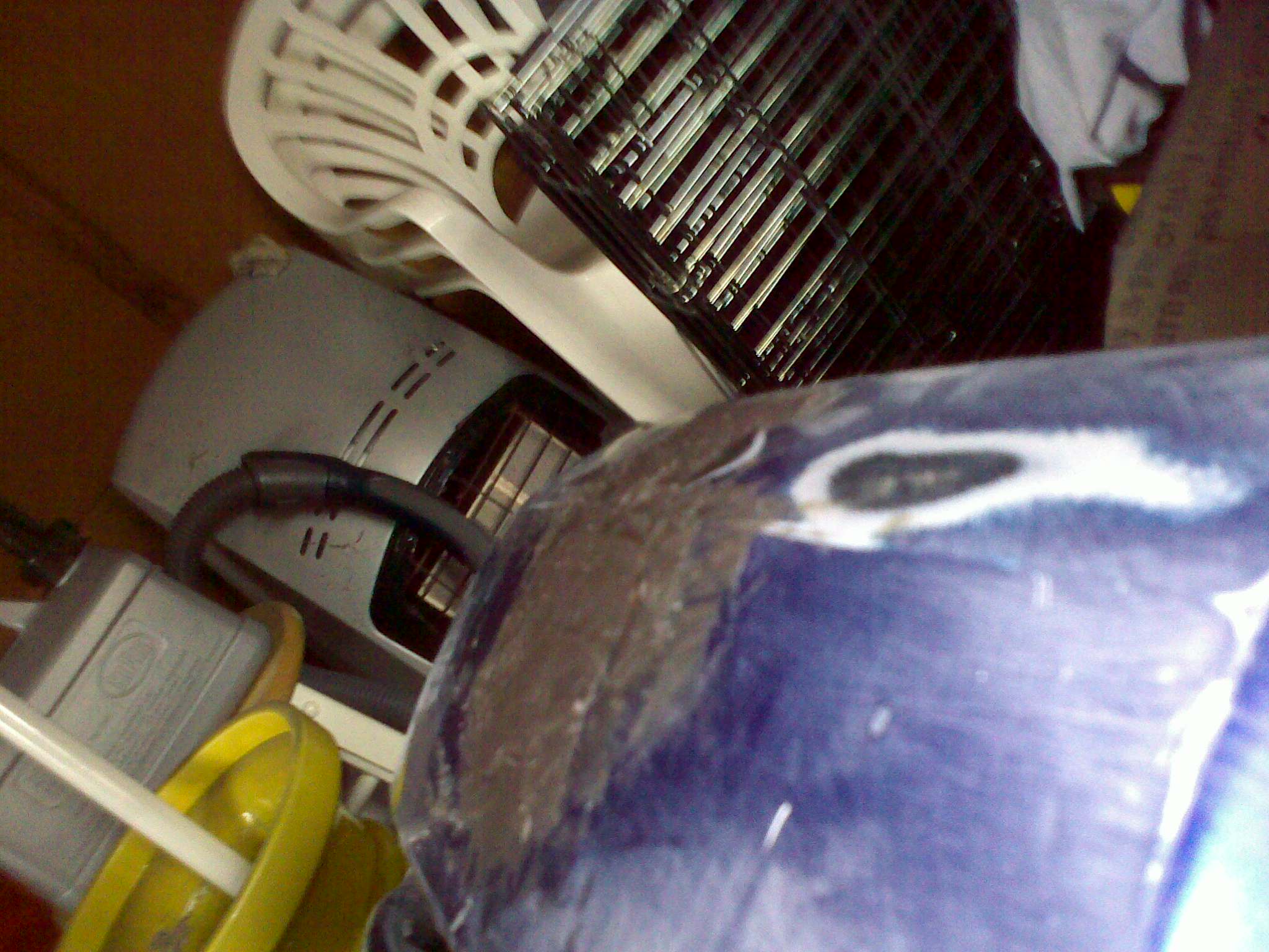

Started work on the bumper about a week ago, this is the progress I've made
The plastic wouldn't budge using heat so took the Dremel out and cut away all the bad parts

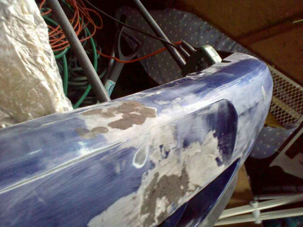

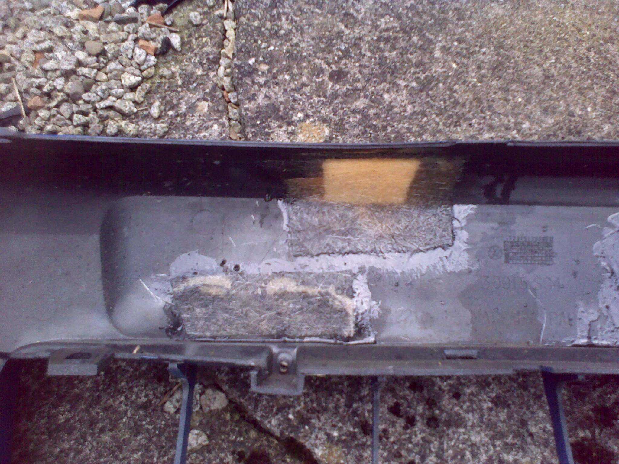

Then i sealed the back of the cut outs using Fibreglass
Then i used bumper filler and remoulded the shape
Its yet to be prepped for painting but should be fitted in the next week or so

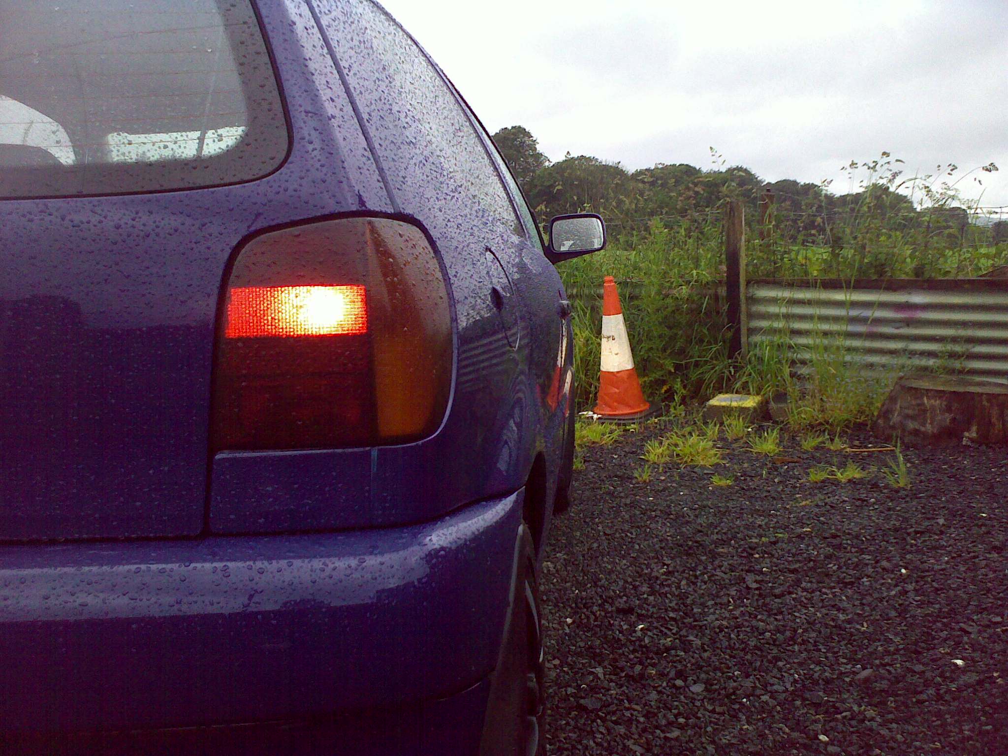

Fitted the Fly Eyes kit to the rear lights

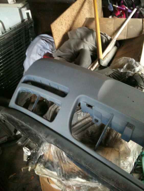

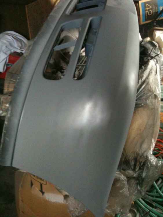

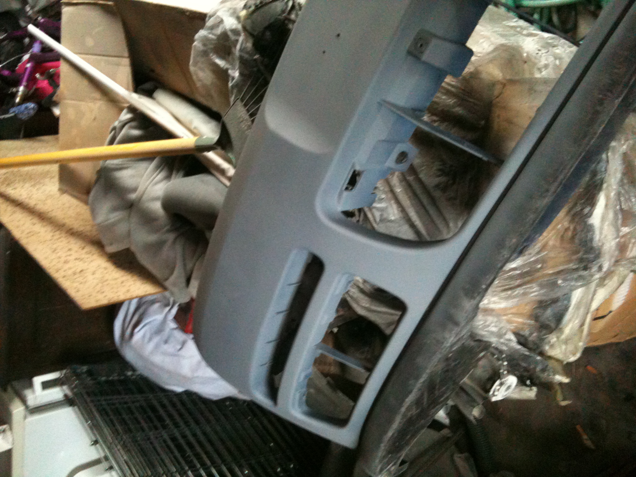

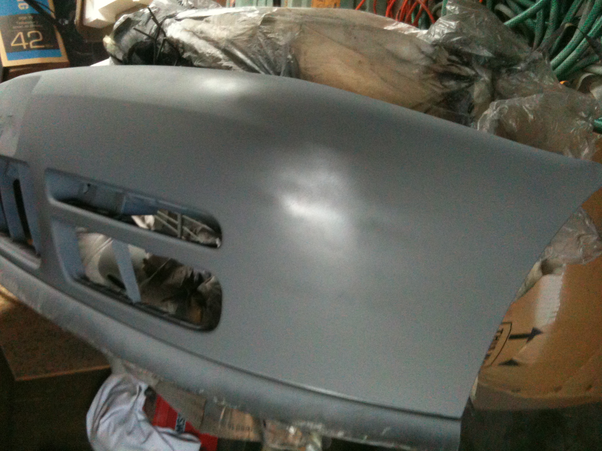

So after a few days of rubbing, filling and painting the bumper is starting to get there

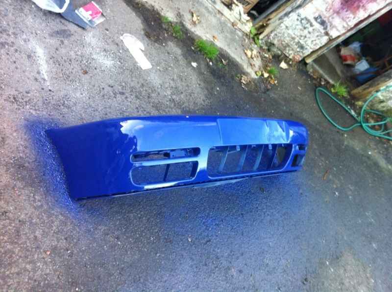

and after a few days i finally got it painted :D
Next is the fitting and the splitter
