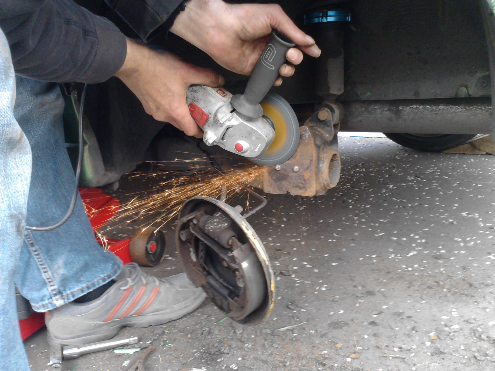

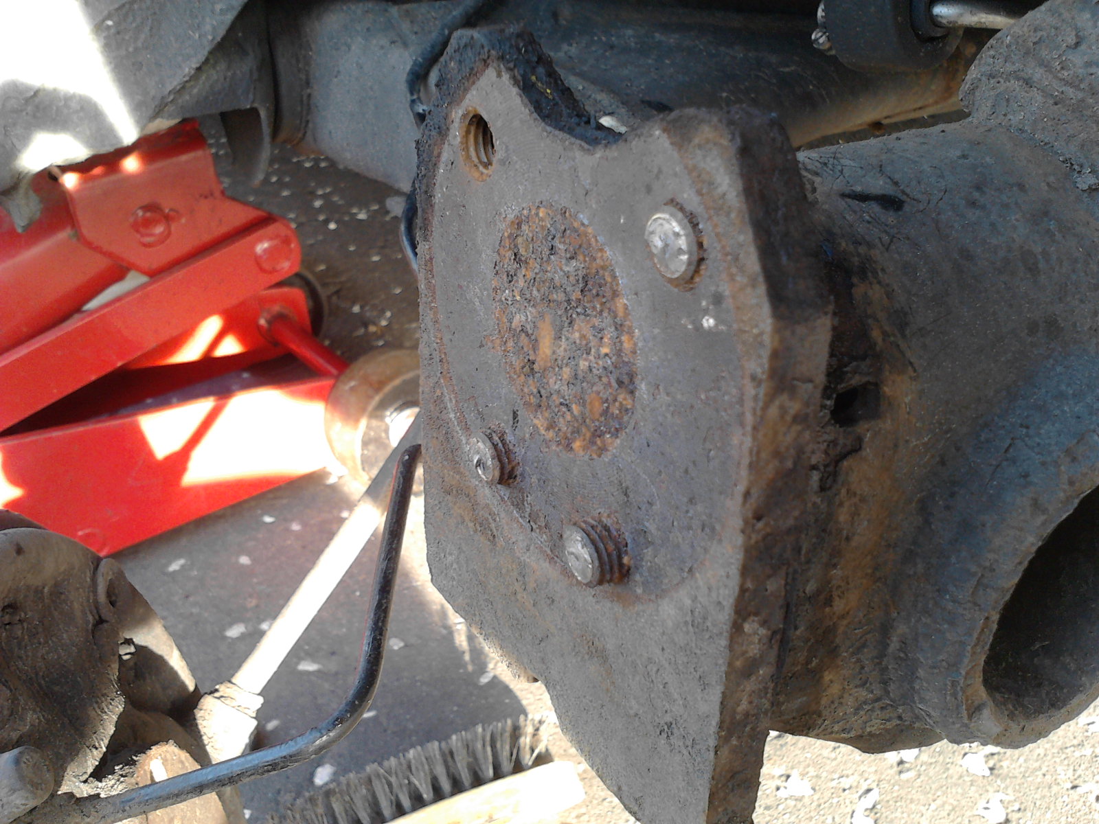

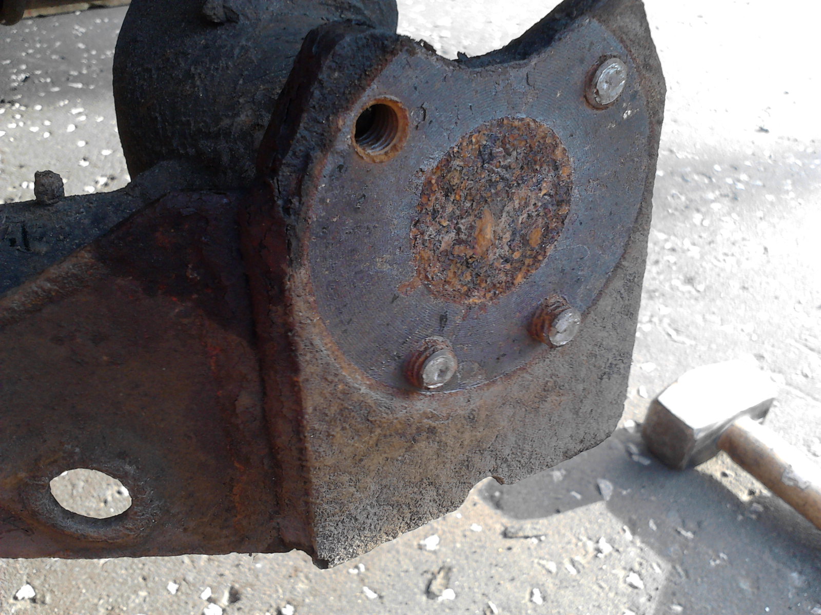

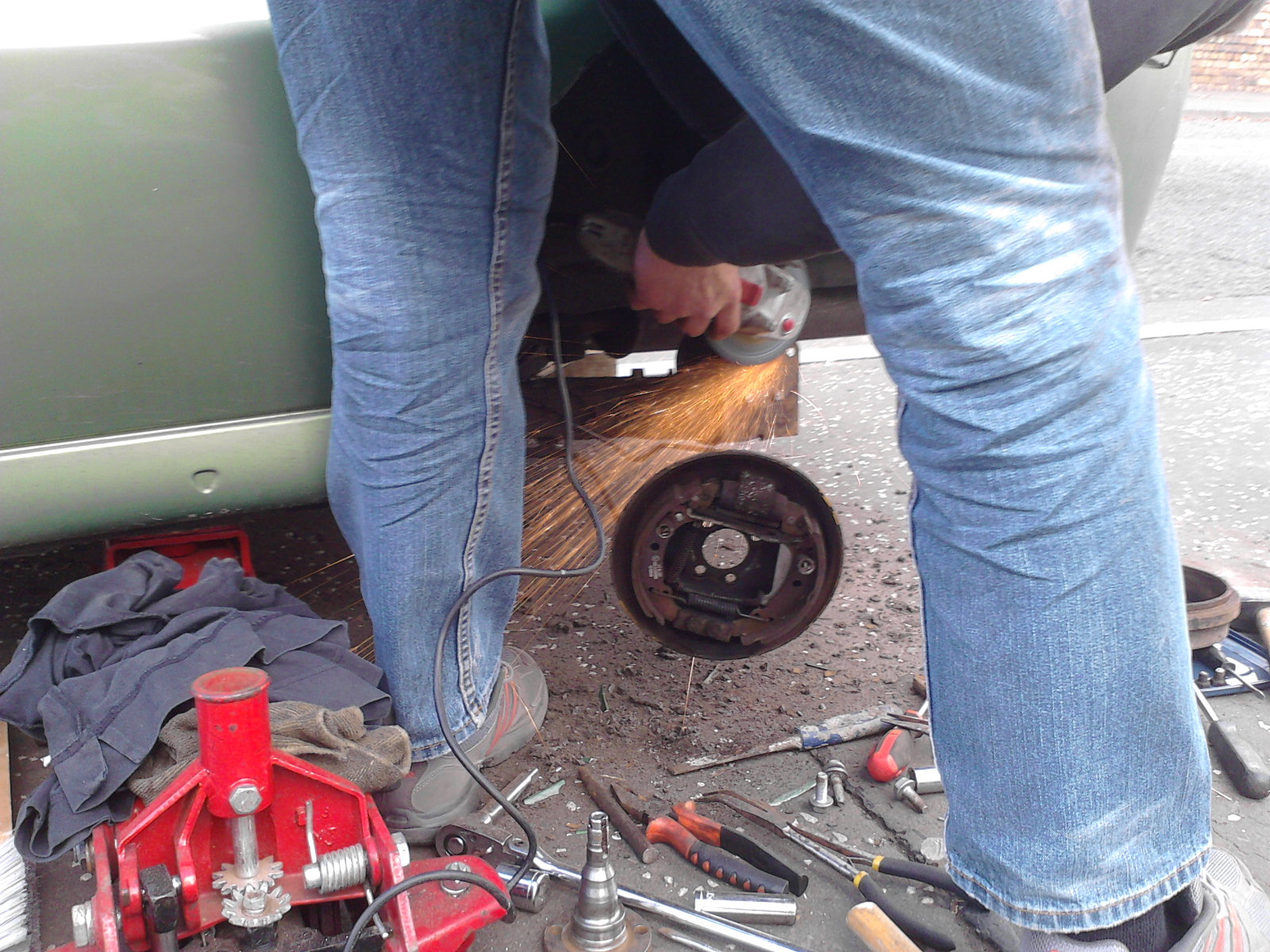

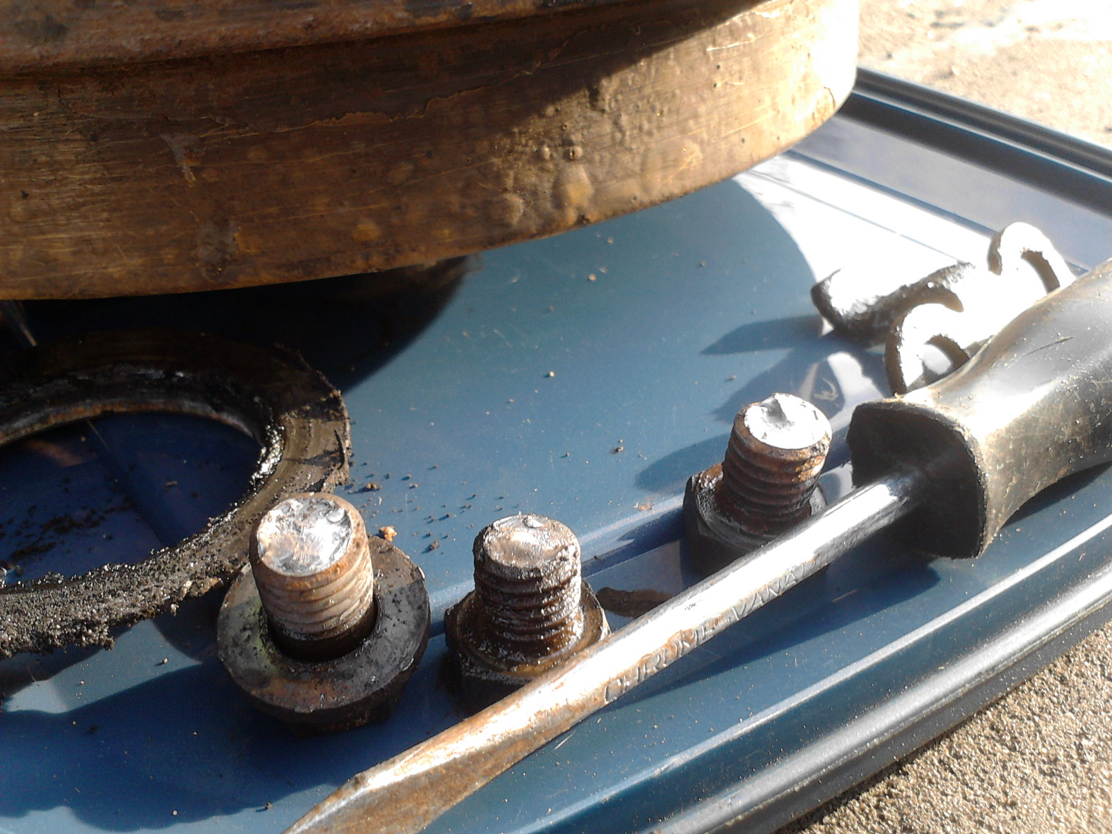

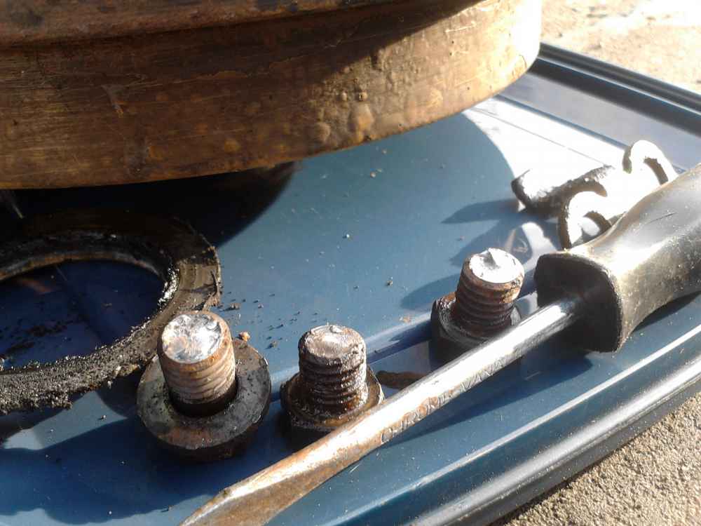

why are you grinding those rounded bolts off?! 100000times easier to weld a nut to them! espesh with that much thread left :/
never thought of it man plus i think this is the safest option. Re-drillin em 1st and then re-treadin em. Some effort i know but thats just me lol

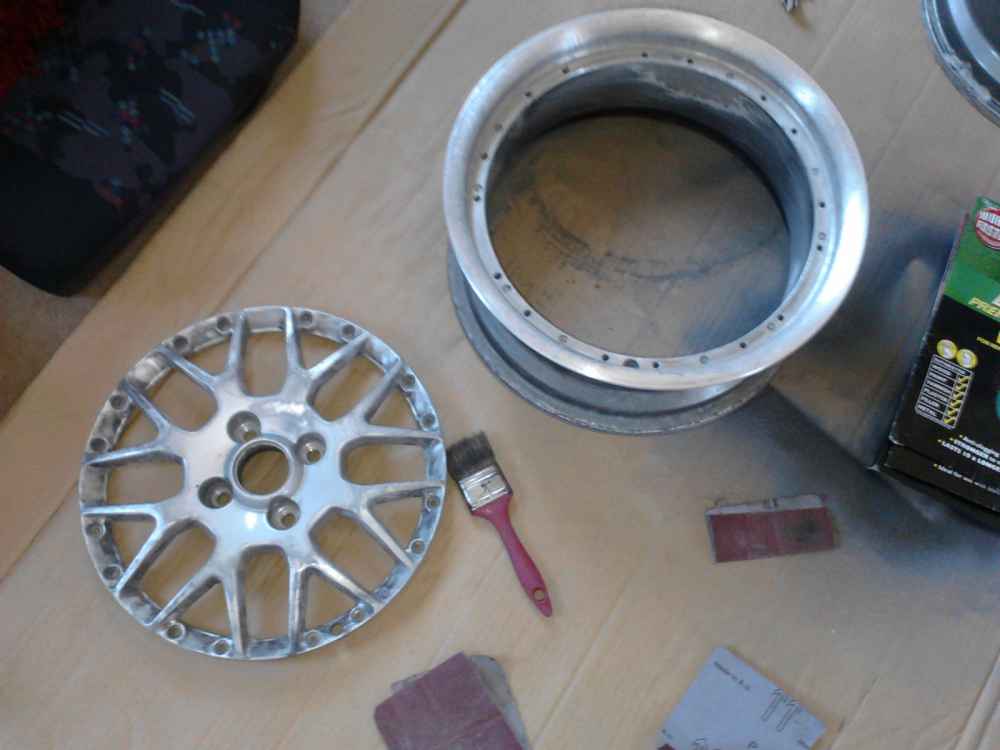

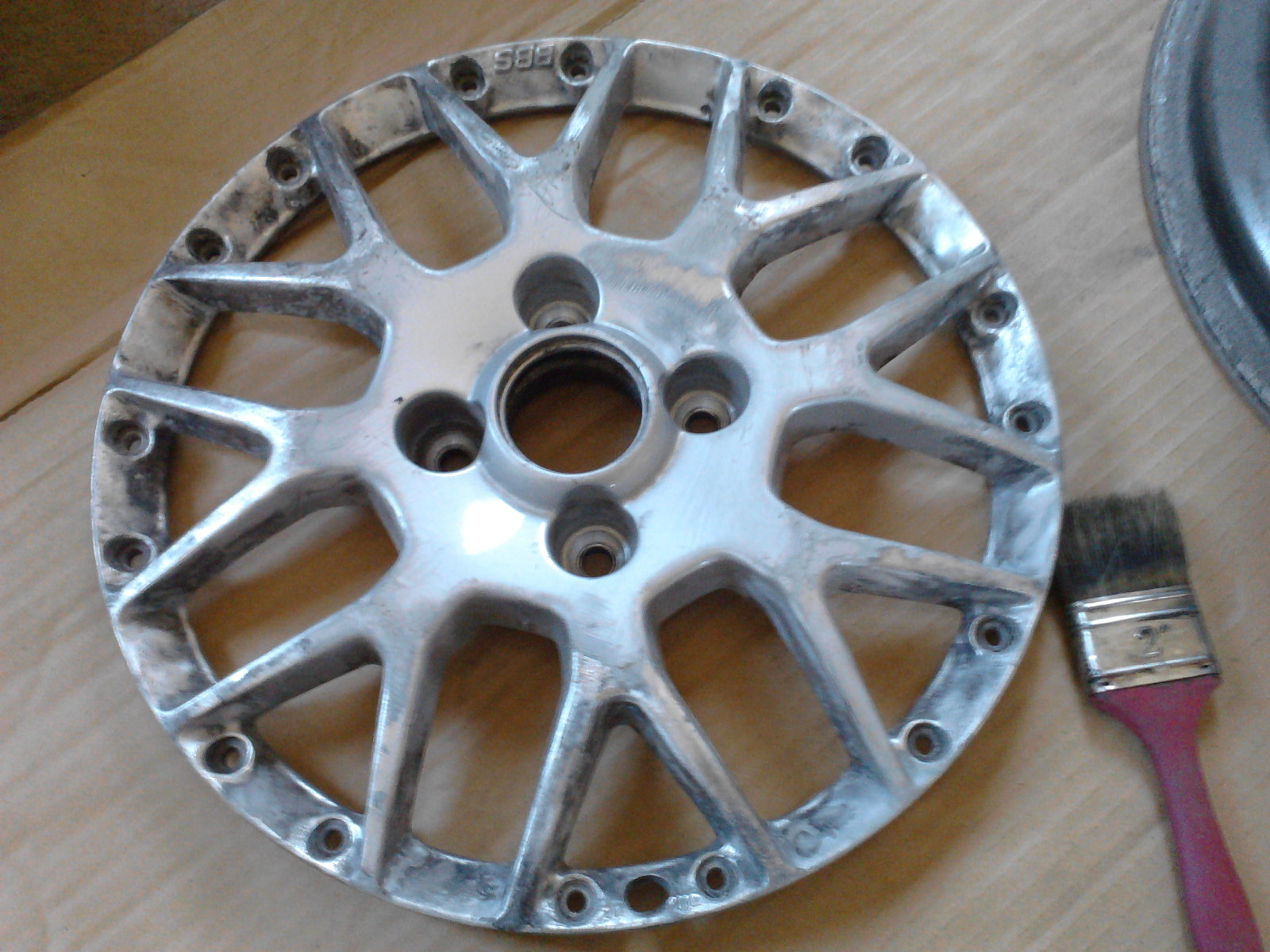

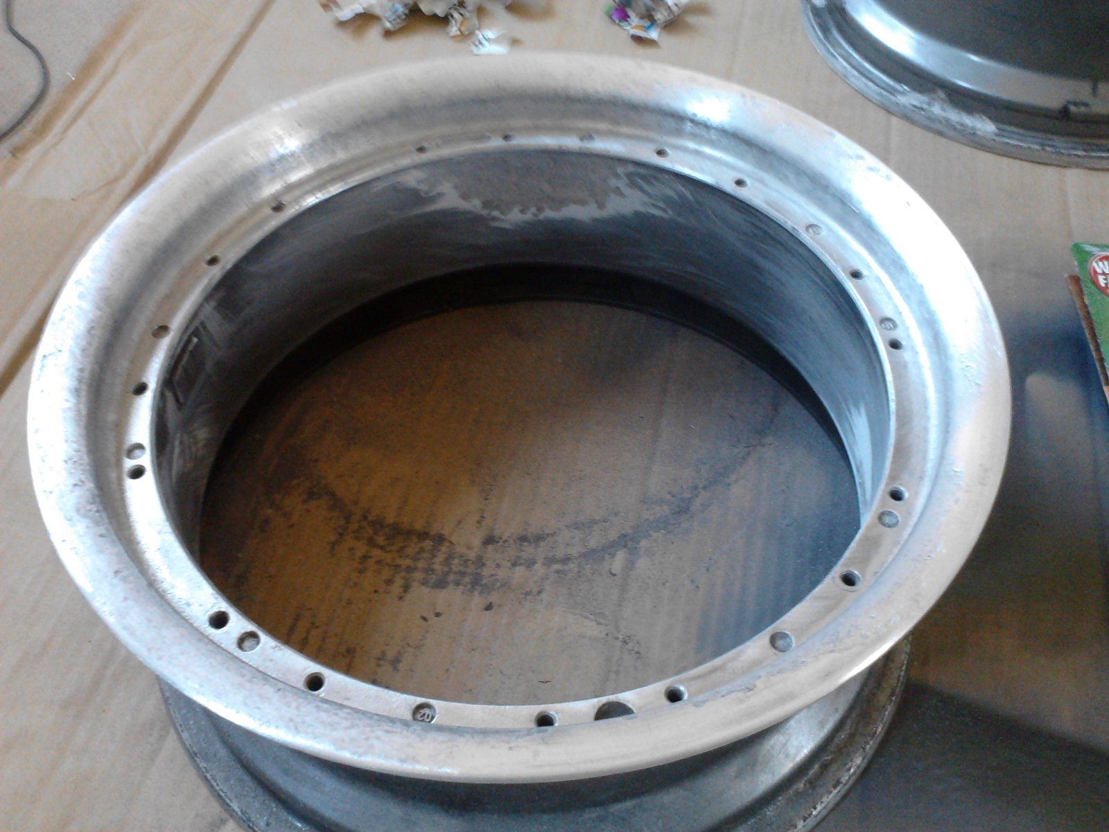

I ve got these as my 3rd set and tbh am strugglin here. Tried to refurb em myself and as the outer rim is easily done, the inner part is just a nitemare coz of the structure of it. Are there any acid-alike liquids i could use to get rid of the paint and dirt 2 prepare for primerin? And i really would need sth stronger than nitromorse as i ve tried that and its shite .....

Truckwash should work tbh! leave them to soak in it and it should strip the paint! Failing that, take them to a powdercoaters and ask for the to acid dip your wheels :)
Rite. Is this the name of it, 'truckwash' ? And, possibly funny question, how do i shotblast em? Can i do it myself???

i ve done some research and am thinkin of gettin the whole sandblastin kit, they're not that dear it turns out (i thought they were lol)
Gonna try those liquidish thingies 1st tho ;)
