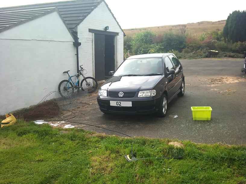

My 02 Plate 6N2 TDi Black
Not a lot to see but thought I would start a thread, as you never know what the future may bring ;)
Most of my cares have lapped the 'ring and done trackdays or hillclimbs / sprints but no current plans for "Das Frugal Wagan" but never say never! The BMw 525TDS towcar did a Prescott hillclimb when the racecar was broken.... in 1min and a few hundreths if anybody cares :p
I'm the 3rd owner of the car.
1st owner clocked up lots of motorway miles between various offices.
2nd Owner is my mate - 1st owner living just round the corner, he bought it 3 years ago with 100K on the clock and did 10K in that time.
Over the time he had it it was flawless until the last few months, then it had a new headlight, front and rear pads and disks, new backbox, new front arms, cambelt done, and has some issues with locks/central locking (only passenger side works)
Car is the 3-banger TDi, bought it to do good MPG (The BMW was doing about 32MPG and I no longer needed to tow a racecar with it). 2000miles in and I'm averaging above 50MPG often late so often "pushing on".

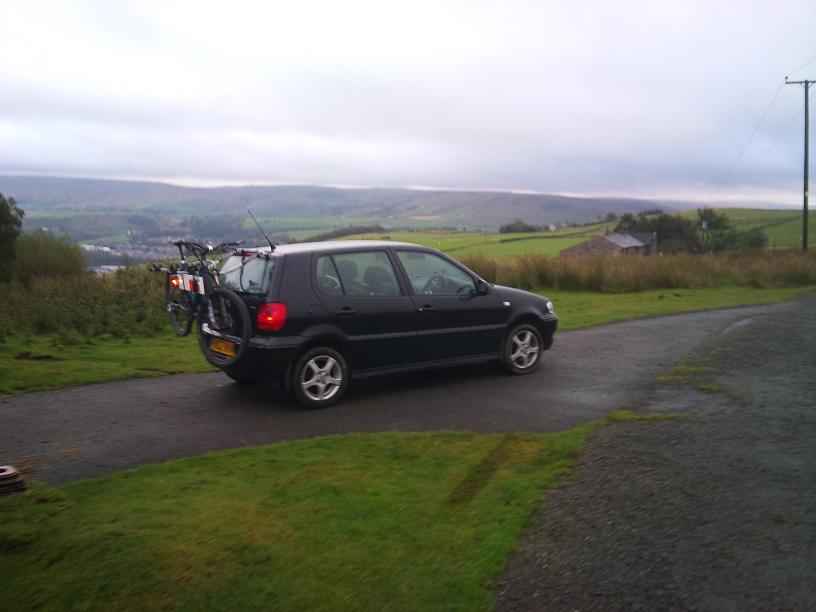

I do a fair amount of mountain biking and its a little small for that, but the Thule bike-rack sits well and will take 3 bikes. I've hidden the lighting board plug in the boot.

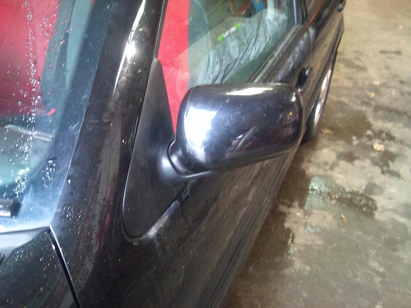

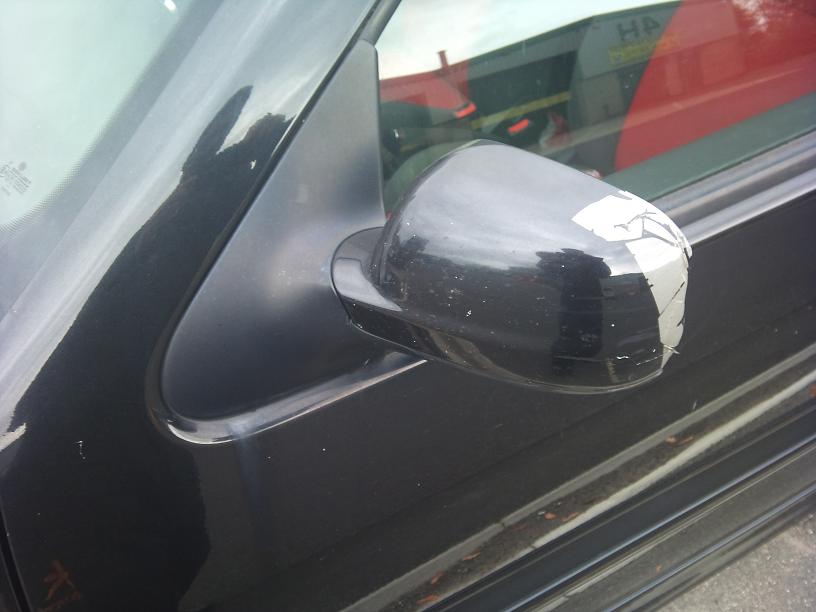

Since getting the car I have swapped the broken passenger side wing mirror for a new one, and downgraded to a 6N wingmirror - I actually quite like the larger mirror (did I mention I'm not 20-odd like most on here seem to be) and have also bought a drivers side one to match.

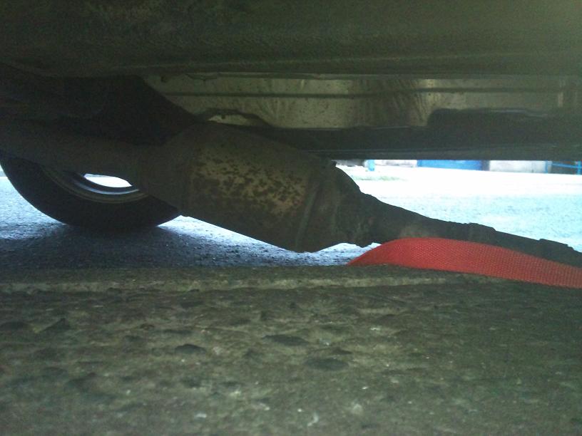

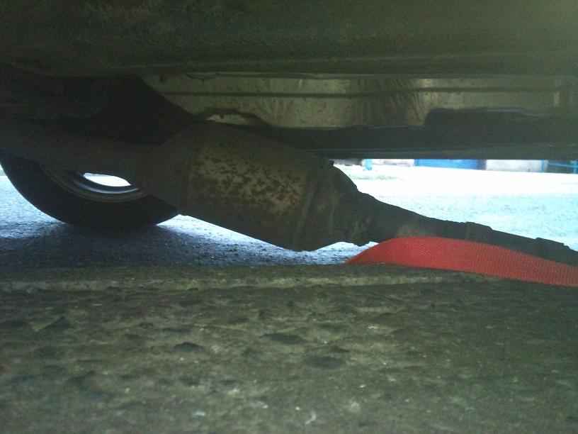

The centre section fell apart and fell off, so thats been temp welded up and the car is booked in for a full exhaust in a month, will be 50mm bore pipe, straight through, no boxes till the backbox - should help with freeing up some spool and torque. I'll probably get a remap too (for MPG) having a look round the Jabbasport one is favourite at the moment _ I know they will do a proper job of a remap not just throw some extra fuel in and hope.
The car inst as "chuckable" as I had hoped for a small car, so will be checking the various bushes and replacing as required, as well as looking at the suspension. My favoured brand of BC Racing Coilovers only do kits for the 9N, not the 6N2 so will have to see what my options are.

nicely angled cat lol

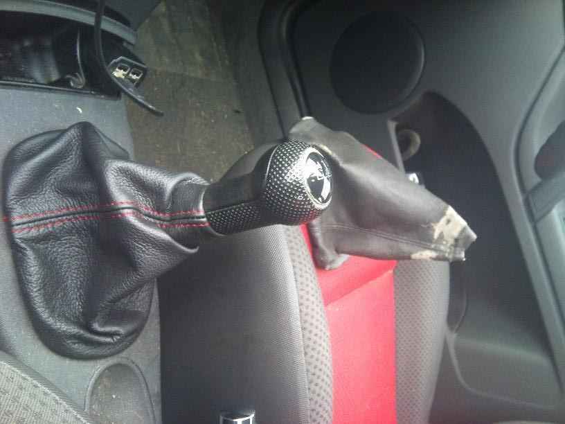

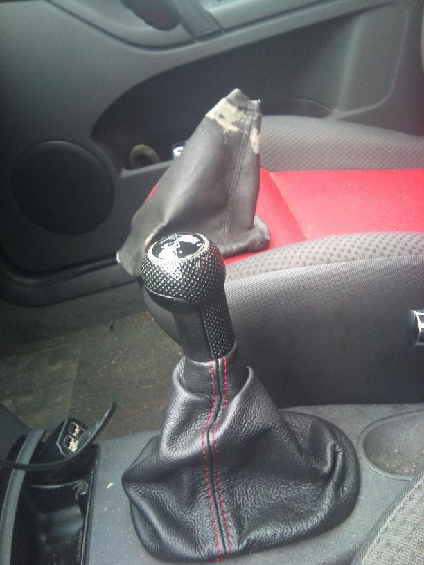

Thought I'd do some tidying up of the interior too, the gear gaitor was the only part showing wear, so has been replaced.post-73620-1319714652_thumb.jpg

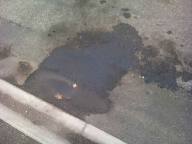

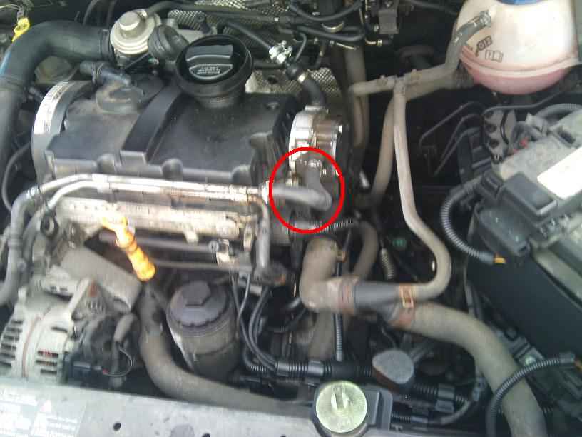

Well .. MPG on that tank was low ....
coming to work this morning the fuel gauge seemed very low to what I was expecting, and it had taken more than the usual half-a-second to start.
I filled up and carried on to work, when I got to the car park I thought I would look for a fuel leak, at this point maybe with the extra pressure the pipe must have split some more as it started pouring out from under the car.
Replaced the hose, 2 min job, must have lost 10L of fuel on the way too work, would have been a fair old fire in a petrol car (and I'm glad I didn't have to go through that AGAIN!)
Some of the other pipes seem brittle too, so thats a job on the list to replace the lot with new hose, I have a roll of 8mm braided fuel hose at home somewhere.
The Pipe
The puddle of fuel

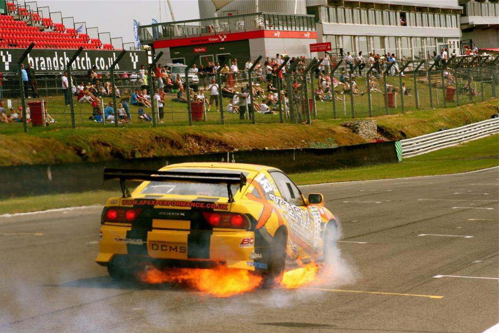

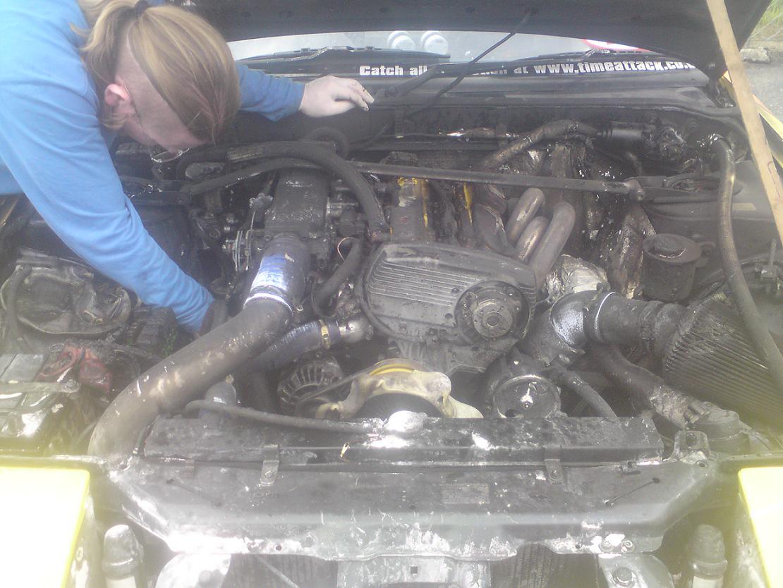

Last fuel leak I had ...
Vid - http://youtu.be/hzZZoTbf7Cc
Aftermath - with mate looking at the damage

where did you get your gaiter from mate and how much? :)

Also bet you shit yourself with that fire :| Lucky though!
