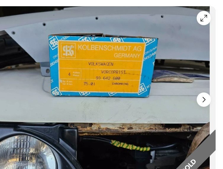

My question is will a 268/268 cam, schrick or newman be compatible with kolbenschmidt 11:1 pistons? I'm not sure if there is a height difference. As always, i acknowledge i have arrived 15y too late for the party.

It's a GT 3F hydro head. I have a set of 11:1 Kolbenschmidt pistons that i will be fitting sometime, but i need to know if the height of the piston has been increased to attain the higher compression. If it has i will need to take this into account when i order a better cam. The GT head is a flat face, so i'd guess the piston height has to be the same, but you know what they say about assumptions being the mother of all...
Are the crowns of the VAG 10:1 and the Kolby 11:1 identical?
That aside, i'm also a bit confused about the benefits/drawbacks of the 268/264 grind cams. Most posters on here have gone for a symmetrical 268/268.
What's the Kolbenschmidt part number?
Motor Service catalogue should reveal the dimensions from centre of pin to crown.
Fairly sure height will be the same and the bowl in the piston will be smaller than lower compression pistons. That's how my GK is 11:1 static CR.
The dynamic CR is lower with longer duration cam.
I have some oversize Honda 75.5mm pistons that might give 12:1 CR with the right custom conrods.

There you go, the seller is probably known to the forum.

93642600 KOLBENSCHMIDT Engine piston 75.01 mm | AUTODOC price and reviews
says the bowl is 16.27mm deep.
and compression height 42.87mm.
Valve cutout 2.12mm
And that's the same as the GK piston compression height. For a Mahle it's .05mm less.
So the valve can go a gnat's whisker deeper. Gasket tolerance isn't even that accurate.
Using 052107065AK says it's for the GK.
030107065P for 3F has same compression height but wider bowl 13mm deep.
