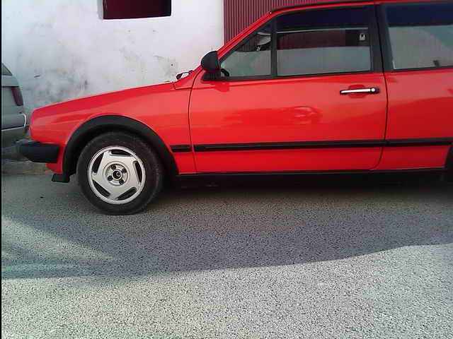

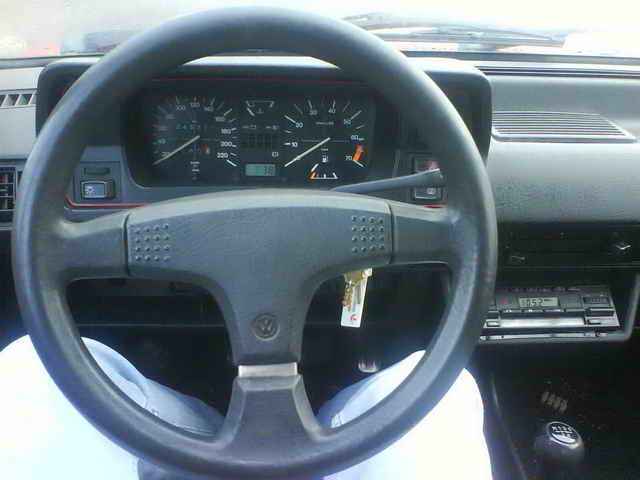

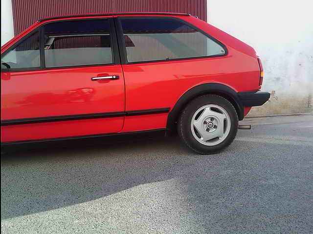

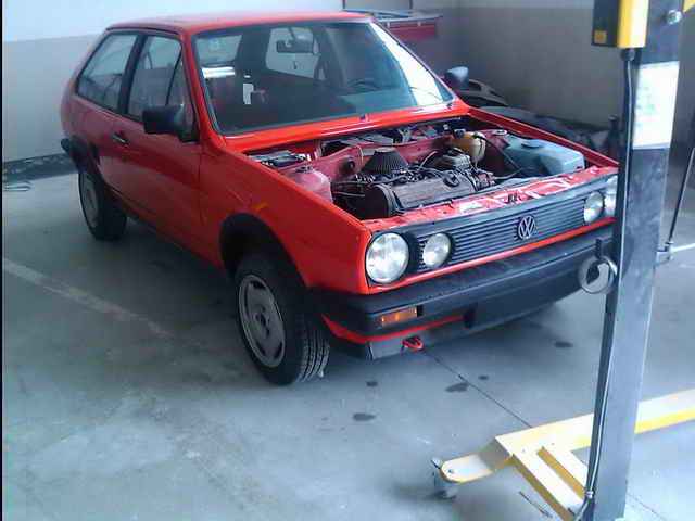

Welcome to the club, looks like a right minter you've got here!
first mk2 gt I've seen, its mint
IIRC the coupe S was branded the GT on the continent. Looks nice
That looks spotless. plus with yours being left hand drive you have a brake servo.. I'm used to being without, but i must admit I'm quite envious 8-) bring on some higher resolution pictures !

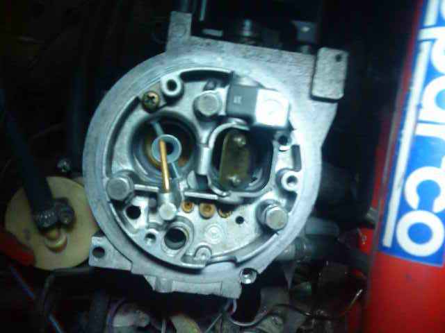

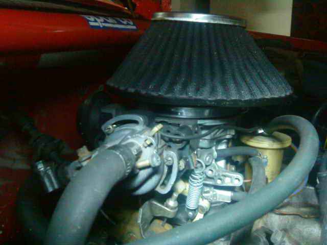

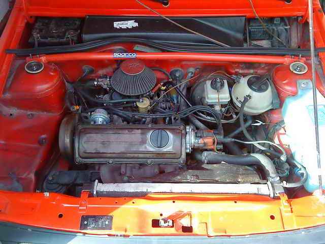

Looks nice that! I'm guessing thats a HK lump? The old solid lift head engines are meant to be very nippy for what they are, compared to their hydro head counterparts!
Thanks for the comments :-)

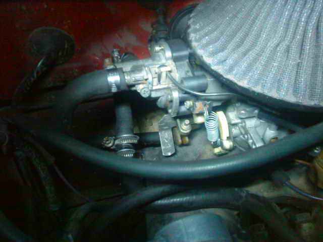

The car has the GK engine and i made some tweaks on the 2E3 carb (spring on the second stage because with this K&N filter beacuse there is no vacum enough to open it, venturis slightly opened and some rejeting), full Ta-technix 60/40 suspension, vented disks on the front and more little modds.
The car runs very good and is very quick! When it passes the 4000rpm.. comes a new life and the tacho goes crazy to the 6000rpm!

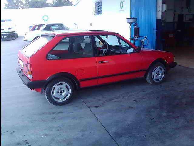

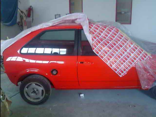

I have painted with schumacher red (from Fiat Stilo) and it looks very good.
Its a great car!
The colour doesn't look too far off Mars red which you could get the Mark2 in :-). It confused me for being Mars red anyway!
