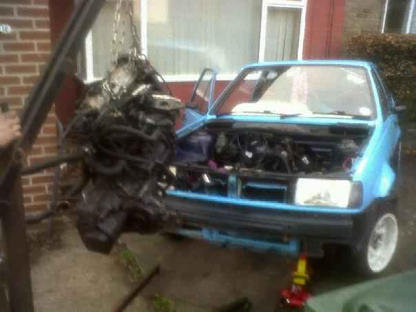

Quite happy with today's progress. Also got front mount and alternator off, gearbox split and clutch and flywheel off the old lump ready to be bolted up to the AFH. Starting to look promising :D

Had the old engine out and transferred what I needed onto the AFH.
Used my original alternator with a 6n pulley, seems to be more or less in line and turns the alt no problem when I turn the crank, but I guess time will tell... :/
Also swapped the mk3 flywheel and clutch over then mounted the gearbox. Received my 94 starter motor today thanks to Ray meaning its all ready to go in the bay now!
