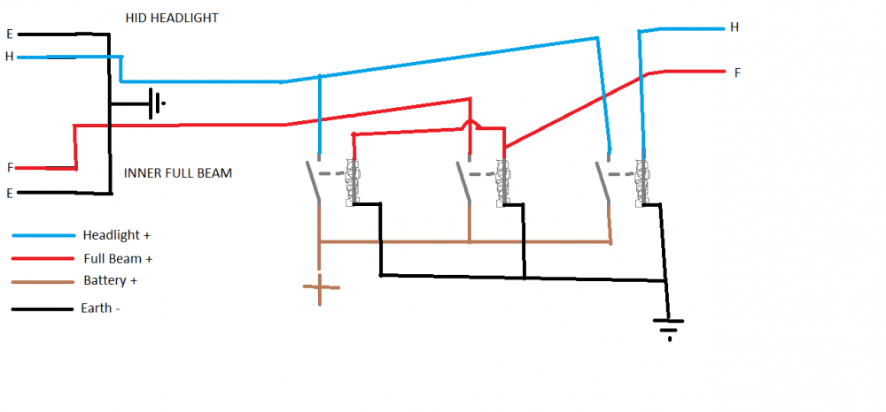

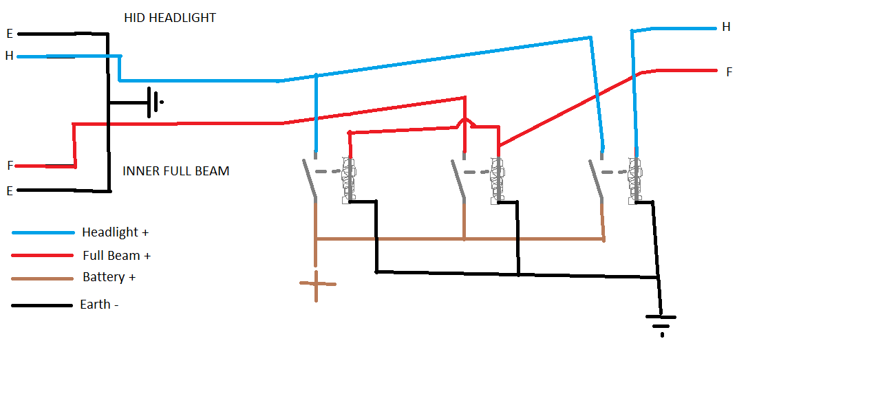

I will be ordering some bi-xenon bulbs when i get payed next, as for the wiring i am going to make a uprated headlight loom to run the hid balasts as i dont think the standard loom is going to be man enough, i was going to incorporate a relay to activate the main beam again with the full beam
See the atachment of the loom i have designed

You don't need the third relay in the diagram DanIOW, you can bridge the output from the high beam output to the switch side of the lie beam relay. Because of the working I'd a relay there will be B2B o issues in doing it this way and you save yourself some wire and £4 for the relay
but wouldnt this make the full beam come on with the main beam
Nope due to the way a relay works

Hight beam output with a link to the low beam input and you are away
