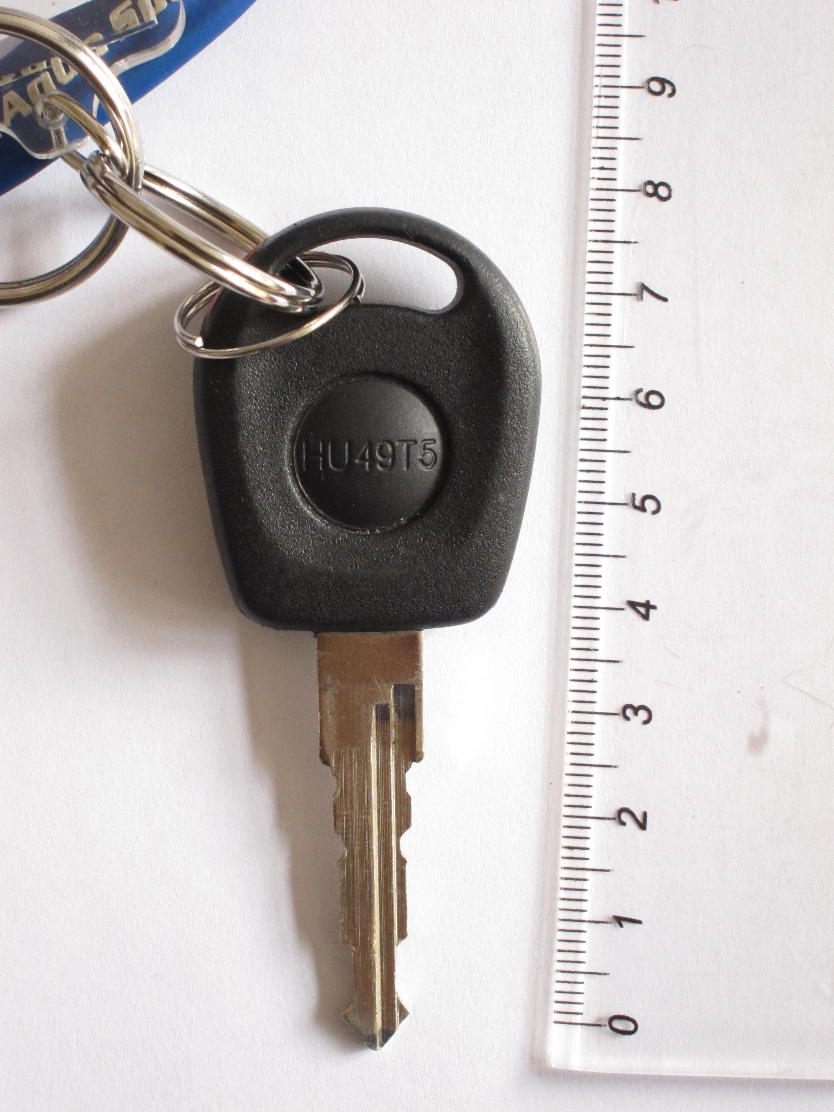

Has there been any definitive answer to the best / cheapest place to get one of these damn annoying pricey keys cut. Mine got a RED dot - which I assume to be a transponder.
Now it came with no spare which makes me edgy, so I'm looking to get a spare cut , local key cutter quotes 50-60 quid.
For a car 17years old !!
We would really like a key each, rather than cut'n'pasting chips about the place.

the bloke in alton high street did my key (no transponder) for free! he charges 20 pound for ones with transponders. and normally 5 quid for standard keys but i guess my luck was in that day.
Thats all i can help you with, sorry. that being said i know someone who bought a new key for a mk5 golf and all they did was send pictures in to a website and they got a key cut FROM PICTURES :S for £25 with transponder. (not sure how that even works personally but hey!) ill try find out this website for you

Google hinkleys.
They can cut any key from a picture and provide you with the key number making it very easy to program a new chip at home if you have VAGCOM.

VAGCOM is a fdiagnostic interface that can read error codes reset certain modules and code new chips for the immobiliser. You would deffinatly use it more then once as it does many things. You would need a laptop though. You can get them from eBay for around a tenner delivered.
Hinklys charge iirc 8.50 for a cut key from a digital picture and you don't have to send them the key. Plus they give you the key number which you then use with VAGCOM to get into your immobiliser and program a new chip.
OR... You could glue your existing chip to the sensor ring and get the new key blade cut at a local store, but this means there is no immobiliser.
VAGCOM is a fdiagnostic interface that can read error codes reset certain modules and code new chips for the immobiliser. You would defiantly use it more then once as it does many things. You would need a laptop though. You can get them from eBay for around a tenner delivered.

To program a new immobiliser chip (a blank one should come with the new key), you would need the key ode (which you will get from Hinkleys When you order your new key) this code allows you to acces the immobiliser menu and you then have to insert your new key into the ignition and the immobiliser will do its thing and the key will now work with your car. Detailed instructions can be found on Ross-tech's website, ross-tech are the people who made the VAGCOM program and also made the original cables/interfaces, the one most of us use are a copied version of these.

The key number is the special number provided from vw (was printed on the sales receipt for the car and stamped into a metal tab on the original keys) this number is needed to gain entry Into the immobiliser system via VAGCOM. If the key cutting place cannot give you this number it makes this whole process a lot more difficult.
From what they have told me, once you send them a high quality picture of the key blade, they have software that reads this and tranlsate this into numbers, then they're machinery will then cut a new key to these numbers, they then also provide a copy of this to the customer.
The link to the guide on Ross-techs site will make sense once you have the program up and running in front of you.
