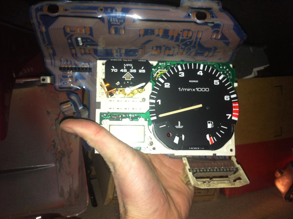

had a look at the gauges, didnt get to my pc to up a photo. they have a 2 pin plug on the back and a vacuum hose connector. they unscrew from the main bit aswell so its a piece on its own.
So the vaccum hose goes to the clocks? Must be different to the polo clocks then as the sensor for vacuum is in line with the dizzy vacuum hose with a couple of wires plugged in which i assume then go to the clocks. Wonder what the plug is for, the MFA stalk?

It says in the description: 'Ready To Mount On To Your Own Speedo Cluster' It looks like what I have on the back of my clocks, I thought there was a mechanical connection to the gauge but I guess the gauge is electrical and just happens to have the sender bolted to the back of it.

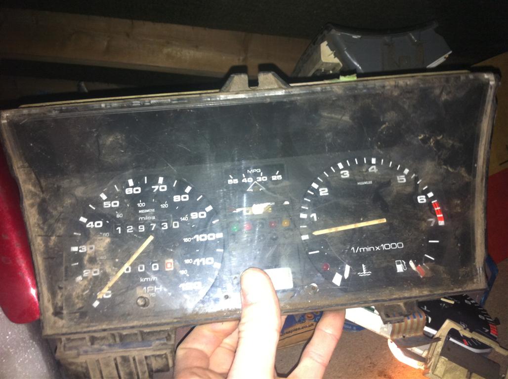

I've got a stack of clocks with MPG gauges on from sciroccos- £10 each plus postage. also have a stack of mk2 golf GTI dials with MFAs for the same price. id love to see if you can wire these to fit polos as id make a fortune

here they are, ones in a set of clocks - 1 was saved from a set which had its odometer donated.
