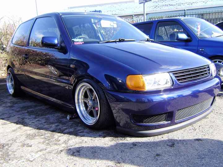

Am a custom bodyman and do jobs like this every day I done many customs bumpers etc the is many ways of doing the above here's a few
If you just wanta keep it a 6n with just 6n2 bumpers read the below
Cut top half of the 6n2 front bumper and then remove the metal part of the 6n bumper and trim the plastic of the 6n2 to the desired height the grined the 2 top edges of each bumper front and back then over lap the 2 bumpers then grined the edge of the over lap to a 45 degree then you can then you can ethier plastic weld it but if you don't want a plastic weld you can put counter sink screws in then fibreglass it
Then repeat the same of the back that was a quick run throw of what's involed
Edited by doyler
Thats just a hybrid bumper if I'm corect is it not?
Like so?
Like so?
Yeah that's what you will get if you do the above in my earlier comment ^^^^
Edited by doyler
Nice one. Looks really nice like that.
as above you can get a hybrid bumper made with the top half of a 6n bumper and lower 65n2 bumper
front end would need, bonnet, wings, front panel, headlights, bumper, water bottle, wiring and t2 weld in sections to attach the front panel straight so it aligns properly
rear bumper would need to be a hybrid bumper like mine
