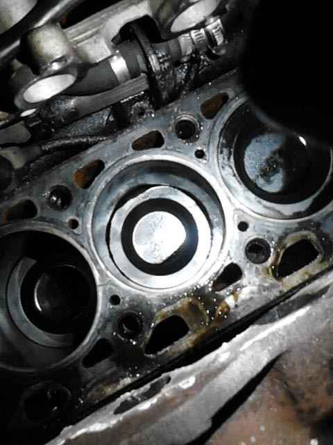

Boom!, thats how you melt a piston right there :lol: pictures not great but it looks much worse (you can see the rings)
little scoring at the top of the bores too, not sure if its ok to wack in another piston yet.
Anyone got a piston or bottom end for sale?
So hows it done that? Dodgy injector or summin?
Thats what I'm thinking :roll:

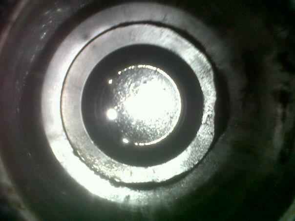

another pic
best way i think it just rig it up to fire into a bucket and see the spray patterns :)
