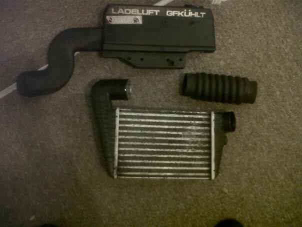

Pictures: Spotted lots of oil in the cooler when taking the head off, so I wipped that off with all the boost pipes give it a good clean inside and out
Considering it was completly black and full of grime i didnt do to well :D
