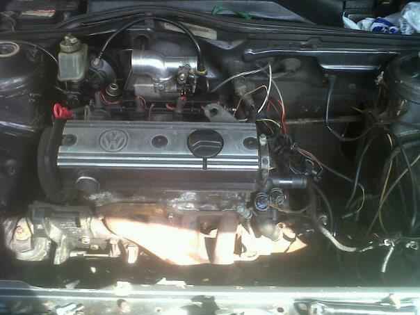

This is where i got upto yesterday.
Had trouble getting the starter motor to work properly, thought id see if it actualy worked before shoving all the inlet on and shit, turned it over and it kept sparking like crazy. 1 hour of head scratching later turns out i didnt tighten the 13mm nut enough :retard:
gave all the water pipes that came with the new engine a good wash out, as the old coolant had crispyfied inside, and swaped the thermostat out for my working one.
Today: finished work early, so got 10 litres of oil so i can do a proper flush through, then run the engine for 300ish miles then change the oil agian just to be extra safe.
Ordered in the usual gaskets bar the top part of the throttle body, gunna have to get some gasket paper and make my own for that.
See if i can get it all done today, doubt it :lol:
