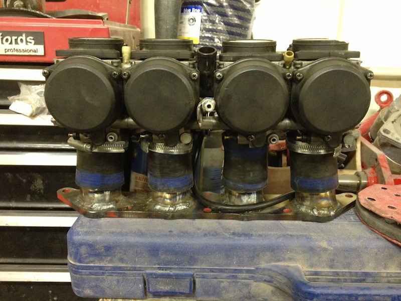

By the way the carbs are cbr600 not gsx :)
Have fun!
Yeah, for some reason I thought they were gsx. :S

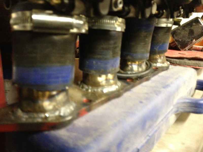

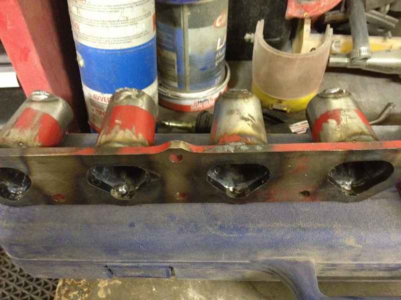

Dude the manifold aint cracked there supposed to be like that look at othee afh's :lol:

I had a proper look today, it's way to clean to be a crack anyway! :)
(I had an excuse to change it to a better, damn you.)
