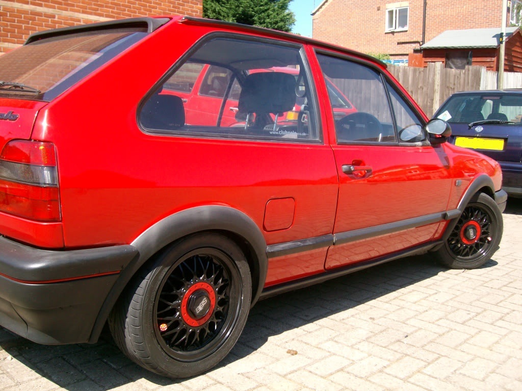

What wheels were they on mate ??
I'm almost sure they are BBS RZs, the ones with a big centre cap that hides the wheel bolts.
Sttraight spokes
? Could u post a pic plzzz :)
Thats the best picture I have at the moment, that is when i bought the car so it still has the Philj springs and shocks there.
I'm getting some new tyres put on today so I will take a couple of better pictures later today.
There ra or rms mate , you getting 195 45s put on again , does it rub on the front bud ? Or catch at all ?
you just gotta watch out with the tyres rubbing on the springs if they are a high et, and stance is out of the question with those tyres jay :(
My bad! haha yeah I put 195 45 conti sports on. I've never had issues with the front wheels, they may catch slightly in full lock in reverse but nothing to worry about!
