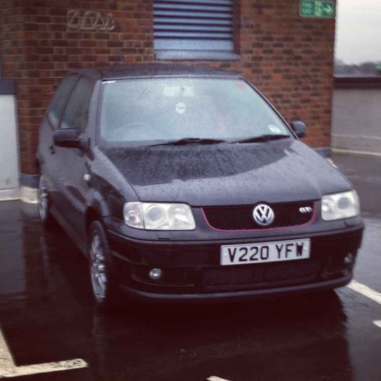

Woolley's Oem+ Summer 2012 Project (now daily)
Just got home from uni today and i went to see the GTi tucked up at my dad's
so happy with it :D just everything about it :p
here's a few pics from today
but, since there is a lack of room in the yard, I'm gonna give it a good clean tomoz 8-):thumbsup:
the engine strip down is gonna happen soon! stay tuned over the next week!
edit* we suspect is a valve problem or a stuck up oil rings as it misfires on startup and after a while, it runs fine but smokes

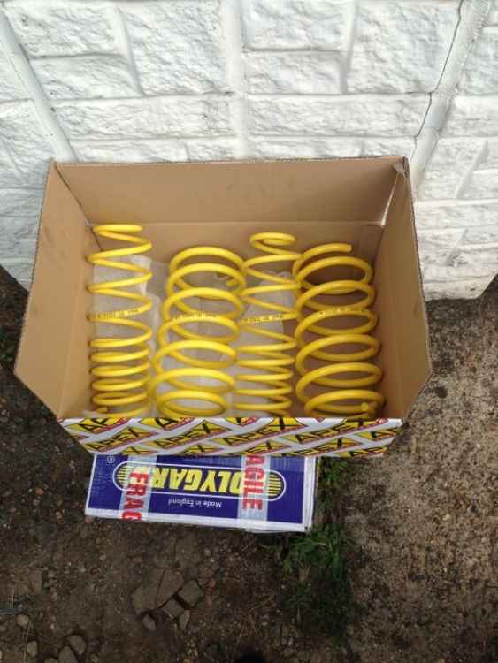

Oh btw, about the lowering, I was thinking of getting 20mm lower springs and some spacers on the back, but that is to come later :p
