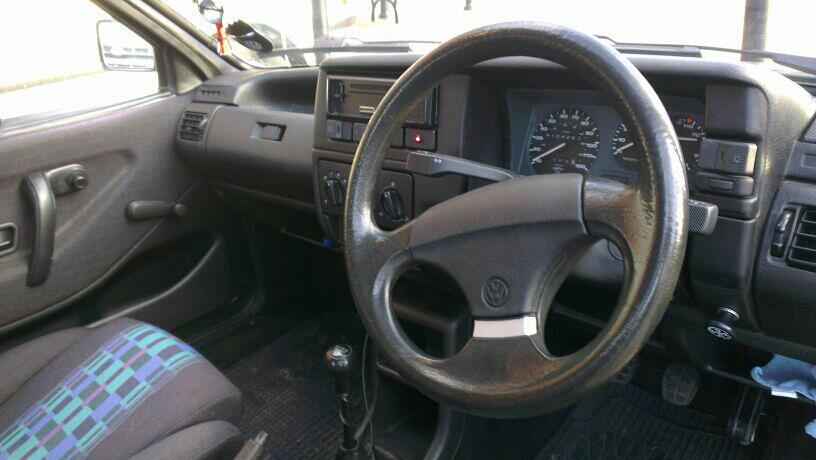

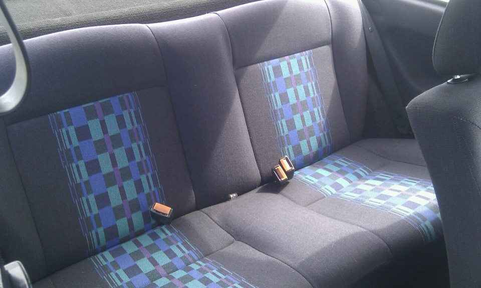

here is the g40 interior i picked up from London, and the steering wheel i found on a bread van in motor hog. i have not seen another like it, iff any one knows what model it is off reply on here please, just curious. i put in black carpet also as the grey carpet to me did not look to nice. will do until i get new carpet trimmed to fit.
Edited by dart_strife

The steering wheel i'm sure is from another MK2F but i don't know year/model.
