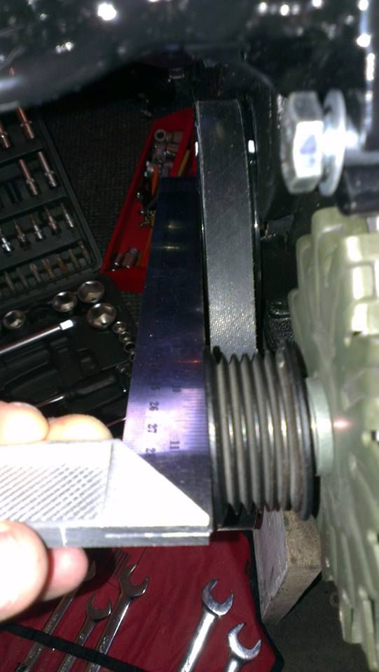

I got the alternator sorted today, I used files to get a groove in the pulley to fit the wood-ruff key.
The belt is all aligned straight and all I needed to remove was the MK2F pulley and slot the AFH pulley on, that sitting on the alternator fan.
I followed the FAQ for the AFH conversion, however I may have grinded a different part off the AFH pulley of to the FAQ, but it is a bit vague. I'm not quite sure, I figured I did it the correct way as it may have been a tight fit for the pulley on the chassis leg. Either way as the belt is ribbed and tensioned up, it should not slip off.

afhalternatorbeltonpulley_zps864c5297.jp
just lold at this
Where's the rest of it :S
You may have chopped abit to much off ;)
You've took material off the wrong side.
You take it off the other side to make it closer to alternator body for alignment to make belt run square to the pulley on crank.
Try again :)
lol the right side though ? or not ? I do have another he he, I like grinders
Try again :)
Dont you think it would be ok ?
Get a flat square edge like a decent steel rule or a bit of bar or something, hold it flush on your pulley and you'll see it's sat out further than the one on the crank, although may not be too accurate now as you've modded it: bolt your other pulley on and you'll see what I mean.
Measure the gap from the flat edge/bar to the crank pulley , then take that much off the back of the alt pulley.
:thumbsup:
The misalignment will still be there I think, so will just wear/shred belts
I get what you mean bro , makes sense , I just thought it was other way as tight fit on the chassis leg . It's like 2mm out ! So close by eye he he. I like my mutilated pulley , looks like it's floating lol . I've just dug ny spare out, you reckon I could use this one thought ?
You answered as I typed ,never mind. I'm going to and it from my rear view lol.
There we go, much better, all inline, pulley lip there.
